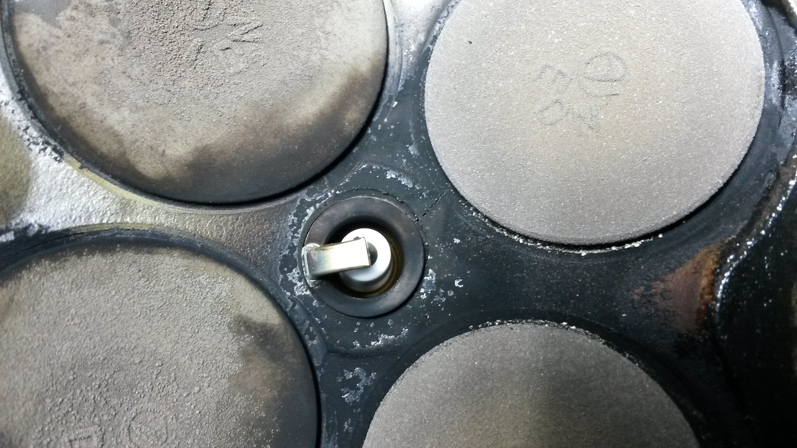

I tried to post a new thread to technical but it didn't work : Hi everyone, I got a mis fire last week and someone recommended changing the plugs so I did and it drove well for a few miles, then started missing again so when I got home (on 3) I looked at the old plugs and one was wet, kind of oily looking and then I noticed that the coolant was kind of graphite grey in colour, like pencil lead so I suspected head gasket, pulled the engine and have found that the heads both have these cracks from the spark plug hole to the valve hole... What do people think? It's more cost effective to buy a low mileage engine than to buy decent set of heads and rebuild, what would you guys do?

That been suffering det, you can see the pits in head.
Ideally want pull pistons & check ringlands etc.
If it was me I would be inclined get decent heads if find some at right price, then put in set of CP pistons & refresh bearings gaskets as needed.
You will pay fair price for used engine. Up to you really & main thing to force going full engine will be if heads not found easily/cheaply or bores/bottom end found to be not favourable.
Once done I would suggest getting fuelling checked on a dyno run or you could end up with same again unless running perfect.

Shouldn't the ecu !Removed! the timing if it's suffering from detonation?
If the det sensor is working a1 it helps but you still running lean & still get det which gives damage like in images above.
