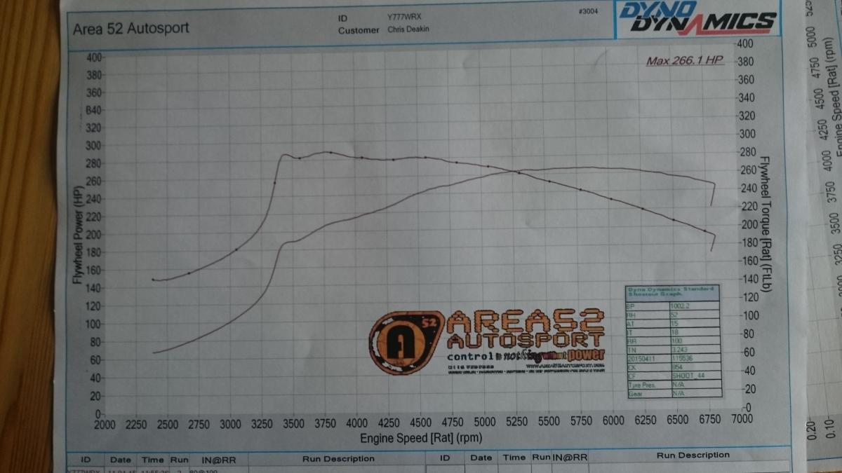

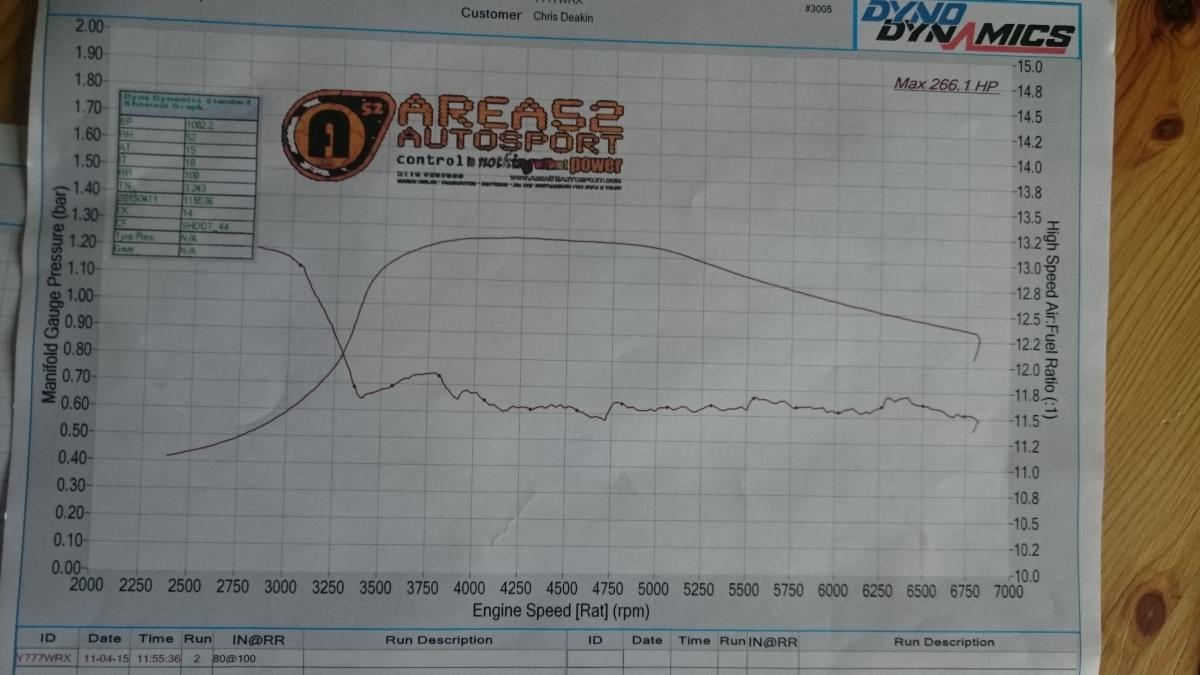

ChrisD Posted April 27, 2015 Author Report Share Posted April 27, 2015 FYI if helpful Boost, Fuel BHP and Torque Quote Link to comment Share on other sites More sharing options...
