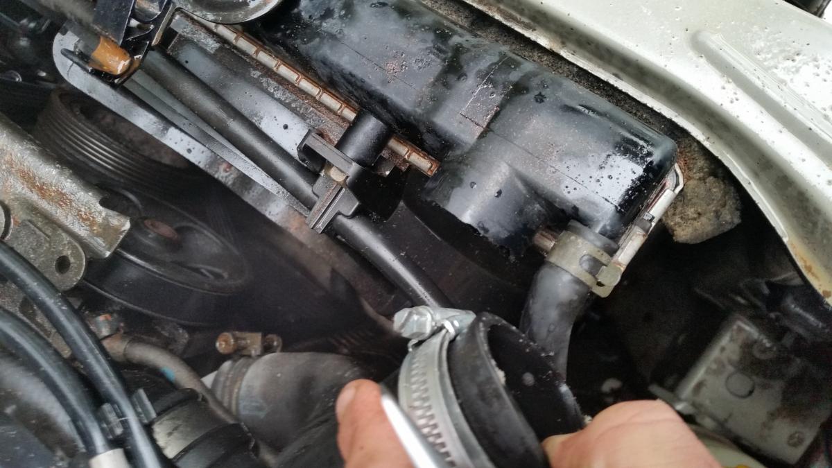

Needs a little work, it wants a new radiator. bit where the top coolant pipe connects has snapped off. But no motor factors seem to be able to get hold of one for me. What other cars could I get one off? Does it matter about turbo? Or could I have an impreza one? I know u couldn't use an auto one.. or could and just not use oil cooler..

Hi mate welcome, is yours a UK car & can you take a pic of the top of the rad ?
Mine uses a classic impreza shaped rad but it's 3 years older I know uk cars have different shaped rads but don't know when they changed them.

Best photo I have can get more if you like
post-4380-0-27992800-1431173324_thumb.jp
That's good enough mate looks like yours is a UK type rad, does it step down an inch towards the other end ?
Import car parts will have one, just give them a ring as it's easier to avoid any confusion
Cheers pal, don't think they're open till Monday but ill give them a ring then, Had a brief look on there site and can't find anything for a SF rad.. buy would there be anything else I can get one off if all else fails.

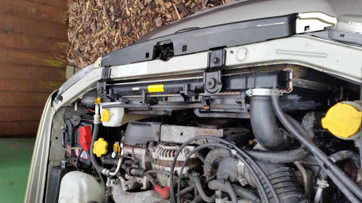

Another picture for good measure

Mine wasn't listed either but i called them and they said it was the same as a legacy/impreza of the same year, he emailed me a pic of UK type and jdm type rads so I could choose the correct one,
Where abouts are you ? Northern radiators stock them up my way I guess you'll have a similar company near you.
Thanks for your help pal.. I'm just chester Merseyside, there's a rad place by me but they only do repairs.. don't supply
No worries mate, if your stuck call import car parts Monday morning and you'll have it Tuesday if they have stock
