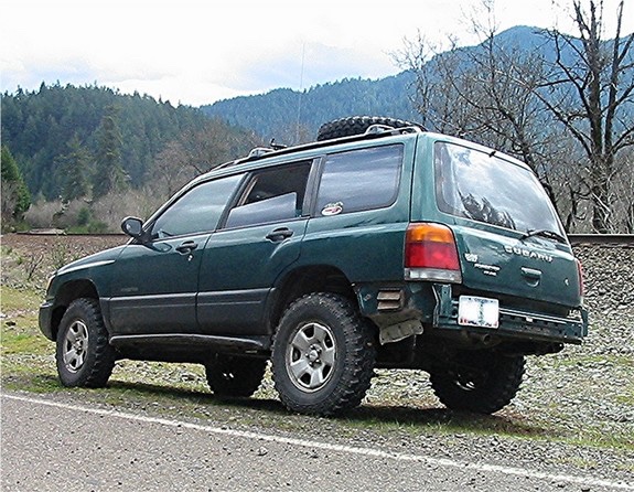

They not bad, early SF was the best as less over hang front & rear & less plastic under front of car.
A 2 inch lift makes all the difference for rougher ground, they good on the slippery stuff as the 4wd is proper awd with viscous centrer diff while likes of the freelander has a awful cheapy viscous coupling in the rear prop & rear diff is geared higher than front so it 2wd most of time well most are 2wd all the time as the transmission design is so bad it rips itself to bits quite easily :-)
I've done a few fozzy lifts & 2 sump to bumper skid pans for the SG for some farmers & the likes, they seem rate them well for general rough lanes/tracks, crossing fords/streams & field work. They no landrover 90 but with slight lift & good tyre choice they will take you from city centre to a remote moorland farm in the worst weather imaginable & do so in comfort & complete warmth if you got the AWP model :-D

Lift set are done via blocks on top of strut mount & springs, blocks can be bought or custom made, springs can be had from king spring or uk company springcoil.co.uk, when lifting rear over 2" you also need reposition trailing arm link so wheel stays central to arch . Most stuff for them comes from usa or australia, you will find some stuff in poland too ...
