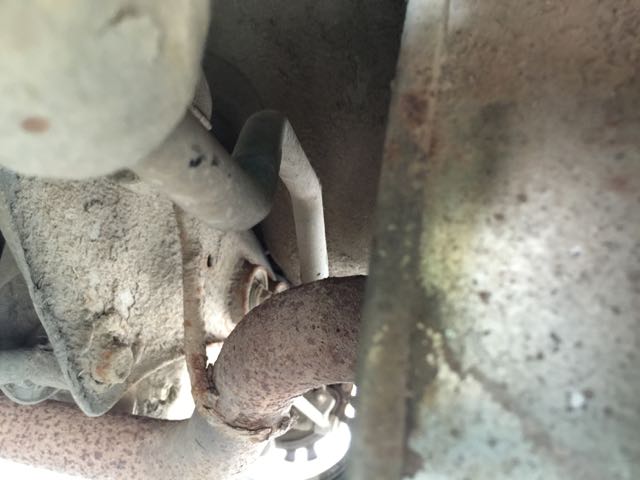

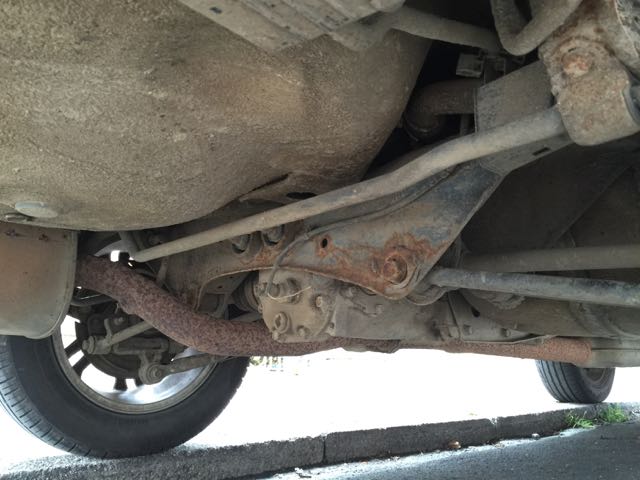

I was wondering if one of a Prodrive or Sti Impreza would be worth the upgrade

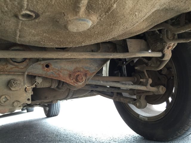

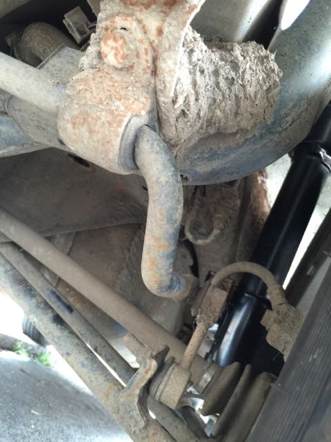

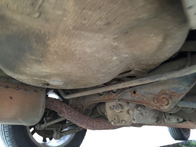

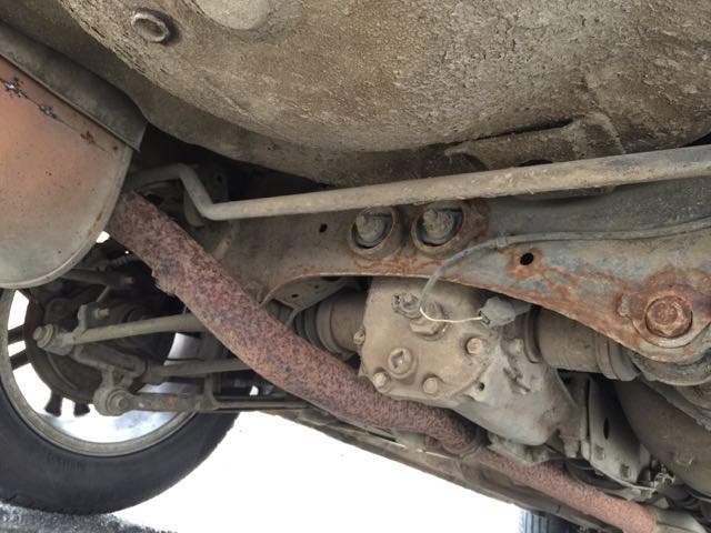

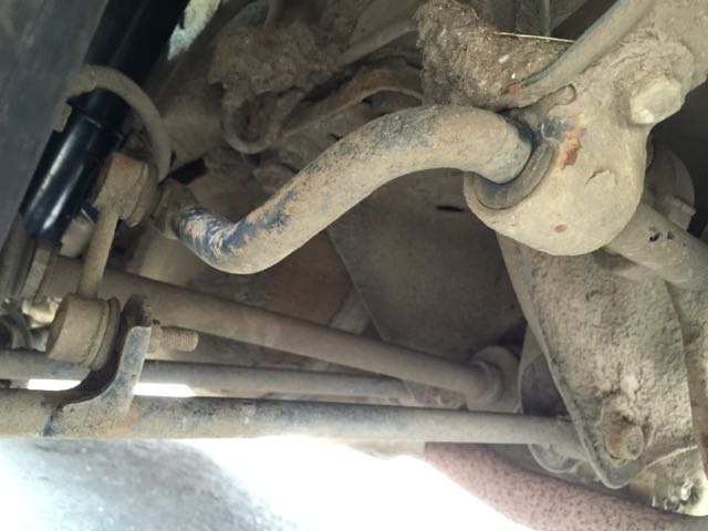

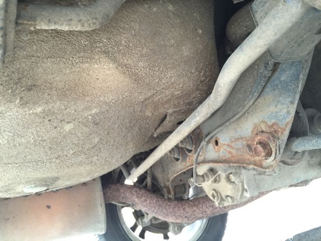

It should do but don't hold me to it can you get a pic of yours ?
Best I could do:
post-4727-0-76936300-1439305182_thumb.jp  post-4727-0-30700400-1439305183_thumb.jp  post-4727-0-89651200-1439305183_thumb.jp  post-4727-0-35878200-1439305184_thumb.jp  post-4727-0-93678900-1439305184_thumb.jp  post-4727-0-41663900-1439305185_thumb.jp  post-4727-0-88508400-1439305185_thumb.jp  post-4727-0-18806500-1439305186_thumb.jp
Have a look at pic no7 on the eBay ad you'll need to imagine the big bend being the other way up and over the exhaust, i'd clean all that mud off the fuel filler they rust out eventually [emoji26]
I'm rather embarrassed; I didn't even notice that when I did the shocks. Oops.
Yeah the whole underside needs a good clean, the previous owners used it to get around their farm.
