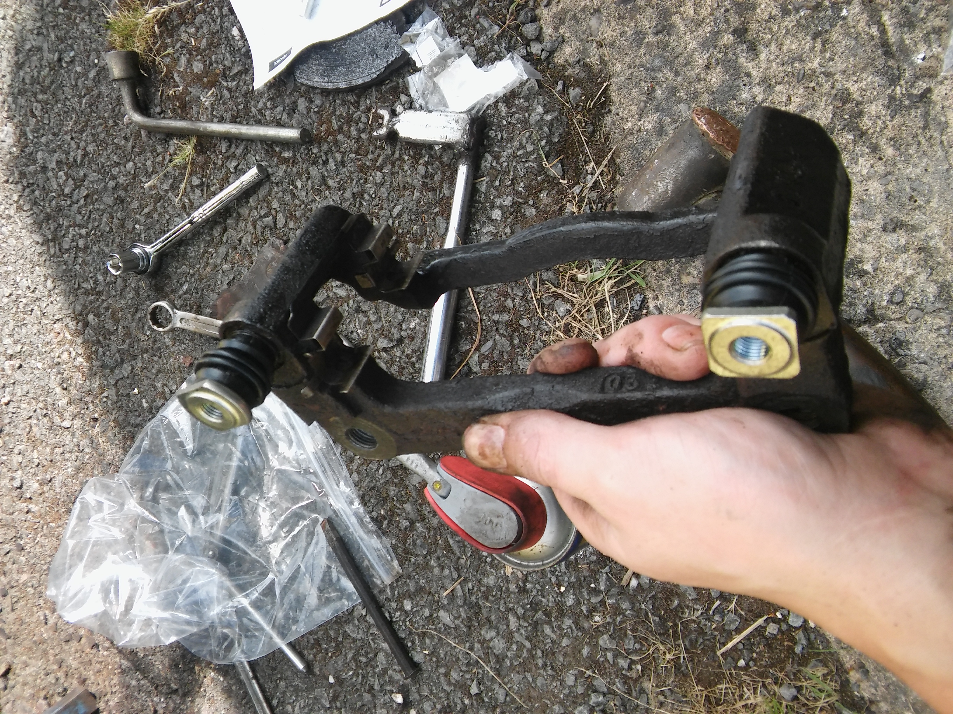

Hi all just seeing if anyone has any tips to get the locking and sliding pin out of the housing they are siezed dont move or pop out i have new ones just a bit stuck on removing these they are single pot calipers if that helps
Heat them up ? Or just spray a lot of penatrating spray leave for 10 mins have a brew and try again
All done i used heat and a vice got their in the end thanks

...so anyway, guess she has two callipers to sell minus the bits you are holding in the picture! Looking at my last post... Got autocorrect interference!
*also remembered to add spoke to someone who doesn't recommend heating that part... But if you have nothing to heat up or is heat sensitive, there is a freeze spray you can use which does the same thing but the other way round, also does a good job cleaning. Although I don't know what it's like with rubber parts
I didnt heat it too much as i didnt want it to go brittle just plenty of wd40inside and a litttle heat and some force sorted it. Both bottom pins on both sides was siezed but thought may aswel change top ones too and piston seals while brakes was apart. I thought about uprating the brakes to 4pot calipers but then changed my mind, as in all fairness it dont need them it stops good enough with these ones now. Trying to keep it all standard being a special but i need power lol
