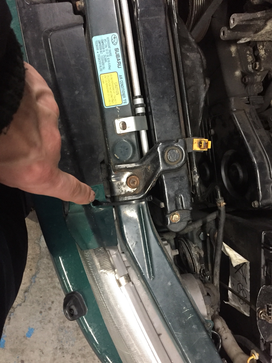

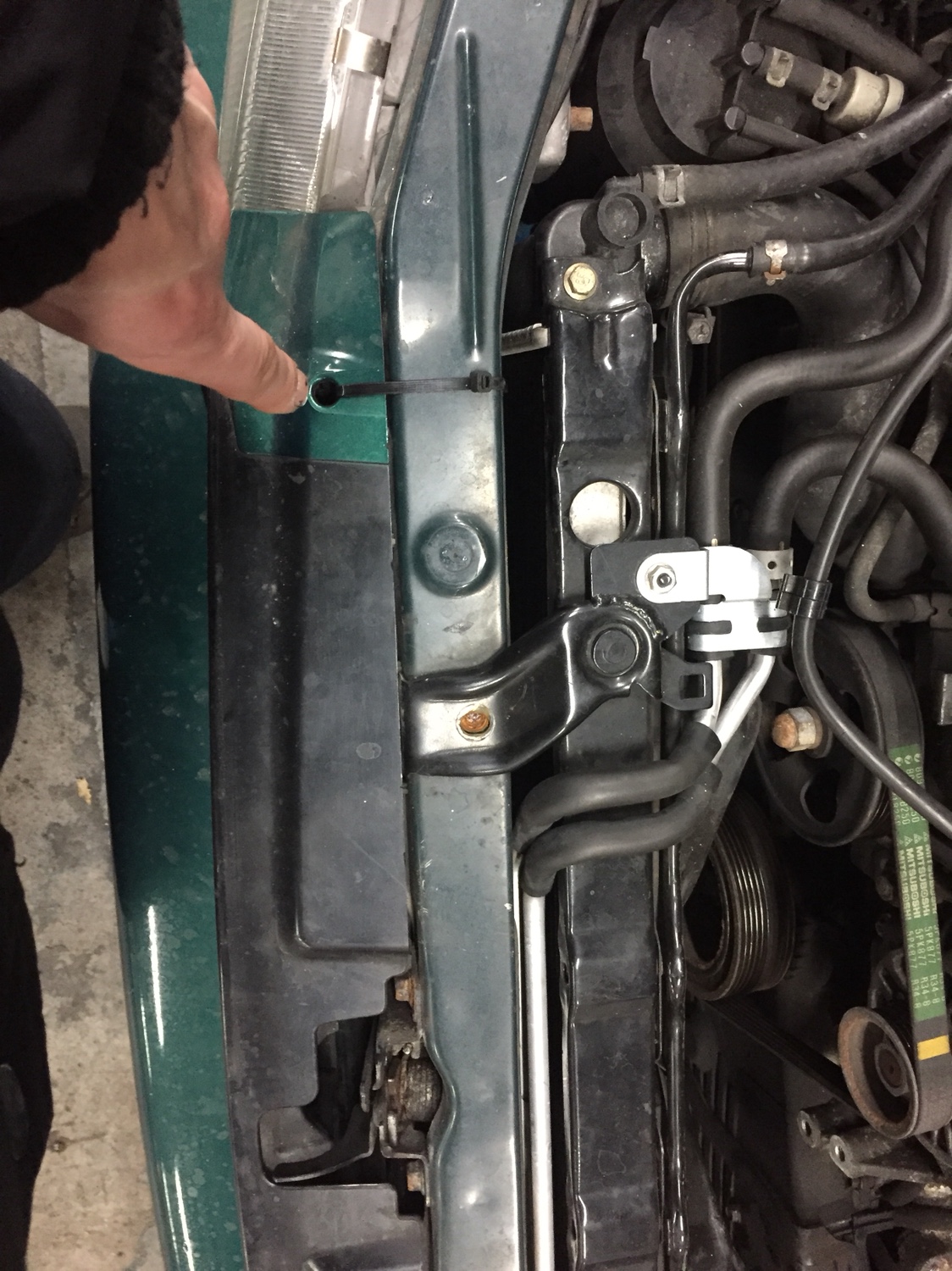

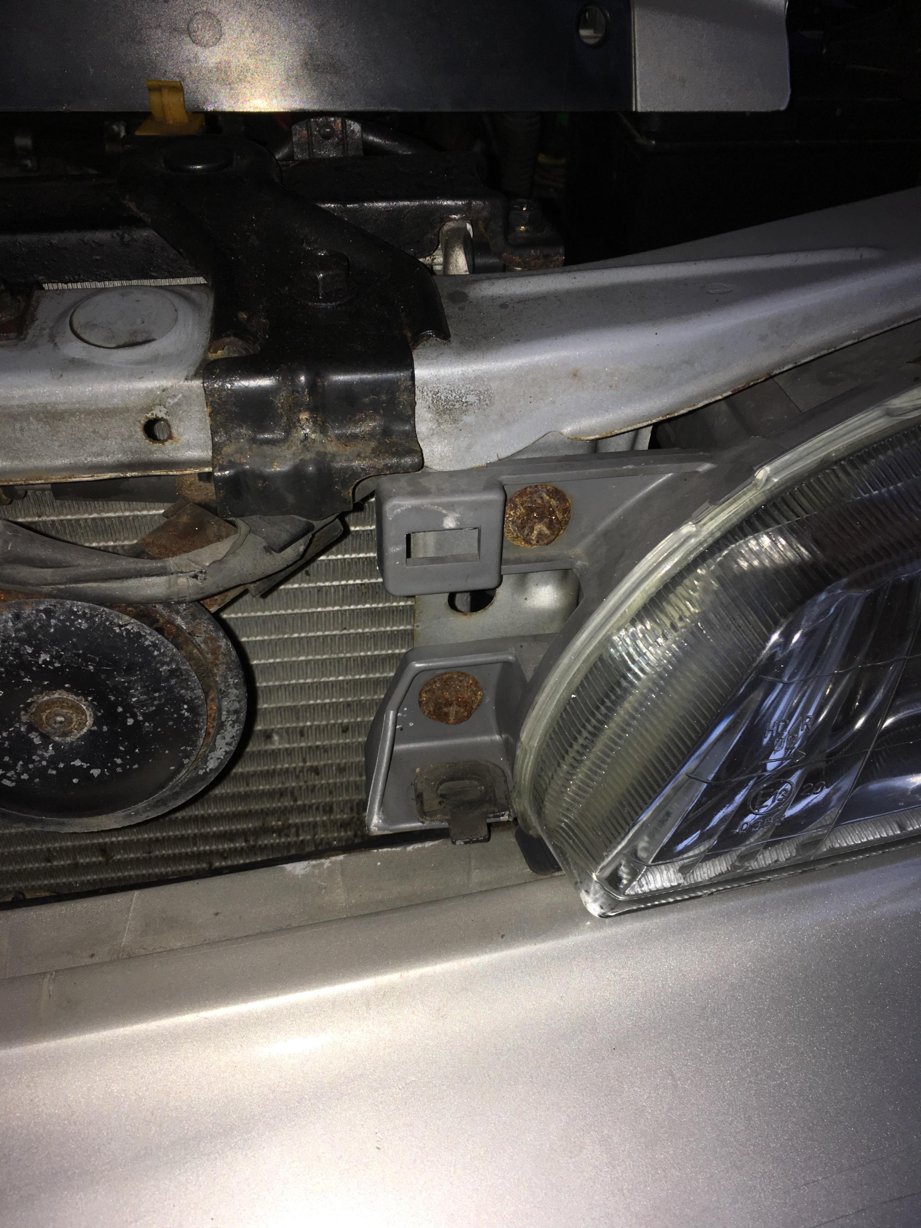

Mine has a cable tie on one side. I am on the process of taking the bumper off so I’ll see why it’s been put on. I’d say the locating clips on either side at the top have been broken off. Cable tie = quick fix..

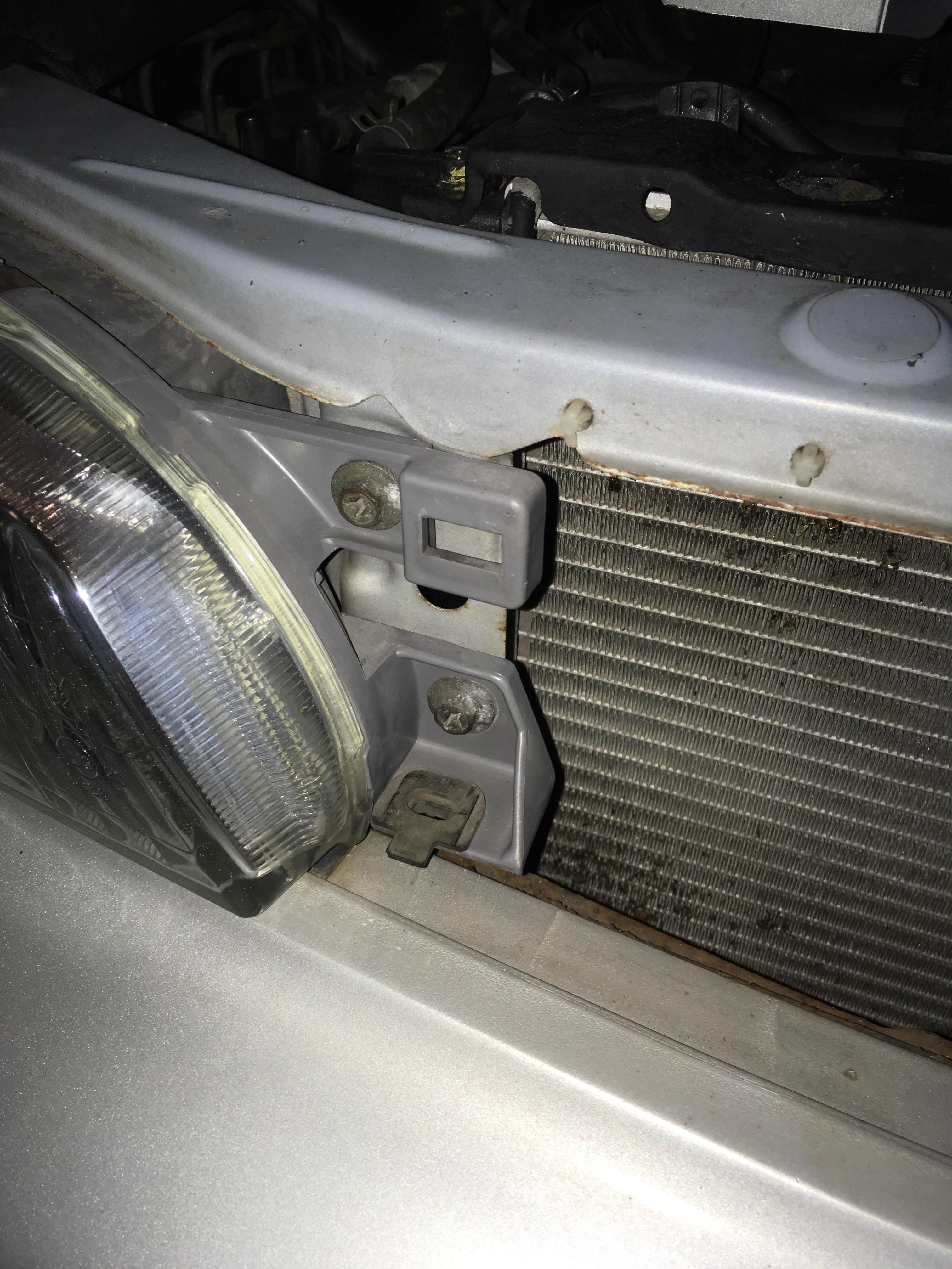

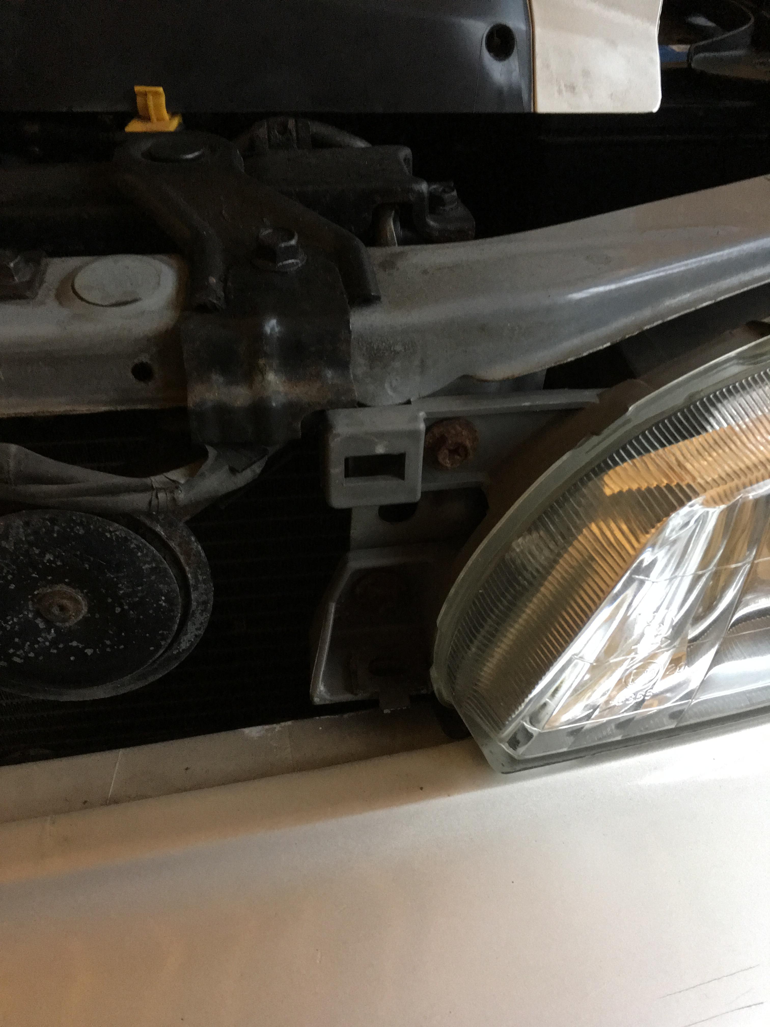

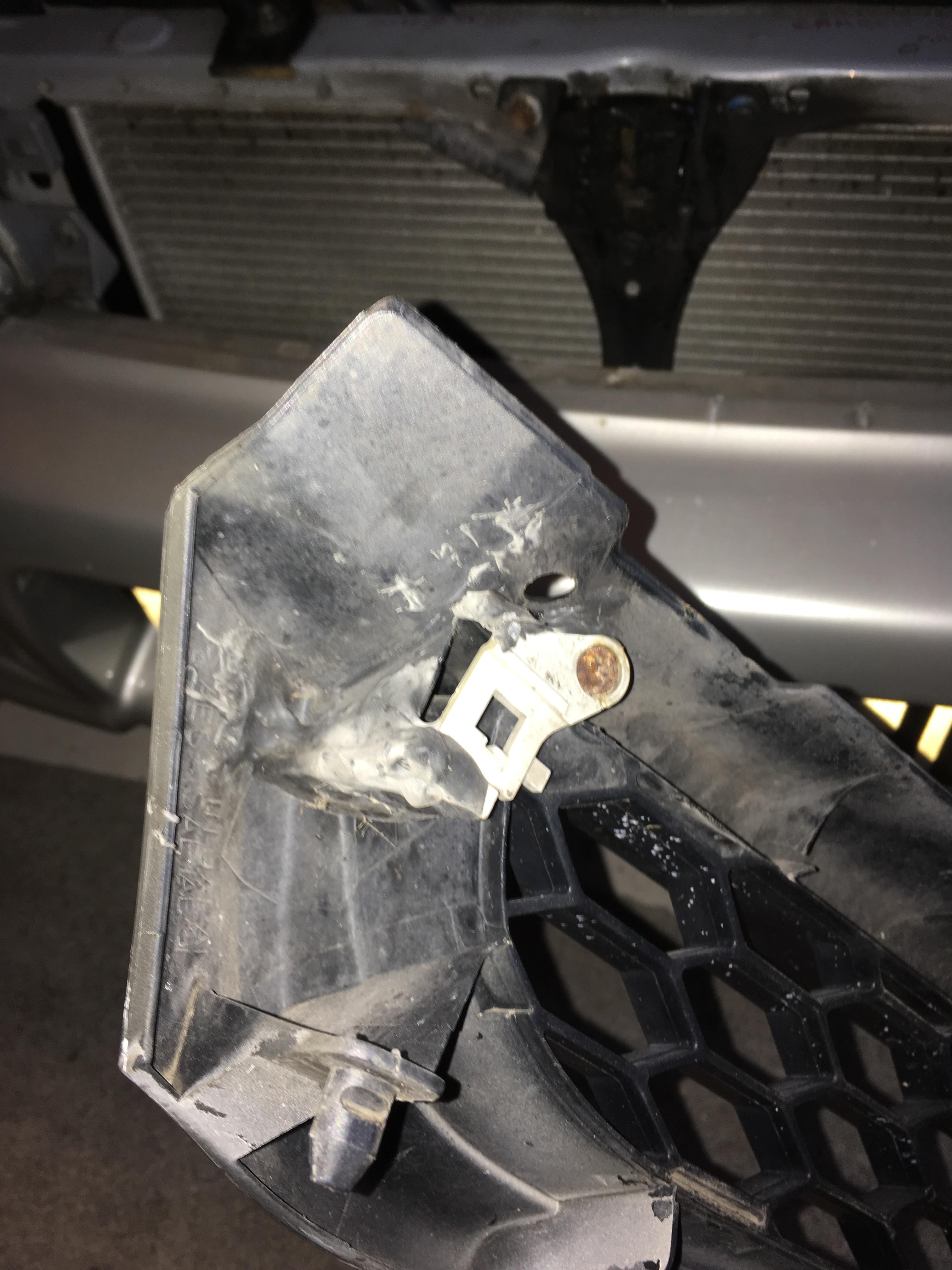

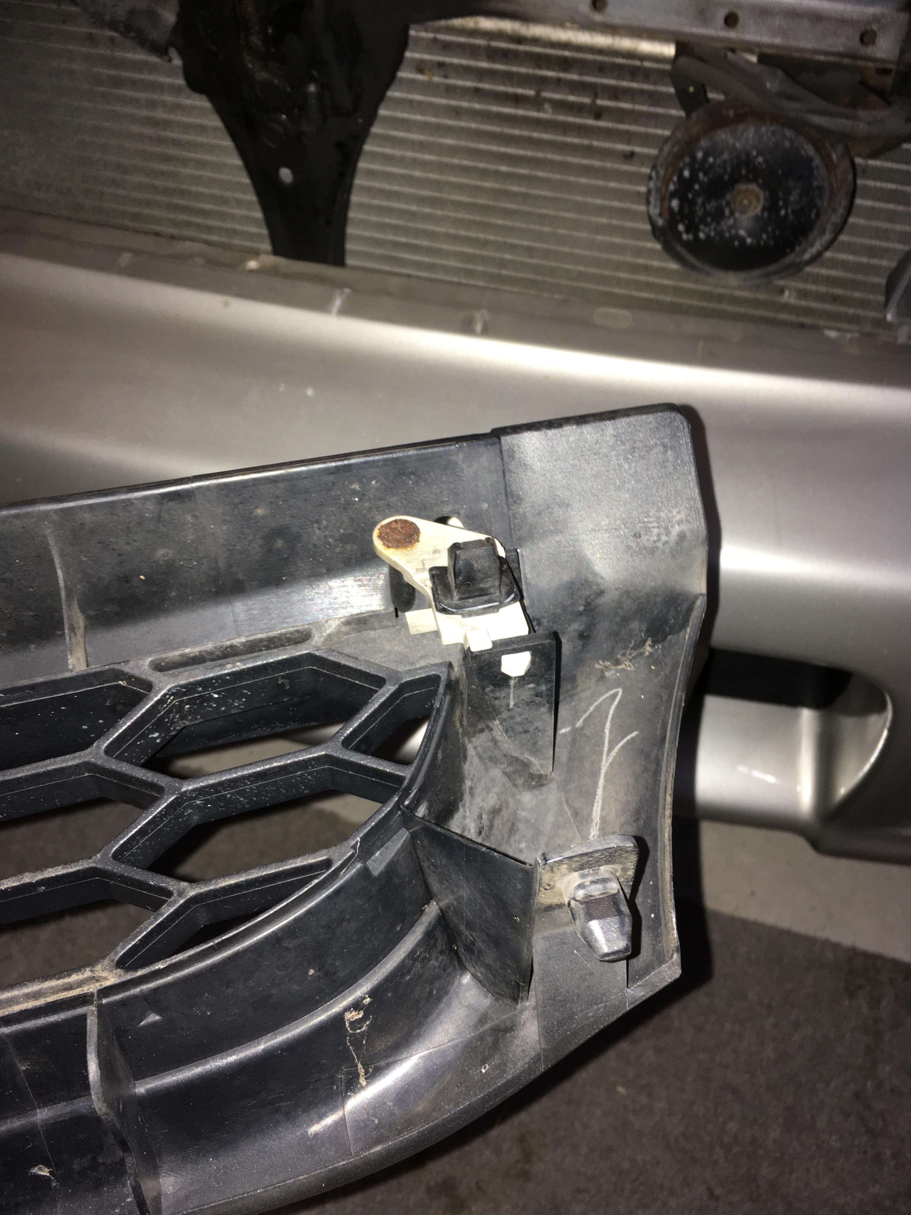

The other side is fine and looks like the next pic. The other pictures are where the clips locate on the headlights. The top of the grill needs carefully pulled forward then lifted up. If the bottom clips stick pry them out with a flat screwdriver.
Makes sense now cheers Matt
