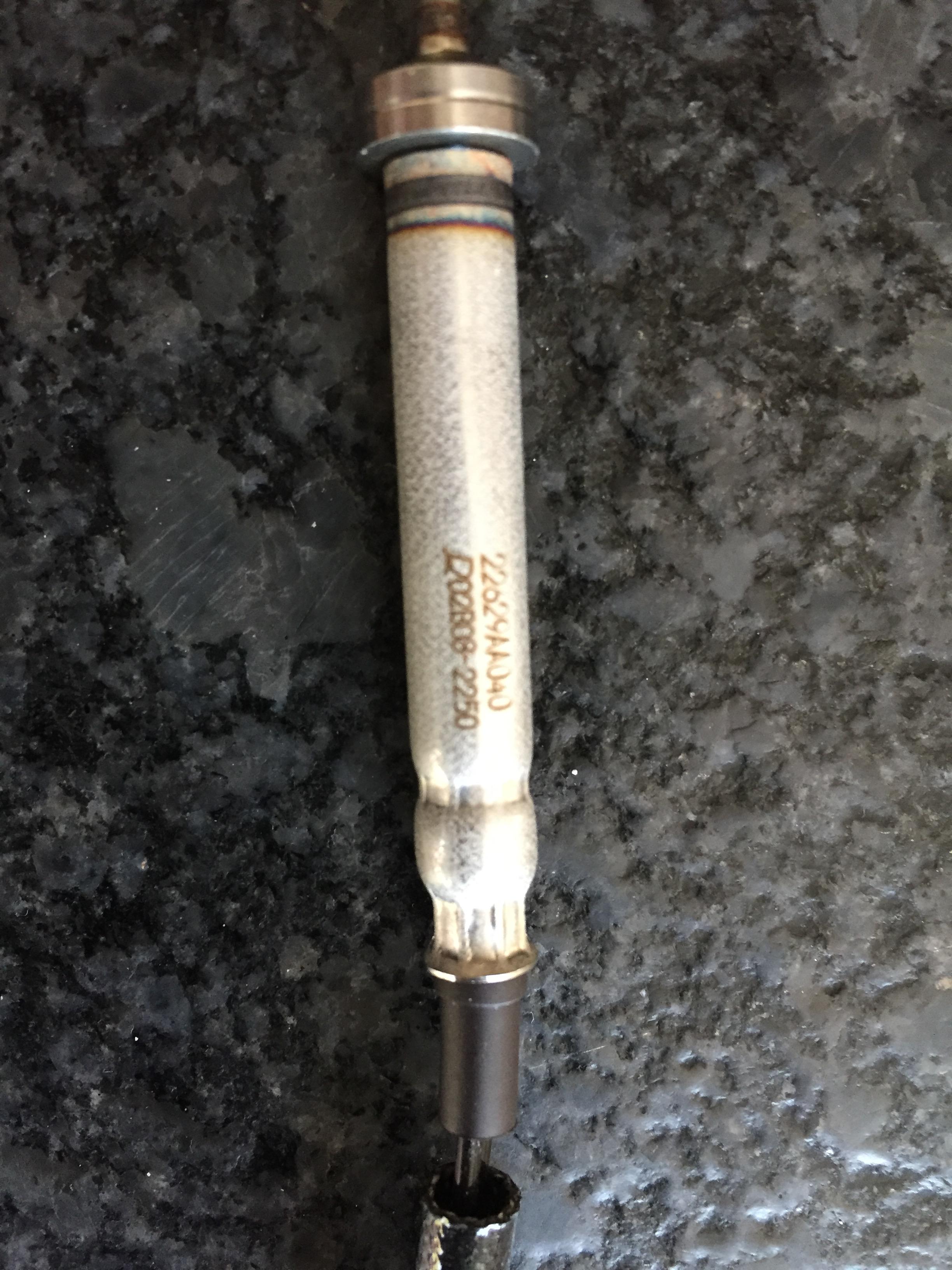

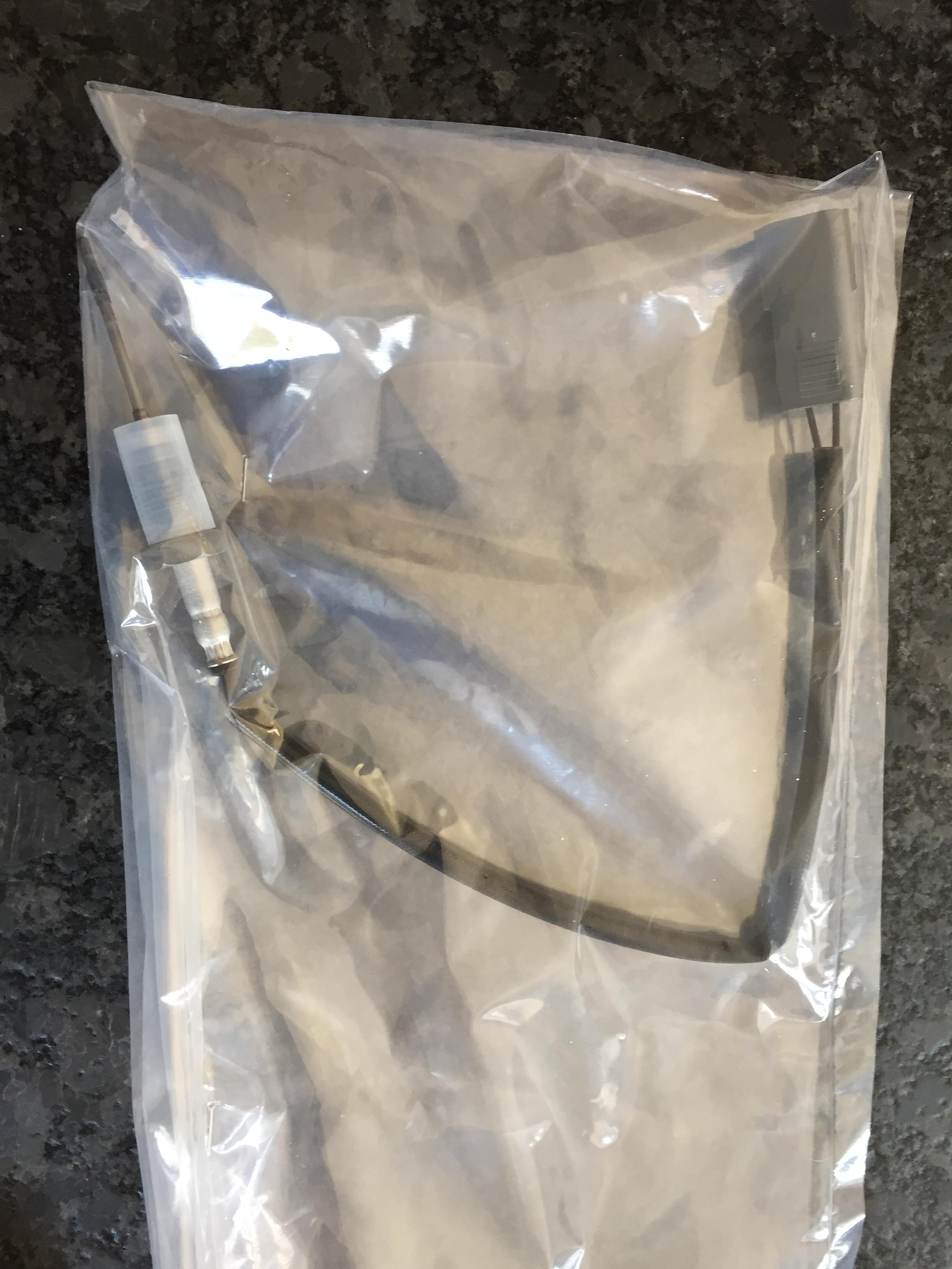

My car wouldn't go in to re-gen mode as the EGTS was fooked. There are 2, this one is the first sensor, located right at the front center of the DPF, and you need to remove a small heat shield to get at it.

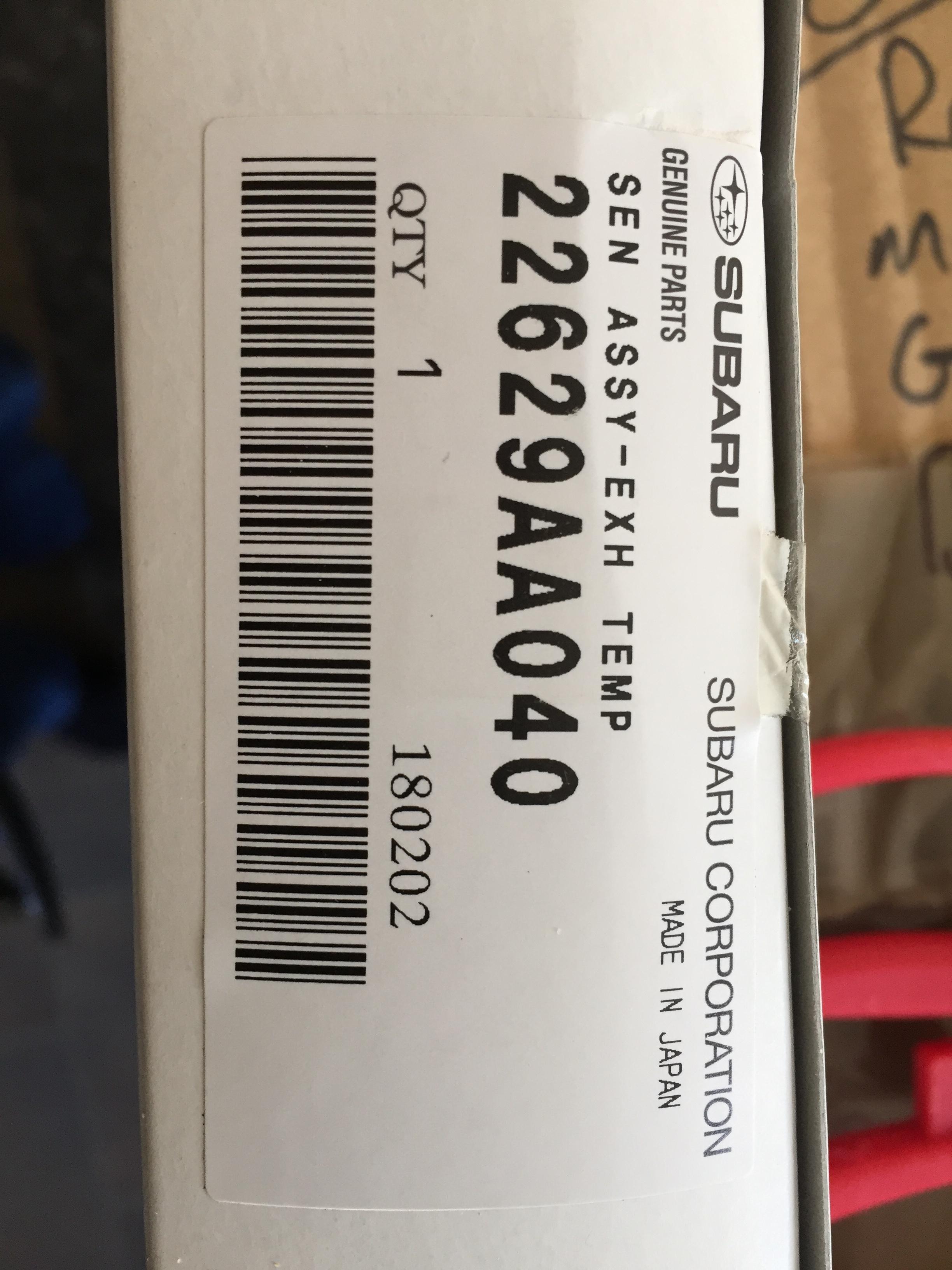

Exhaust gas temp sensor (EGTS) part number for a 2.0ltr boxer is 22629AA040.
They are cheaper from the dealers, £140 delivered.
Using a reader, you can see if yours is bolloxd as the temp reading will stay flat (mine never read over 160deg).
