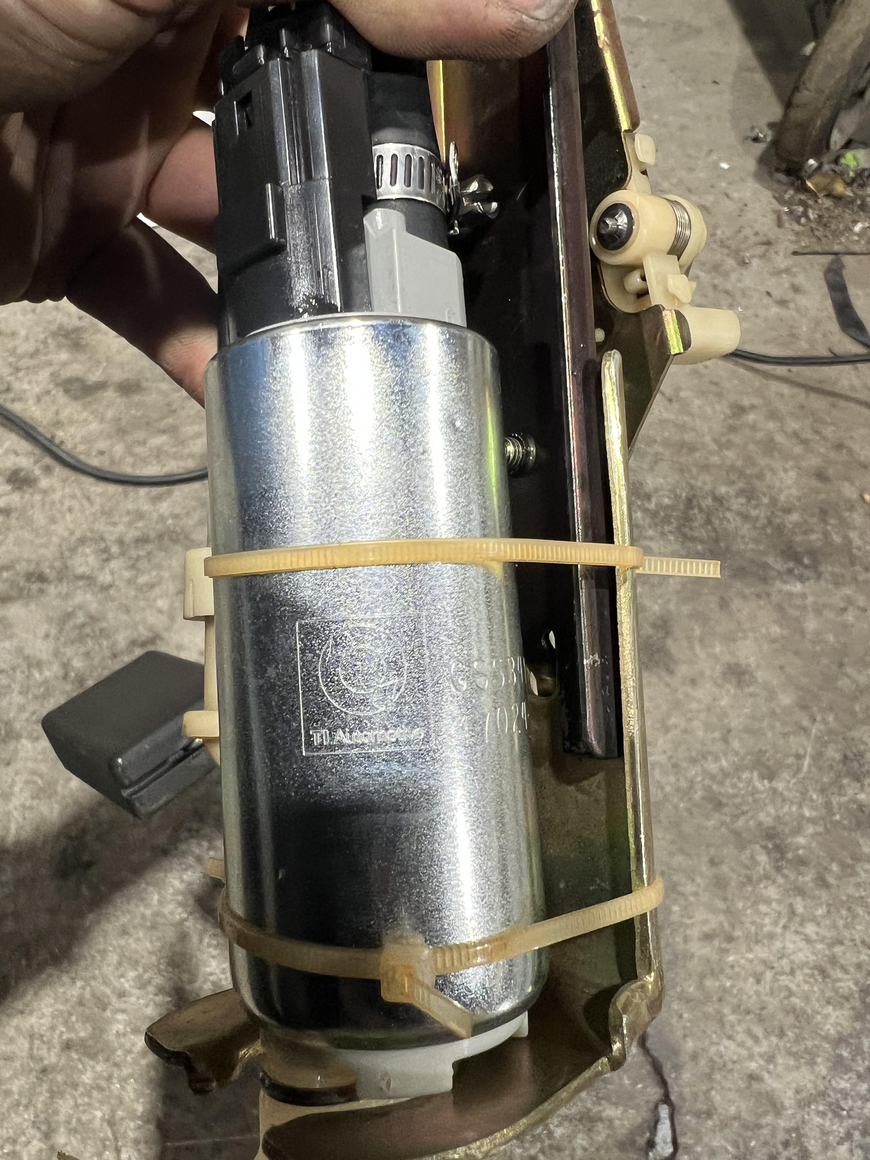

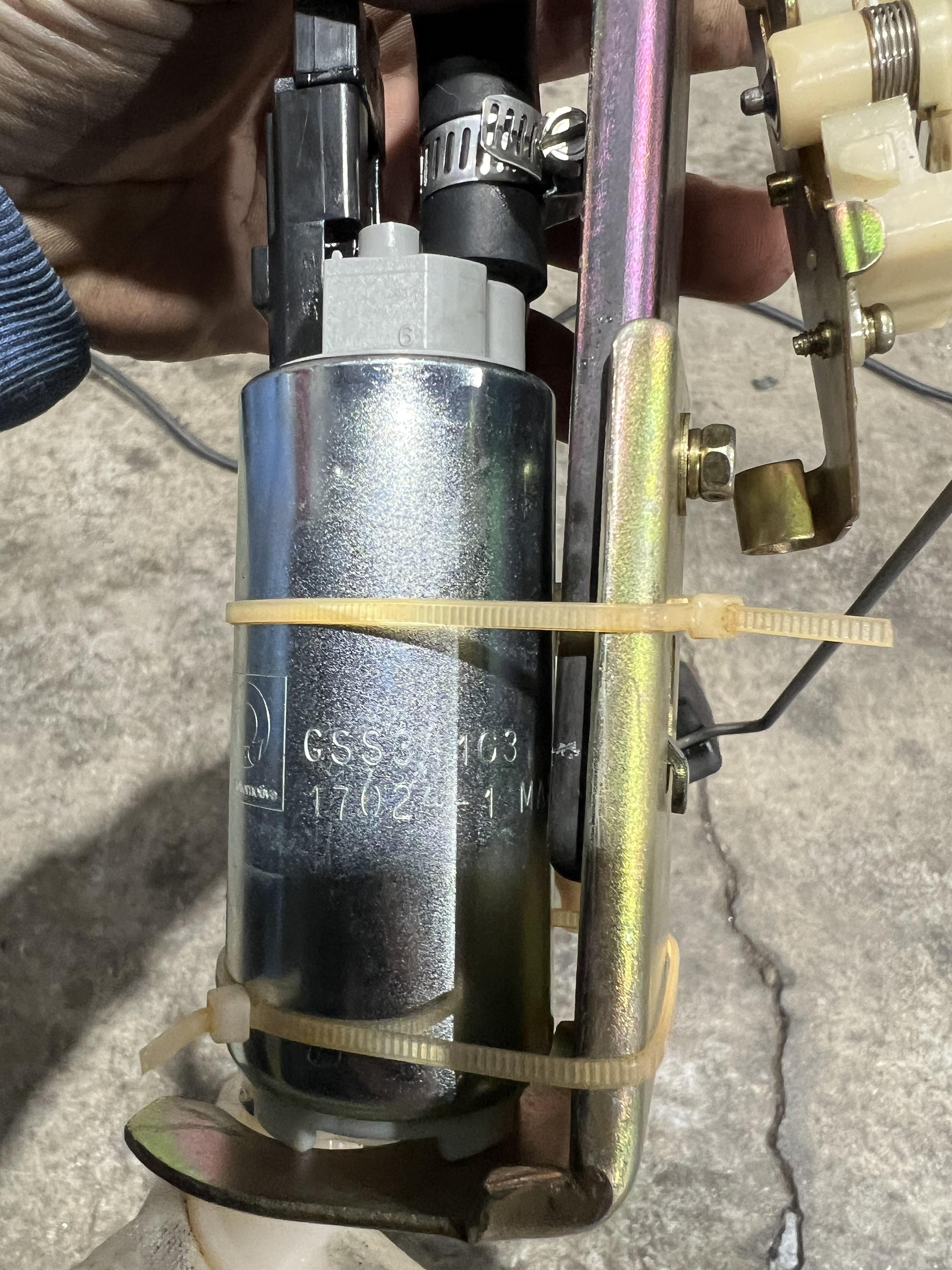

today I cleaned the fuel pump filter in the tank it was pretty blocked to be fair, still the same, was told it’s a walboro 255 fuel pump but I’m not sure if anyone can confirm from piccy ?

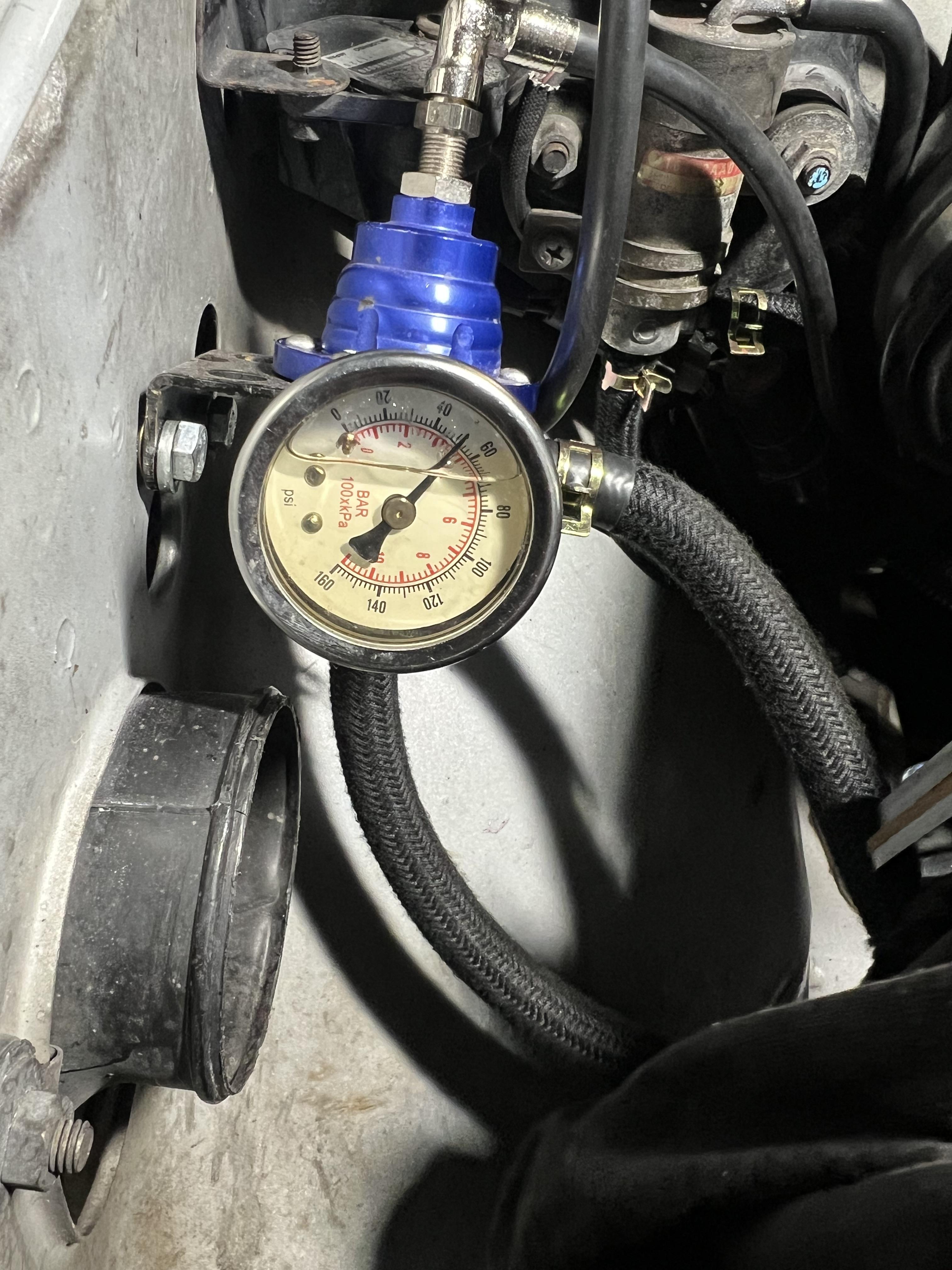

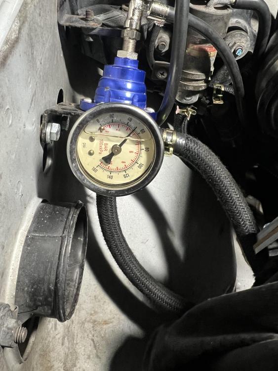

Maybe my issue is fuel related I’ve done some  research  and my regulator reads nearly 3 bar on tickover with vac line connected, this seems high to me ?

tbh ive seen walbro look different even with different brands that are just rebrands lol but it does look like the codes match this one,
https://www.glencoeltd.co.uk/ti-automotive-fuel-pumps-walbro/ti-automotive-walbro-255-lph-in-tank-motorsport-fuel-pumps/
boost gauge will go negative at idle, have you changed the engine bay fuel filter?
Whats rpm is it trying to idle at?
tbh sounds like you need to get it to a specialist and see what they can find.
