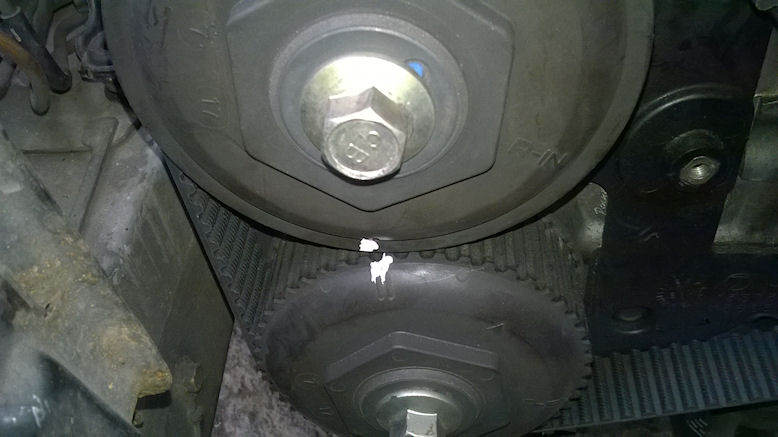

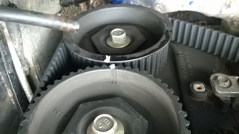

Got to the bottom of my rough running. I changed my coil and leads along with plugs and air filter. Car still ran erratic on idle and jerky when driving in low gear. I decided to check the timing belt and It was at least one tooth out. Put a new belt on and she now growls like a Lion.  :D
The photos show the right and left slightly out when the crankshaft sprocket is aligned.
