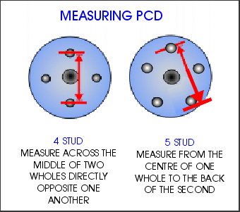

Hi chaps, I have a 2002 WRX Wagon and am just looking into some coilover kits, I keep getting asked the same question, I need to know the following about my Impreza,does it have
  5 lug in Pcd~100 or 5~Lug in Pcd~114.3.
