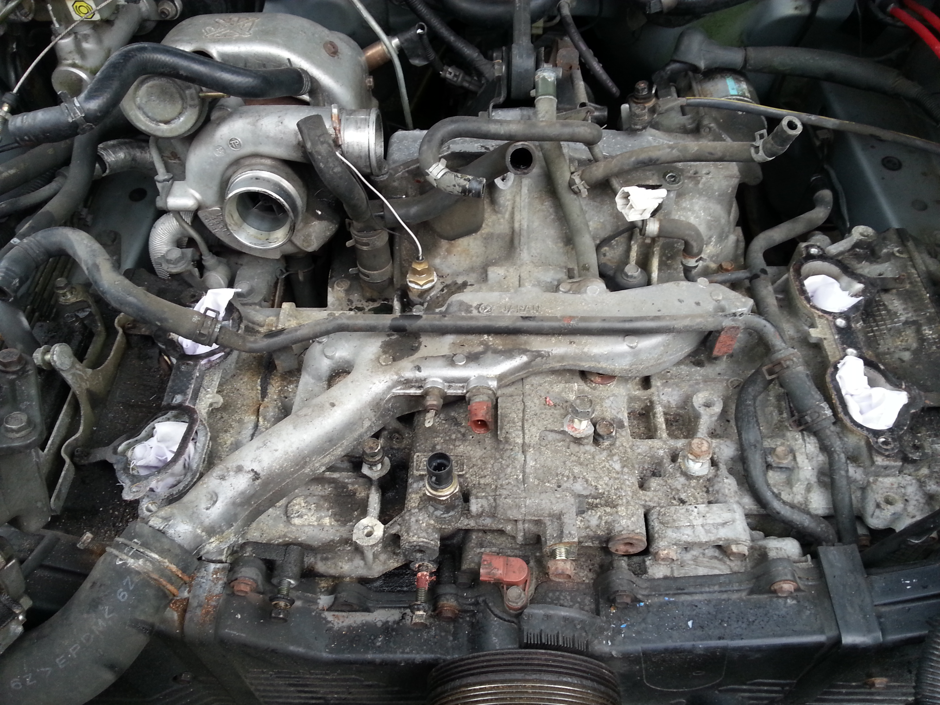

Need help please!
rob wrx import
Hi rob , some pics of how far it's been stripped and what parts you've got would be ideal .

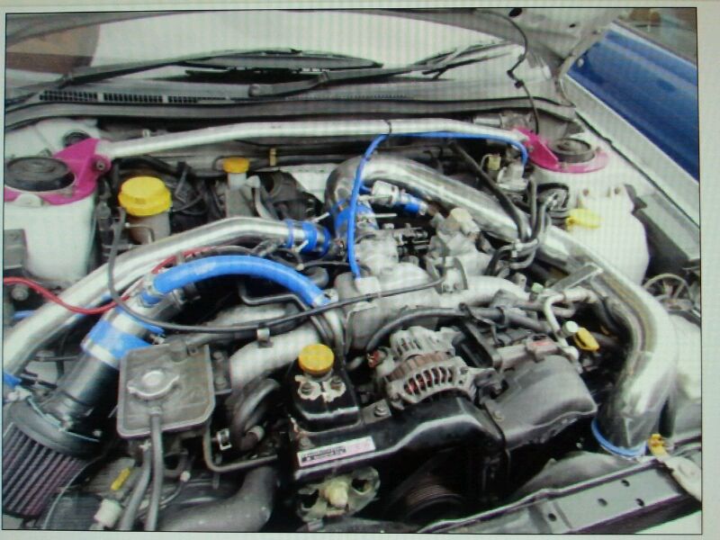

here's a old pic of my v1 phase 1 (same as v2) only major difference in this pic is the fmic and induction pipework.
I've done v1 to v3 and then back to v1 (long story) so have got a few spares and pics that might be useful .
