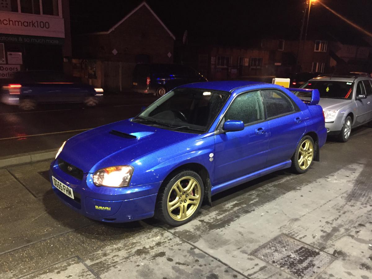

Hey I have a wrx300 on an 05 plate clutch has never been done before so I wanna get in done can any one recommend a good clutch not much but not to cheap Ive been told by a friend about upgrading the clutch and the mass flywheel any help would be great or a link to the item
I'm hoping to do with my friend so don't want to mess around to much
Many thanks post-3673-0-20184300-1422107465_thumb.jp
