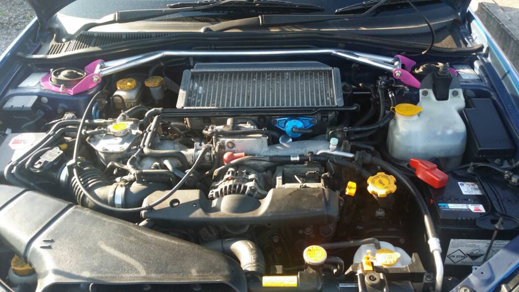

The hose comes from the inlet hose (to the turbo) and comes up just under the dump valve. It will either be removed and blanked at the inlet or kept in place and blanked off as can be seen in the picture above.
Just had a thought could be purge solenoid valve for the fuel system is it on the right side of the engine bay next to the filter. If it is may have been blanked of or left disconnected by someone not knowing what there doing
