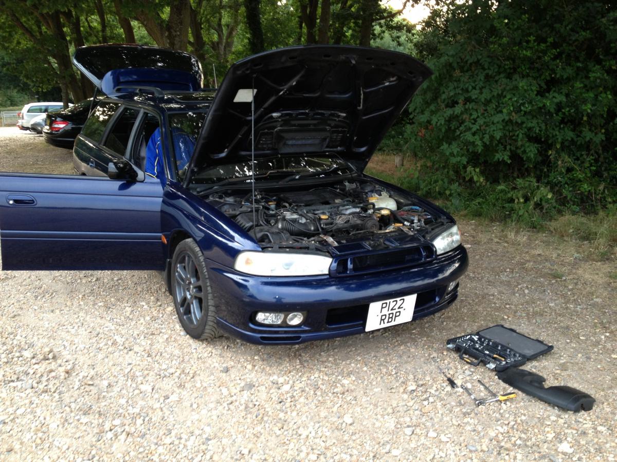

Crank Pulley came undone last night, Got relayed home and I'll check the end of the crank shaft tonight for woodruff key damage, there was some on the inside of the pulley wheel so I'm hoping that took the force.out of interest what's the pros and cons of lightweight pulleys?

I've seen a few with this kind of issue. Hopefully the woodruff key has taken the brunt of the damage. The pulley is easy enough to replace if that's damaged, but if the crank is damaged, thats a whole engine strip down. :(
Same thing happened to me a few years ago but luckily I was less than 100 yards from home at the time.
