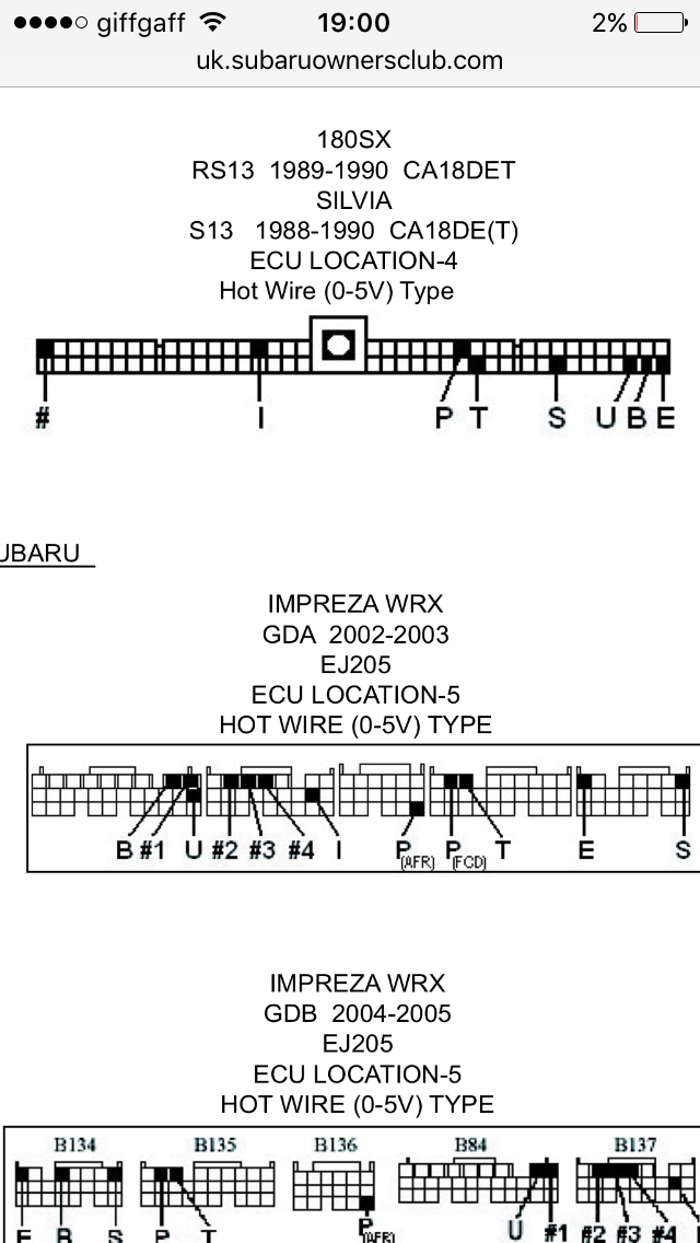

i have a 2001 ej20 wrx newage Bugeye and have fitted the harness and handbrake wires easy.but me and my brother can not find where to put the rpm and speed wires.
it says of the ecu but can not find a diagram or drawings anywhere on the net.we even thought of taking feeds of the wires behind the instrument panel,but still no diagrams or info.its running as a type 0 at the minute Any help would be great , many thanks mark
Wow where did you get that from cause the ones you get with the product are nowhere as in detail as that .
