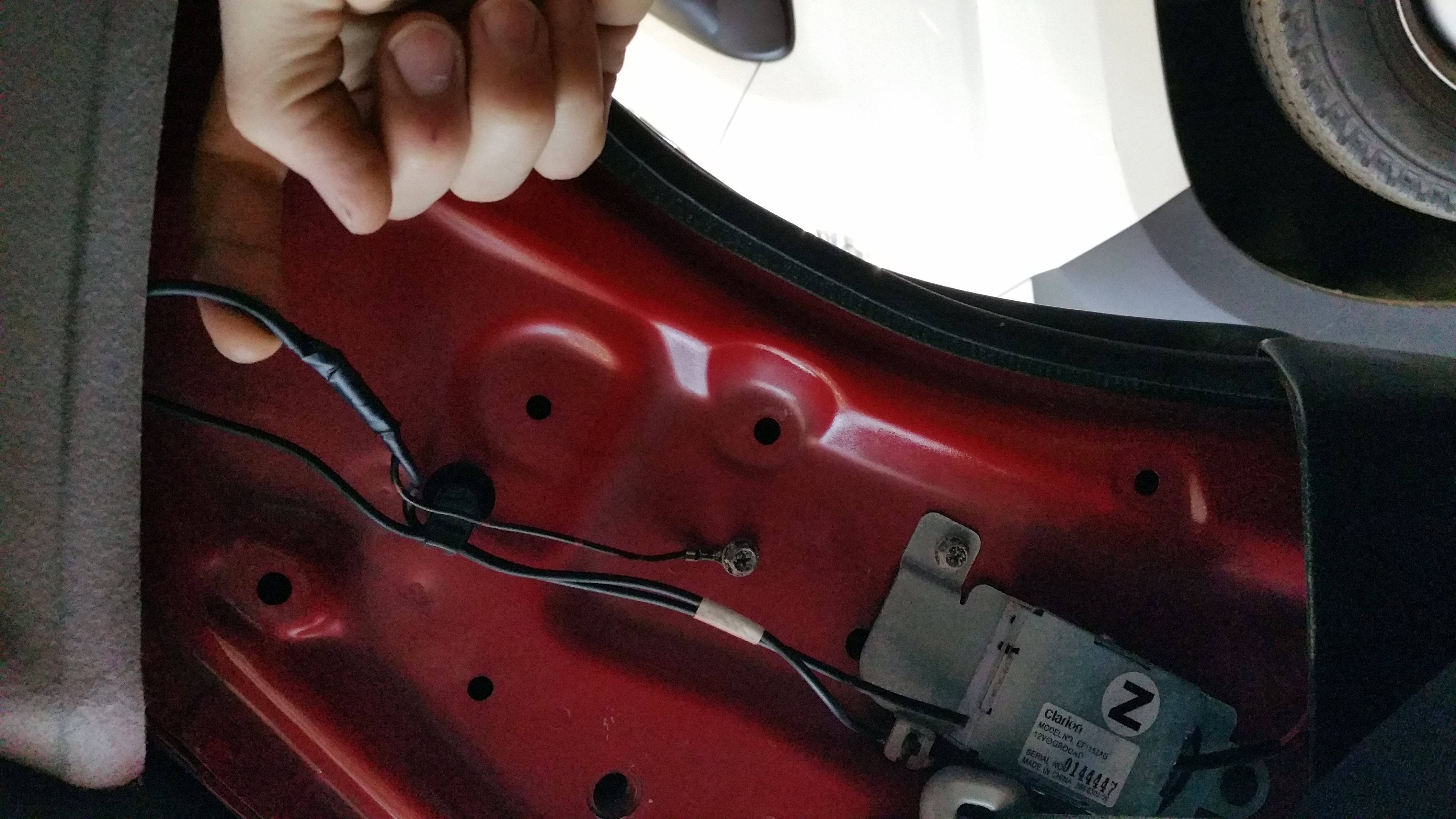

But my signal booster is on the c pillar and a wire had been cut by the looks of it I soldered a meter or so onto the wire that looked like it had been cut and now I can get radio 1 and a few others at least but I would like to know where this wire original went to instead of me jus resting it up in the head lining
The wire my finer is in was the one that was cut with now a solder wire on it..
And to your post about poor signal when the heated screen is on a quick search on Google shows its down broken heated *lines* the ones that run across the glass..
