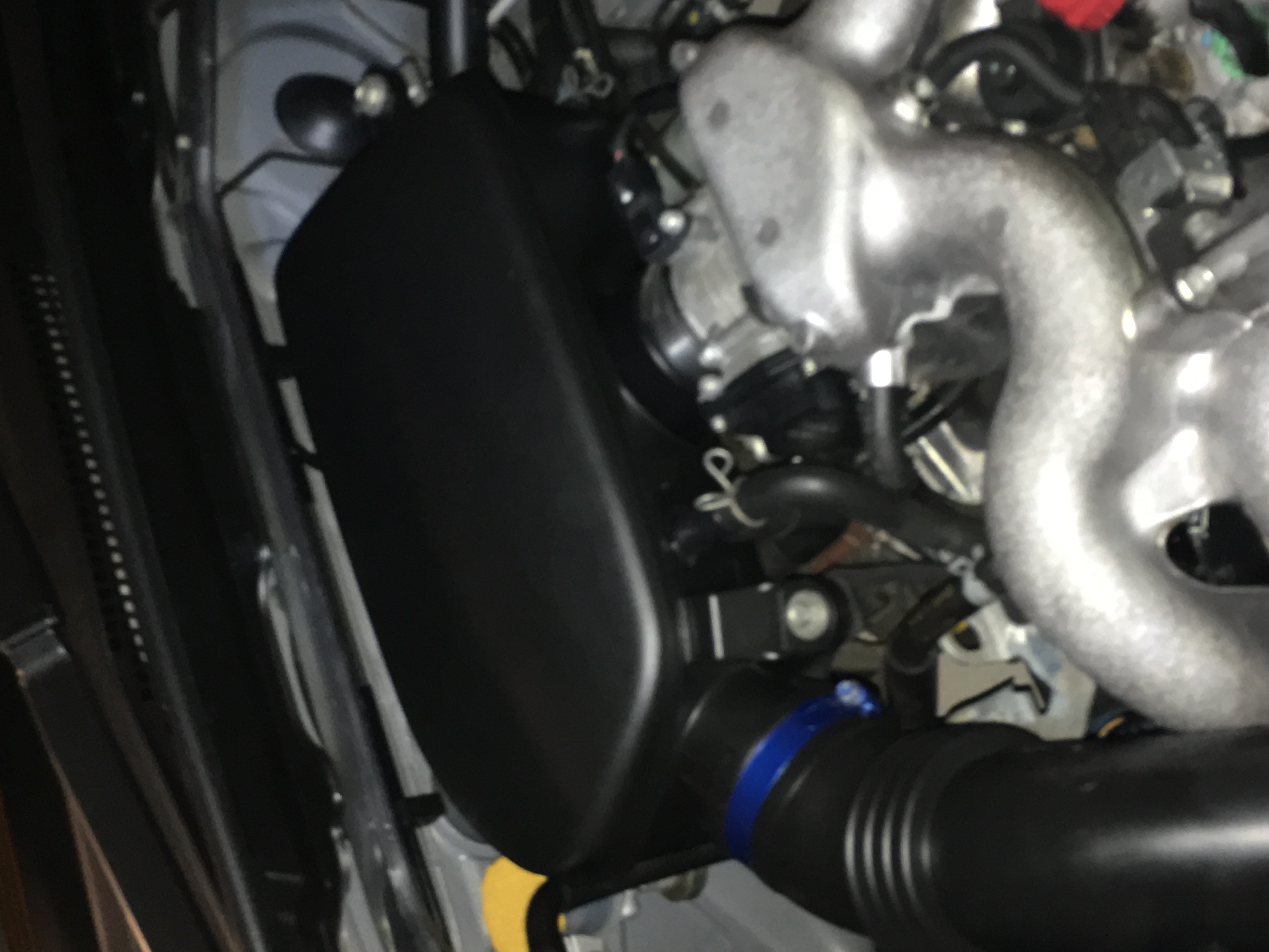

hi its noob time again :D , i was measuring hoses again and found oil in 1 of the breather pipes but nothing in the others. google was useless, have spent hours searching for the name of the damn box the air intake goes into and  where the breather hoses go into.  which then leads to the throttle body.
it has a seem around the top but i have tried everythin to open it aside from a hammer.  maybe its not meant to open?
wanted to clean out whatever it is and get rid of the oil.

Is it possible to open the box the breather hose goes back to? Want to clean it out if I can and probably the throttle body since I changed plugs not long back I want to keep them clean and not gunk them up.

Can one of you lovely people please tell me what this box is called and how to get the oil residue out??
cleaned the throttle body on one side gonna replace the breather hoses but also need to clean out the inside of the throttle body as its black rotten in soot and Oil
