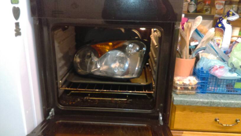

I thought I'd put an update on this just in case anyone was interested. I took out both headlights, split them, cleaned the lenses and made sure the reflectors were seated correctly and reassembled. I now a a much better high beam 😊. Not just pointing down. I think the problem was probably just one headlight and maybe it just wasn't seated right. IMAG0826.jpg.89b10c517fa8bf2063ae20afac0
