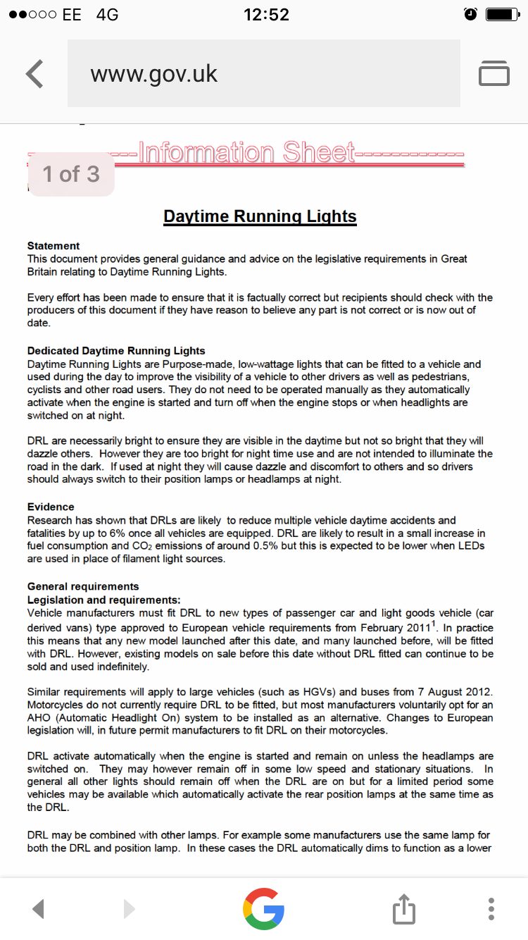

I was going to get rid of the DRL's and put in a better set of fog lights but not sure if I should.
I think you may run into MOT issues on regulation there if you get rid of the DRL's. I believe (although don't quote me since it is a bit of time since I looked at this) they are a legal requirement after a certain date when the whole new generation was launched.
So if, say, the 2015 year is the legal requirement marker in time and the car manufacturer is already making model "x", so that they don't have to re-arrange the front end of the motor at great cost, they don't have to install them until the new generation is launched. But any time after 1 Jan 2015 when a new generation is launched, the DRL's have to go in.
I can't remember the date so Jan 2015 is made up. But I would just take a look at what you can and can't do with these before you remove them totally, just in case.
I could very easily be wrong of course.
Looks like from Feb 2011 that they must have DRL's. Might have to find another way of running a set. There might be a better set of fog/drl housings online.
