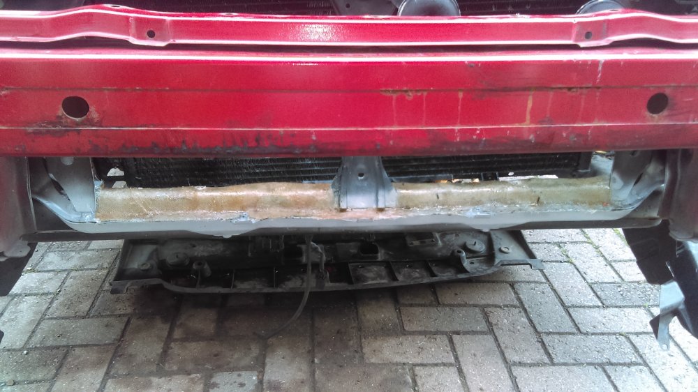

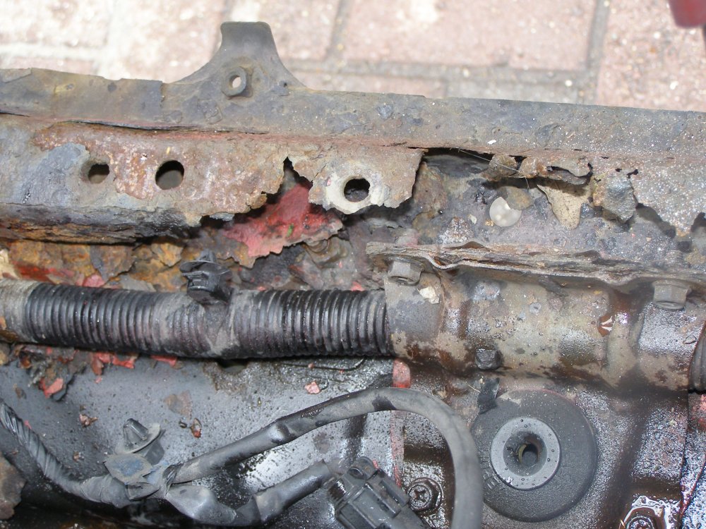

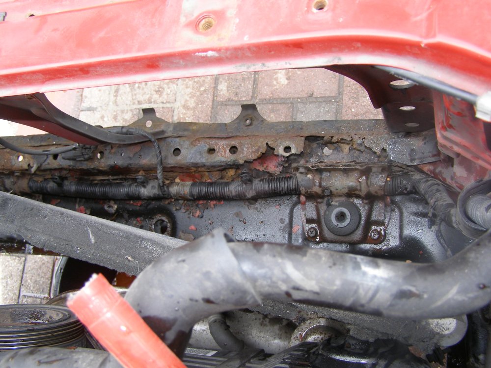

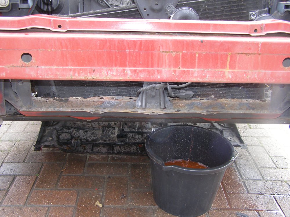

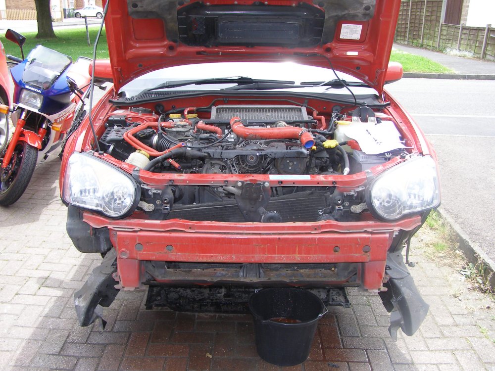

Linx Posted May 28, 2017 Share Posted May 28, 2017 I've been working on the car today. I knew I was going to have to get the radiator out to patch up the rot in the part of the body the aircon radiator sits on. It was worse than I thought though. Not much of it left! Is this normal behavior for a 2003 89K mile Scuby or does it mean my radiator has been leaking for ages? I see this bit has a part number but it's welded in and I can only find American web sites listing it. For now I will repair it with aluminium mesh and GRP. I'm going to get a new rad as well. Only £75 from EuroCarParts at the moment. Quote Link to comment Share on other sites More sharing options...
Hudson Posted May 28, 2017 Share Posted May 28, 2017 Christ that is bad! Once a suby gets past 10years old it's advisable to lose the undertray as it speeds up rust areas on the subframe and front supports considerably unless it's all been rust protected very well. I recently gave all that area a coating of hammerite as mine was still all in one piece thankfully! My next to step is to have all the under of the car and arches cleaned up and given a treatment of dinitrol corrosion protection. Import car parts have the weld in part but have no stock on the shelf so you would need to ring them for availability https://www.importcarparts.co.uk/parts-info?id=11459&cat=96&sub=183&sec=349&var=85&dc=0&gen=&searchKey=&searchPart= 1 Quote Link to comment Share on other sites More sharing options...

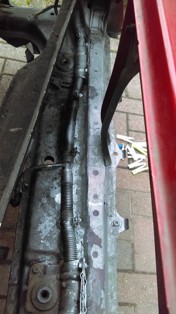

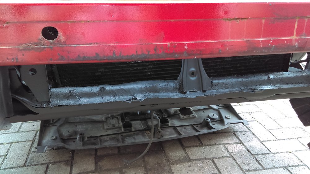

Linx Posted June 1, 2017 Author Share Posted June 1, 2017 Repair done. It's not brilliant cosmetically but much better than it was. Should last a few years. Clayed and waxed car while I was at it . 1 Quote Link to comment Share on other sites More sharing options...

Mr B Posted December 30, 2024 Share Posted December 30, 2024 It obviously got some structural role as it ties leg rails together and is rather beefy if purely for component mounting. It is an area that can fall out of mot when not within 30cm testable area . Bad point of tester seeing real heavy rot is will make them more diligent look elsewhere on vehicle for similar corrosion . It super easy chop worst or all of it out and fab one up out of some box section or u channel and flat sheet metal . New panels are only around £120 If wanting real cheap repair if find a scrap car with clean lower rad support panel you can chop out what needed and graft it into yours for small costs . I call what the yanks call the slam panel the upper support panel that the top radiator brackets bolt to and the bonnet latches into . The lower one I call lower radiator support panel . Not all models same part but they do cross to some extent . Quote Link to comment Share on other sites More sharing options...

Mr B Posted January 1 Share Posted January 1 It potentially fairly easy area repair so cost could be pretty reasonable, especially if had a decent used lower rad panel to graft in. Could be worth doing some rust prevention treatment such as dinitrol ML and a black wax . Volvo got some good points but since the days of Ford ownership and currently the Chinese they nothing but constant faults and expense . If you want decent made cars that reliable and low cost minimal ballache then stick with older models . Newer vehicles are a complete waste of finances & engineered to milk your bank account dry . Quote Link to comment Share on other sites More sharing options...
