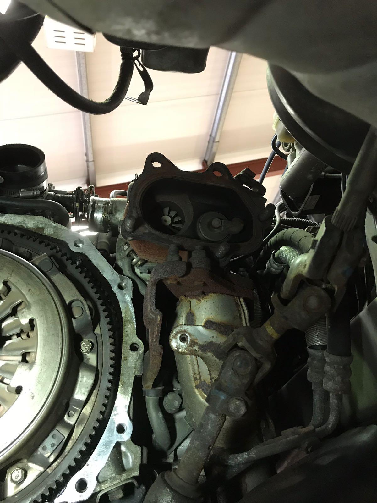

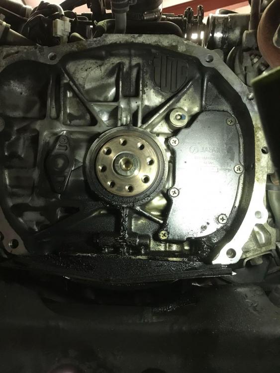

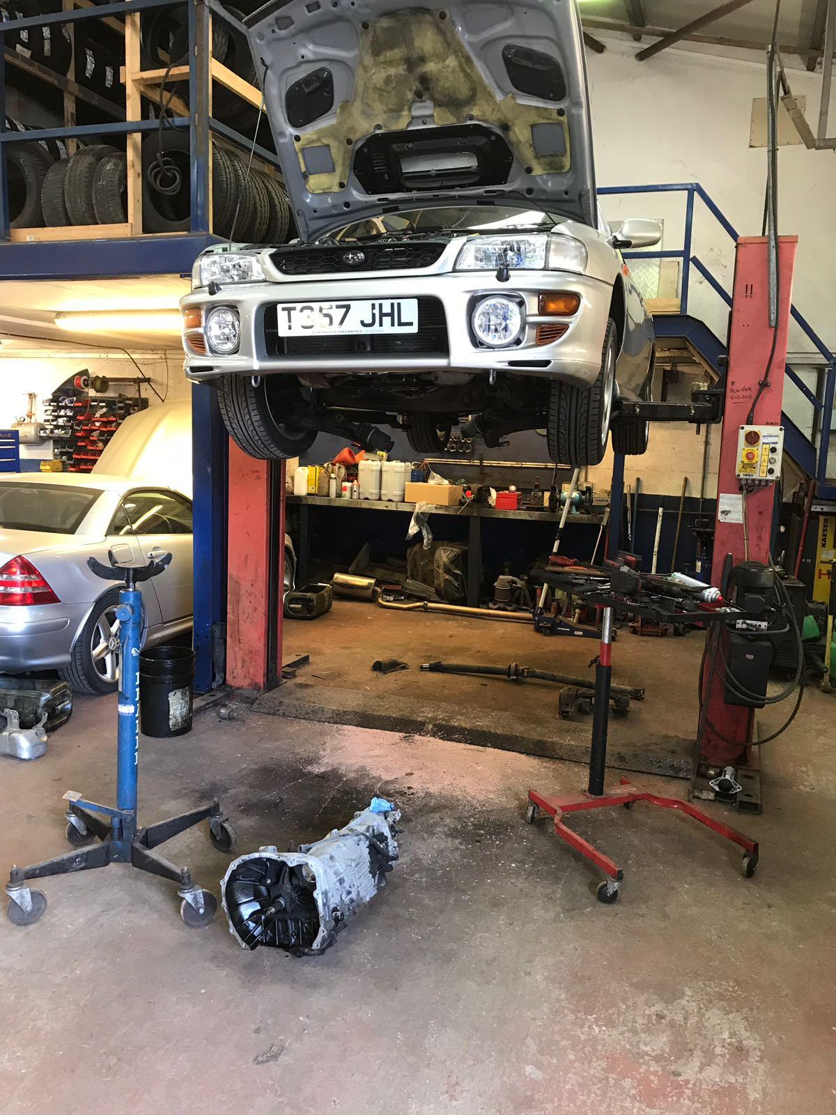

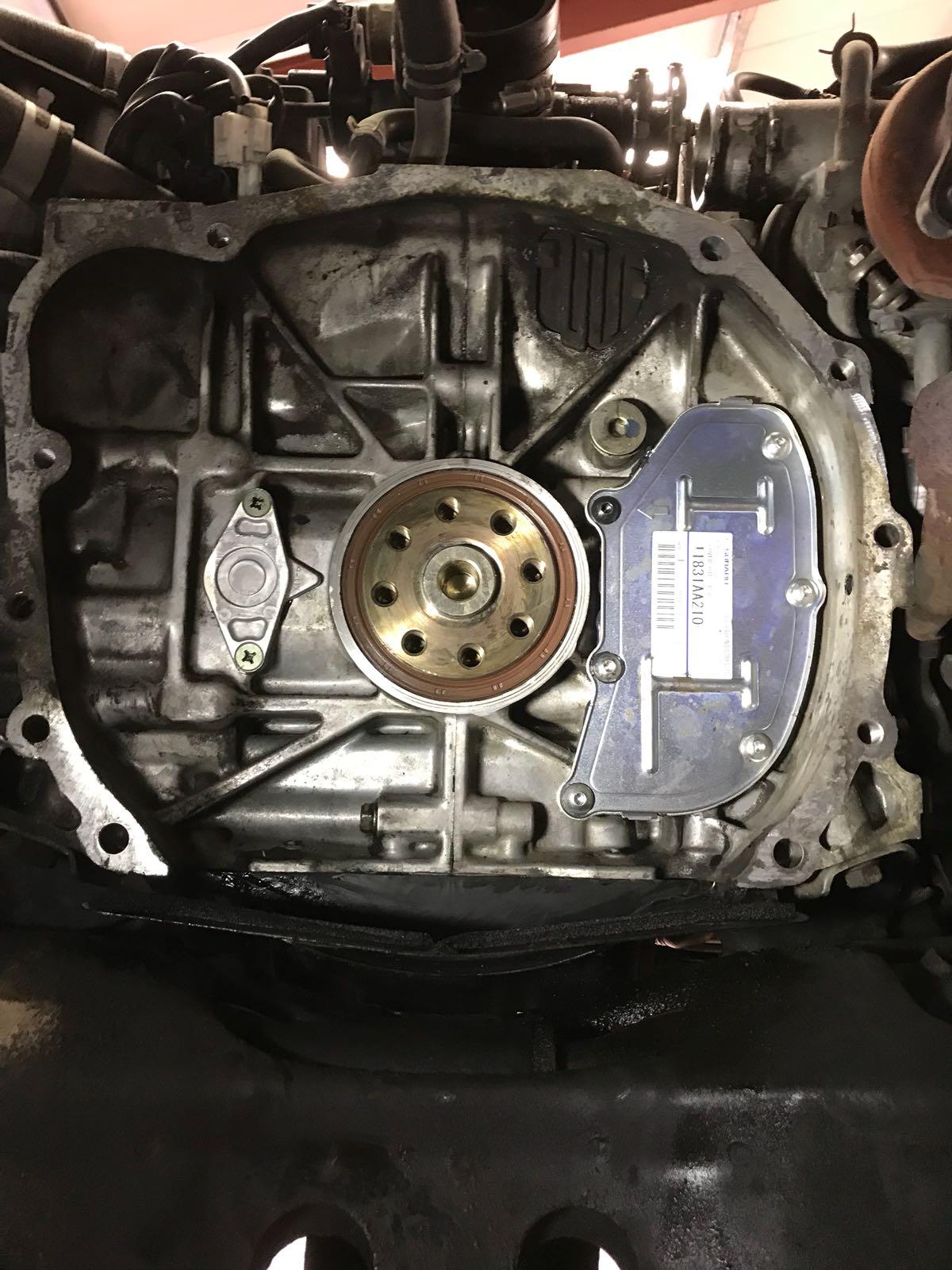

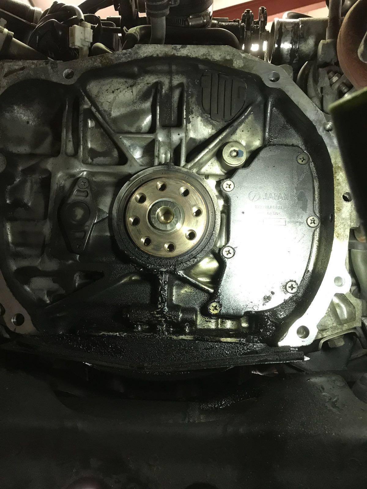

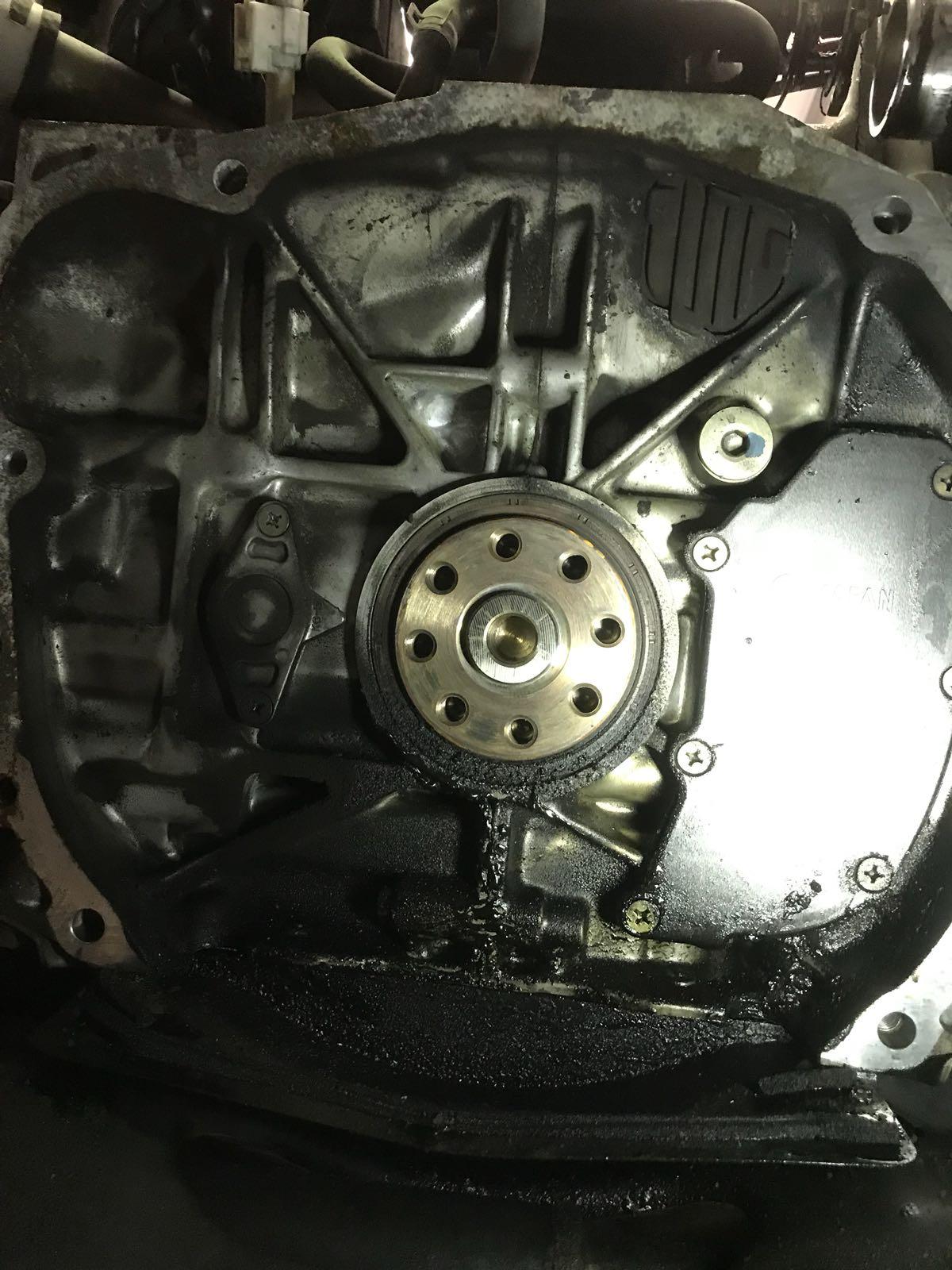

Finally got the oil leak sorted. I had to get it in before my mechanic left to go and work on tractors for a living. 🤔 3E0E15E0-505A-4A80-A3C0-3BFE664C4499.thumb.jpeg.c5afac1bb54ca82e1e6de53060fd1bc5.jpegC83A6DCE-44A0-4F9A-B093-2A8E197A203D.thumb.jpeg.8edf7820f744caeb89107d822a9a2d4e.jpeg70FFE272-BEA6-48D2-BA8F-A7CED86A75CB.thumb.jpeg.399ec32e8f1a5ebc02a19ea813b880fe.jpeg0B1405F7-DDF0-4DE2-95D8-60D356153CC9.thumb.jpeg.bf14488b45f3878ed34e6c5d301d2e66.jpeg6C300751-98C5-4DD0-AD4A-918A91385304.thumb.jpeg.cede144af6b46125ad9e4ebd98a42b15.jpeg9C507D5A-01AC-42A0-9079-C2A1718DD50F.thumb.jpeg.2c27514c79a2f7d755cc4e9fa5731bfc.jpeg

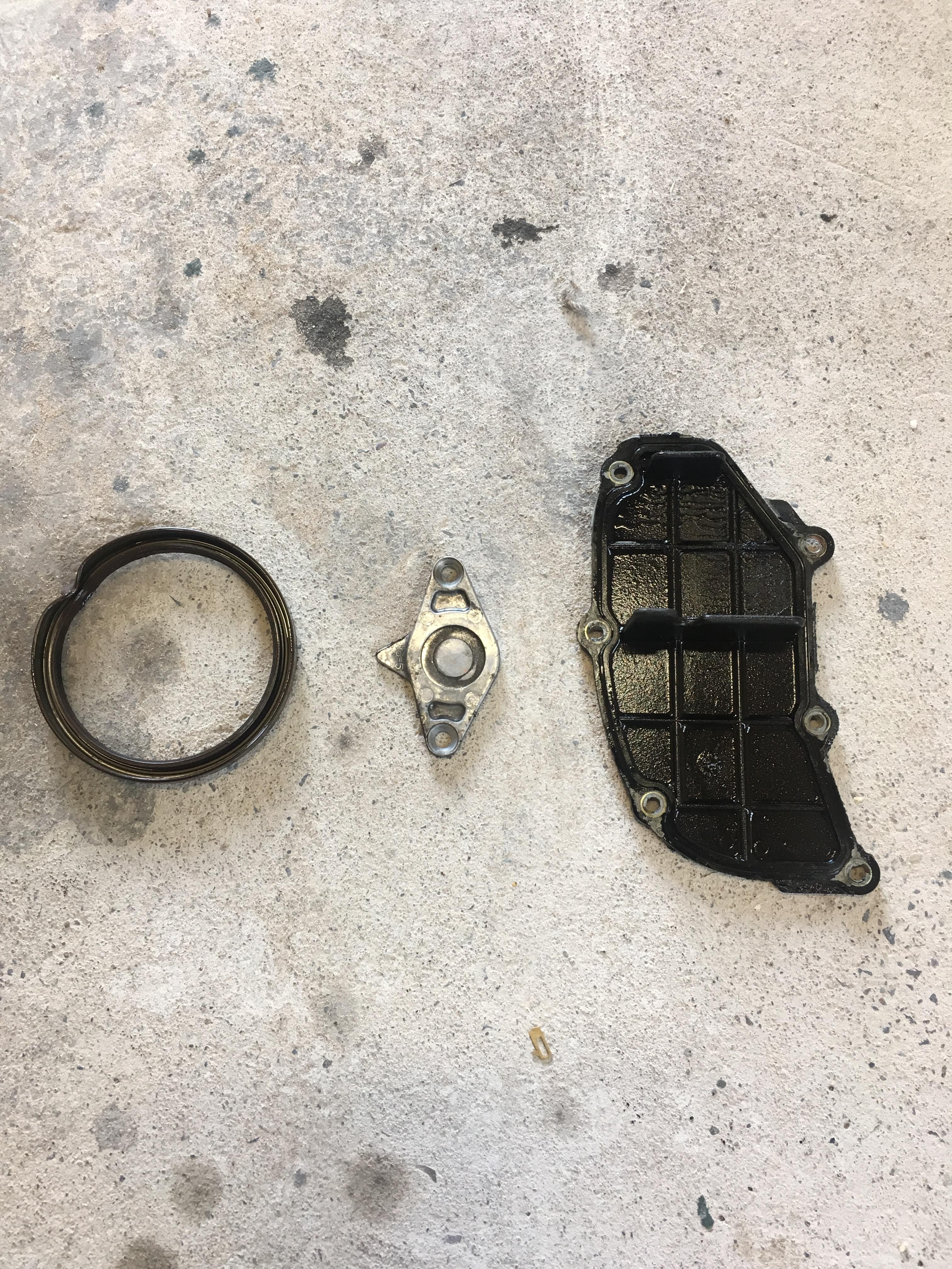

Oil seal changed, new separator plate fitted plus pin cover.

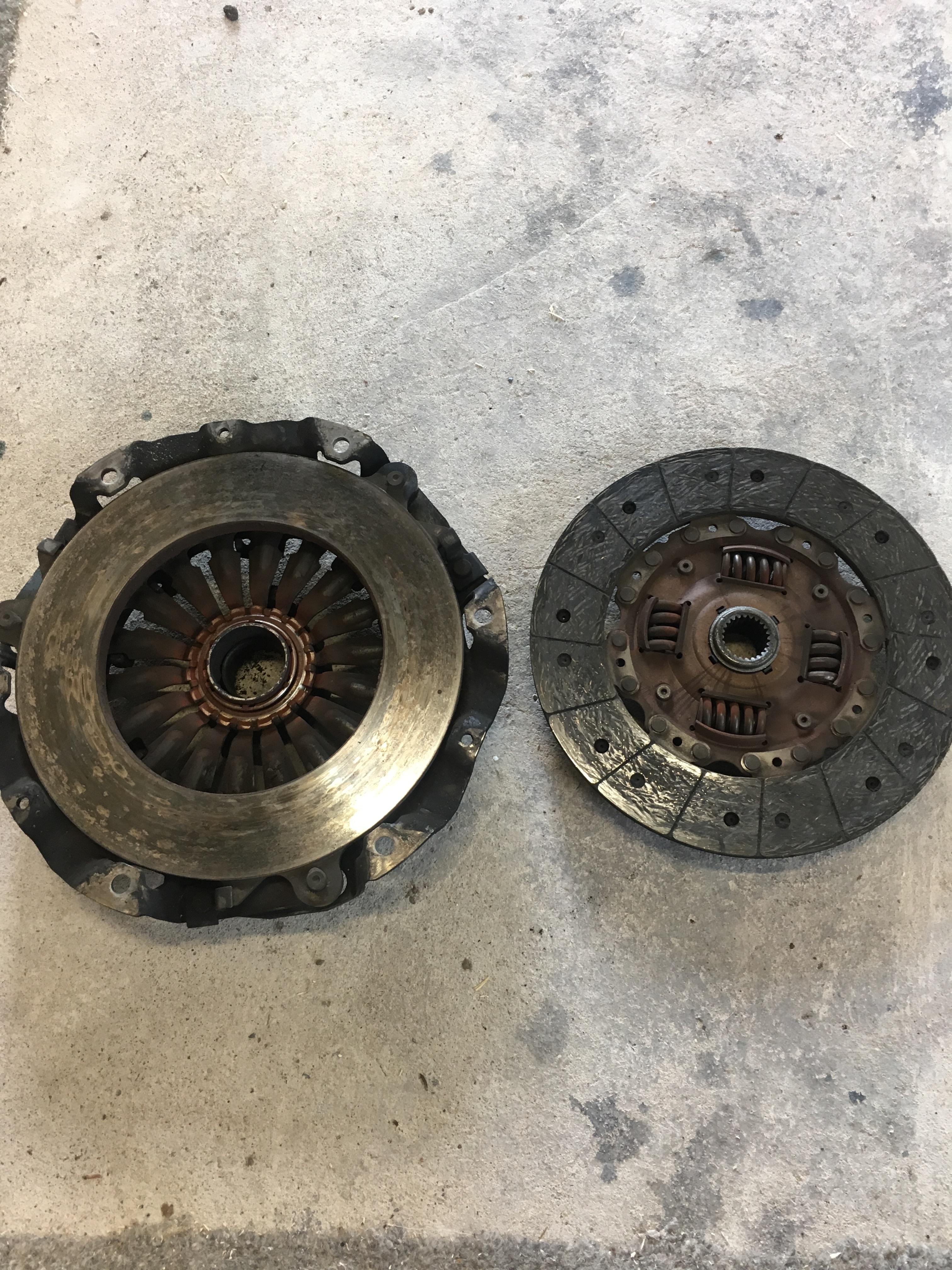

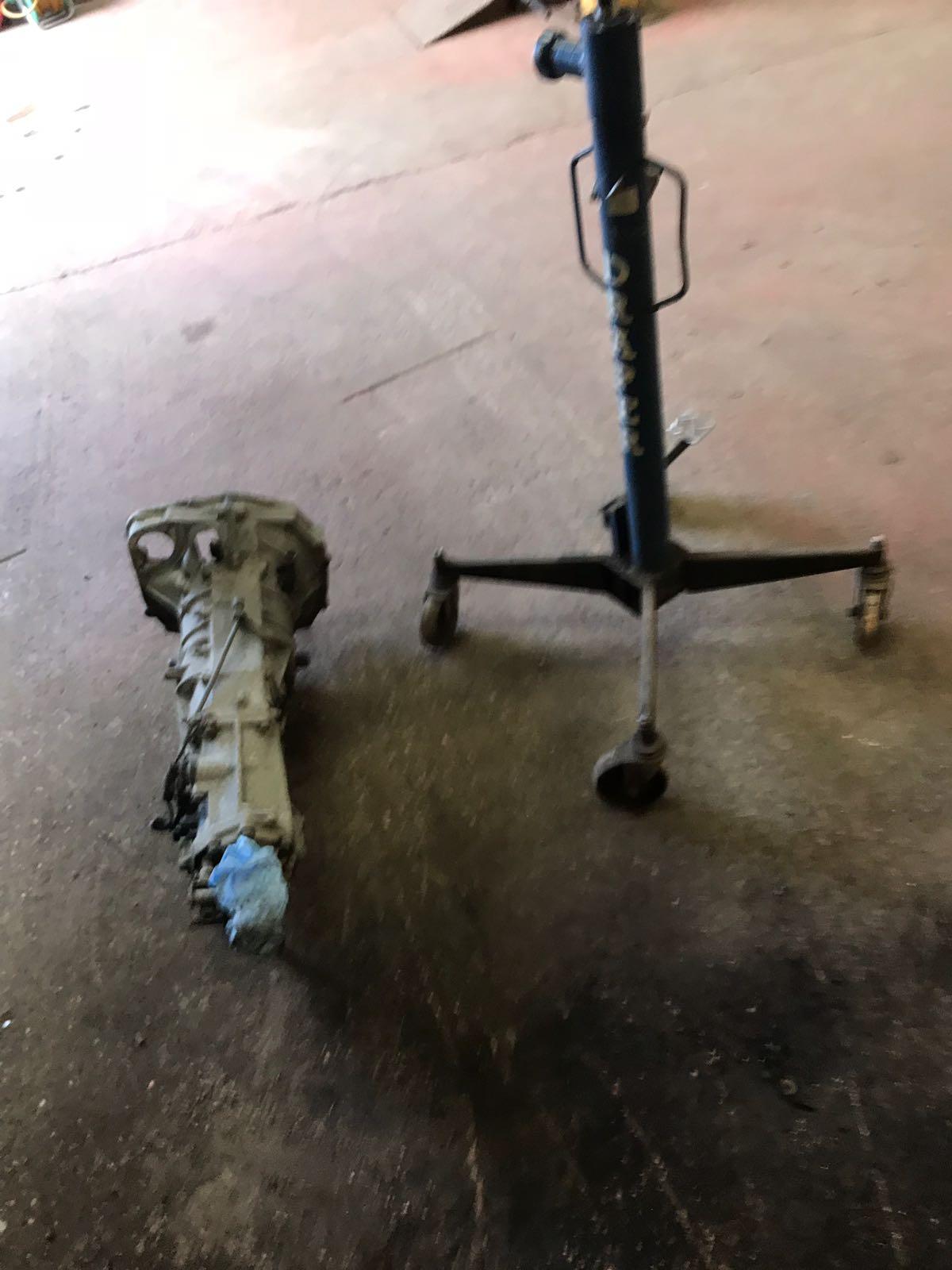

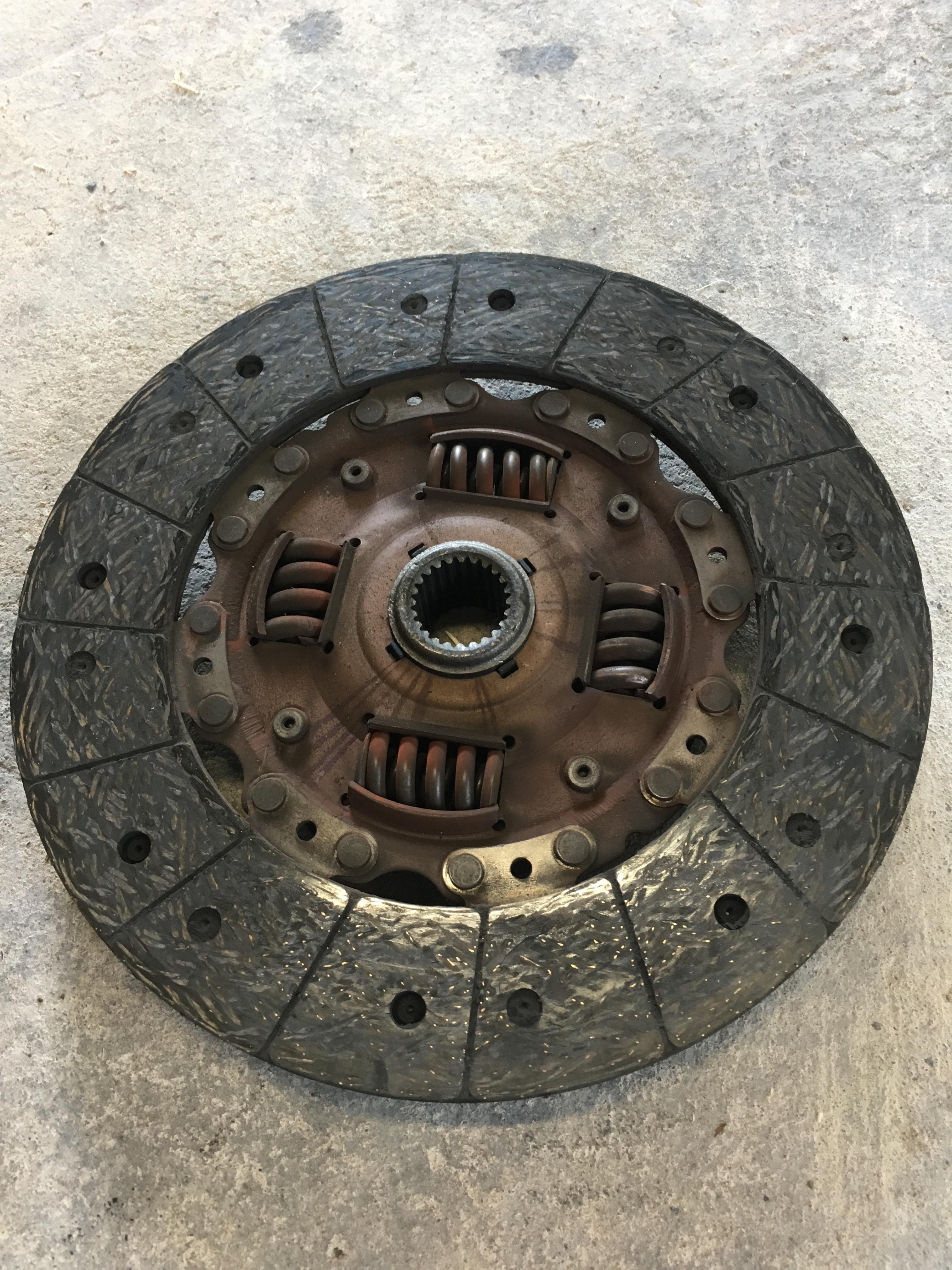

Also flushed the cooling system, which looked like river water in a flood! New gear box oil and new clutch. Big thanks to Chris Alison @ Courtfield garage Appleby.
8B475886-0509-485B-8DC7-F7474F1CC024.thumb.jpeg.bead8fdbeb17e17a342e2b07f2ed23d6.jpegFBD73842-598D-4741-9B78-05130037DDA5.thumb.jpeg.1c7454390e01693a90442e6896aa9ba5.jpegABAEE223-B918-4CFF-9B97-88150B5061BE.thumb.jpeg.e035592f28d4438d5225d3dc23771762.jpeg
I think I had my wear out the clutch!
