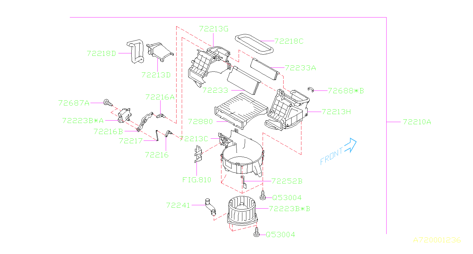

Wotcha and welcome - There is a pollen filter in the glovebox but that wouldn't give a squeak as you describe - dont know about a secondary blower
this shows the pollen filter and blower
https://parts.northendsubaru.com/a/Subaru_2010_STI-S-SEDAN-25L-TURBO-6MT-4WD/_54104_6025965/HEATER-SYSTEM-HEATER-SYSTEM-BLOWER--COOLING-UNIT/G12-720-03.html

I've also now found a workshop manual, and yes as suspected it's a single blower but uses doors/flaps to direct the air. My guess is that there's something going on with either one of these doors or a bit of debris around the evaporator.

Sounds good fingers crossed - the picture doesn't show the small rodent in place to turn the blower wheel - maybe when you are selecting aircon it is too cold for the little fella 😀
