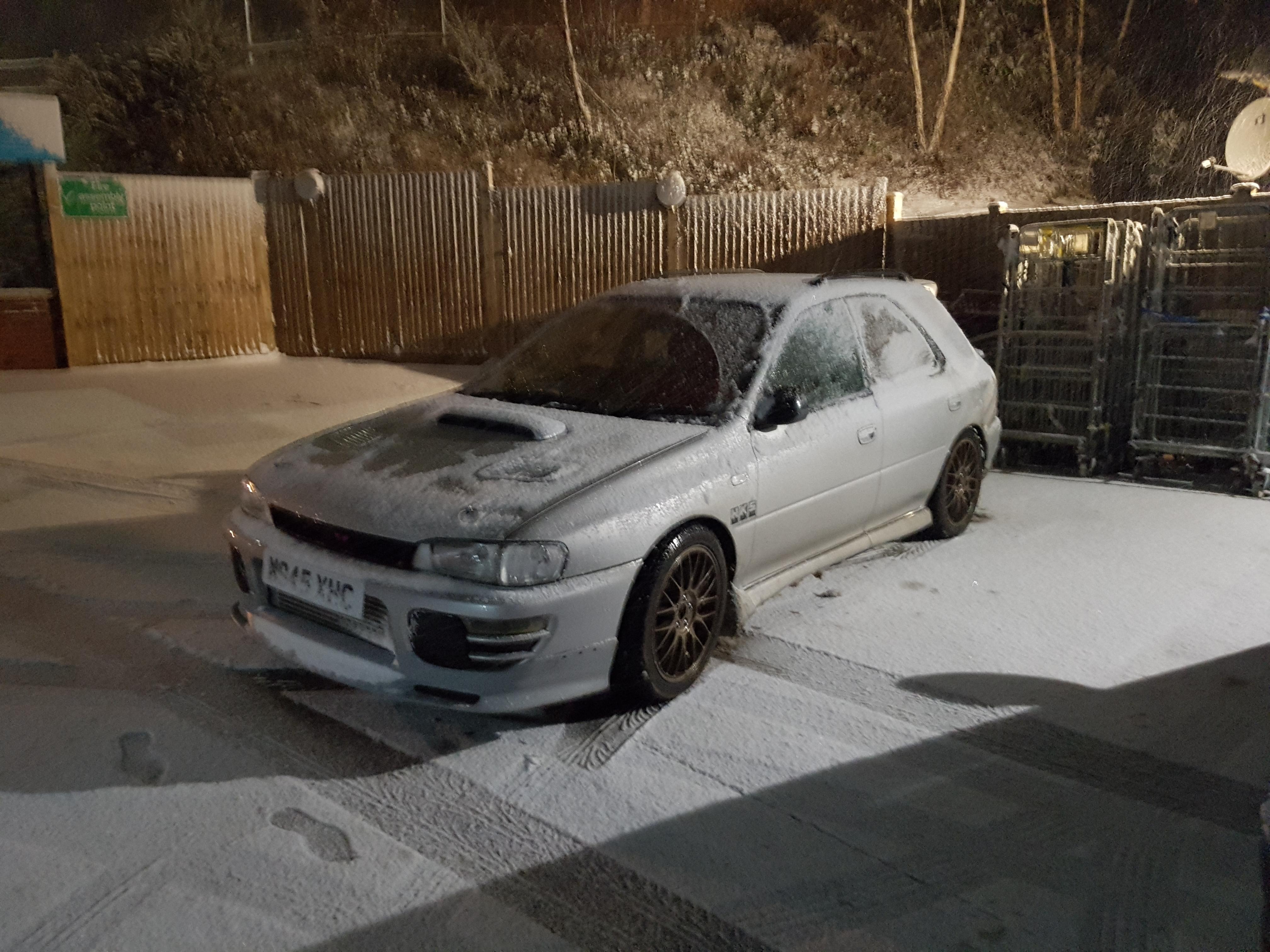

Just in case anyone is interested you can remove the rails on a classic wagon without taking the headliner out. You pop off the blanking plates and unbolt them. So the problem is you need new roof trims, after a bit of research to trims from a non turbo gl wagon can be used. So now I'm looking through breakers yards for some.
