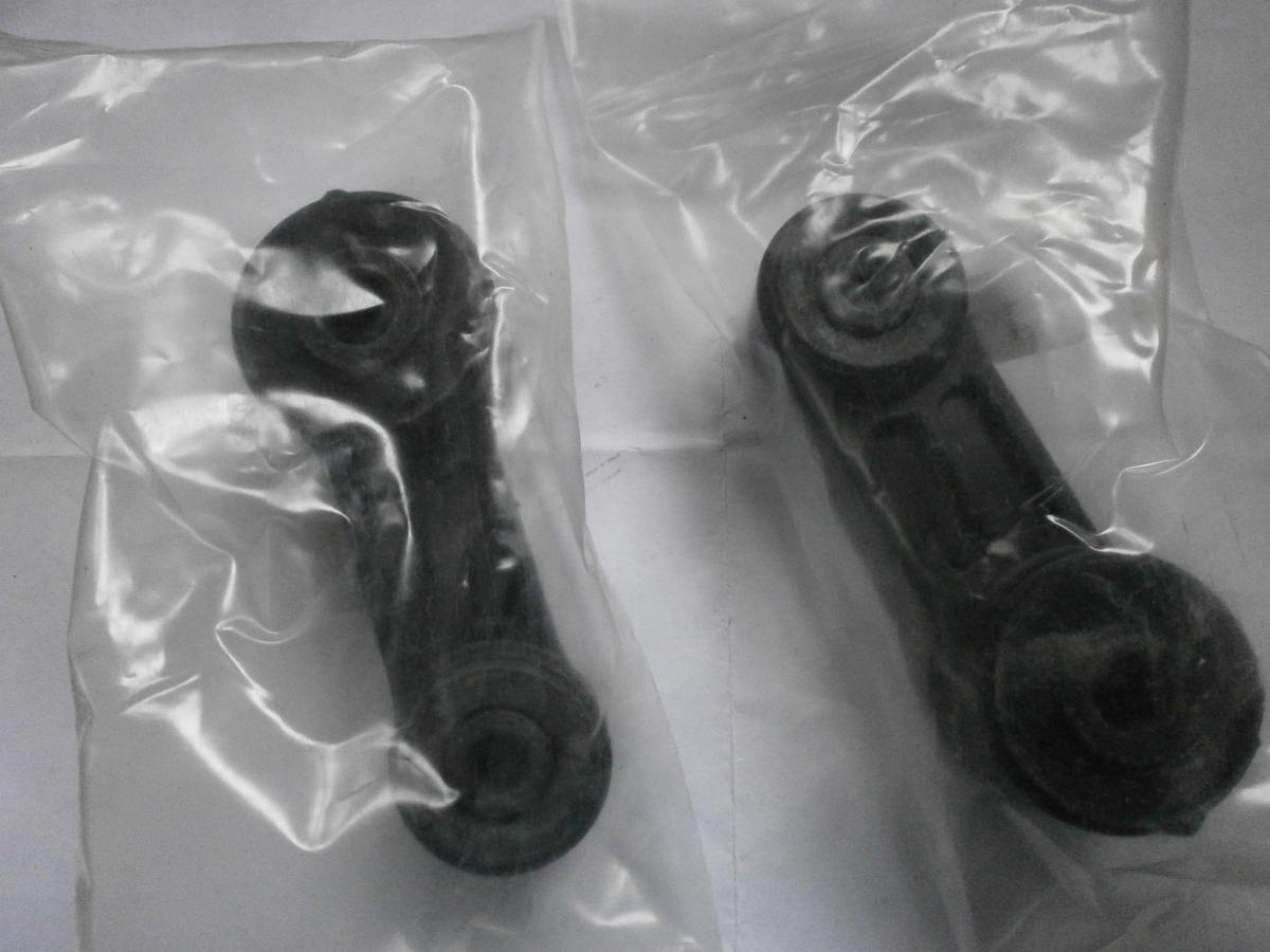

torque settings on uk wagon drop links
ive just replaced my front drop links and the anti roll bar rubbers on my uk wagon 2000 non turbo,
 what's the torque settings for the drop links cant find anything in my CD-MANUAL  that refers to my 2000 wagon, only P1'S and STI'S.
 also do you torque them when the wheels are on the floor like (old school) back in the day.?

thanks for that, did them this morning and i have to say much better.
my reason for asking was the car had developed a shaking and judder and the feel of it bouncing a couple of days after the MOT so with me thinking can't be anything serious eg ball joints ,major suspension rubbers, discs,calipers etc i decided to make a checklist of things that i had done and try and fault find via facebook scooby sites etc so i had reconditioned or bought new the following items,
new discs and pads,
reconditioned 4 pot calipers,
new brake fluid,
 M.O.T'd last week.
 no issues in the steering ,ball joints,track rod ends etc
 . the problem is a slight wobble and vibration on front end when breaking from 70mph with firm foot pedal no issues if i feather the brakes to slow down,
 stops in straight line if i let go of steering wheel.
 front o/s strut has a light mist of oil on strut body under pirch rim
 engine looks to move a little to easy on the mountings compared to my other classic.
i even swapped the wheels over from my other classic scoob same wheel but they are 7jj with 205-35-17's all matching f452 falken's  almost new.
the wheels that are on the wagon are 7.5jj  Fronts 225/45/17  michelin pilots with 3.5mm of tread
 REARS 7.5jj  225/45/17 continental 2 run flats with 5mm of tread all balanced last week all with even tread wear
.the struts are std uk 2000 wagon spec and they are a tad soft. when driving the front of the car feels odd but i cant put my finger on whats at fault.
The suspension will be swapped over next week for a set of adjustable open purch ohlins with matching springs. thats if i can fix the vibrating and shimmying its doing.
SO  as of today lets re-cap on morning judder,vibration and shaking on my classic 2000 uk wagon
 i have now replaced the front drop links and the D bushes on the anti roll bar with totally new std items and am glad to say most of the shaking and vibration  has gone the rest might be down to the weeping strut and the tyres being worn down to 3.5mm on the fronts. the braking judder has almost gone now very slight almost not noticeable.
 So people if you had any of the symptoms try the above it could work for you too next week its OHLINS TIME anyone had a set ?

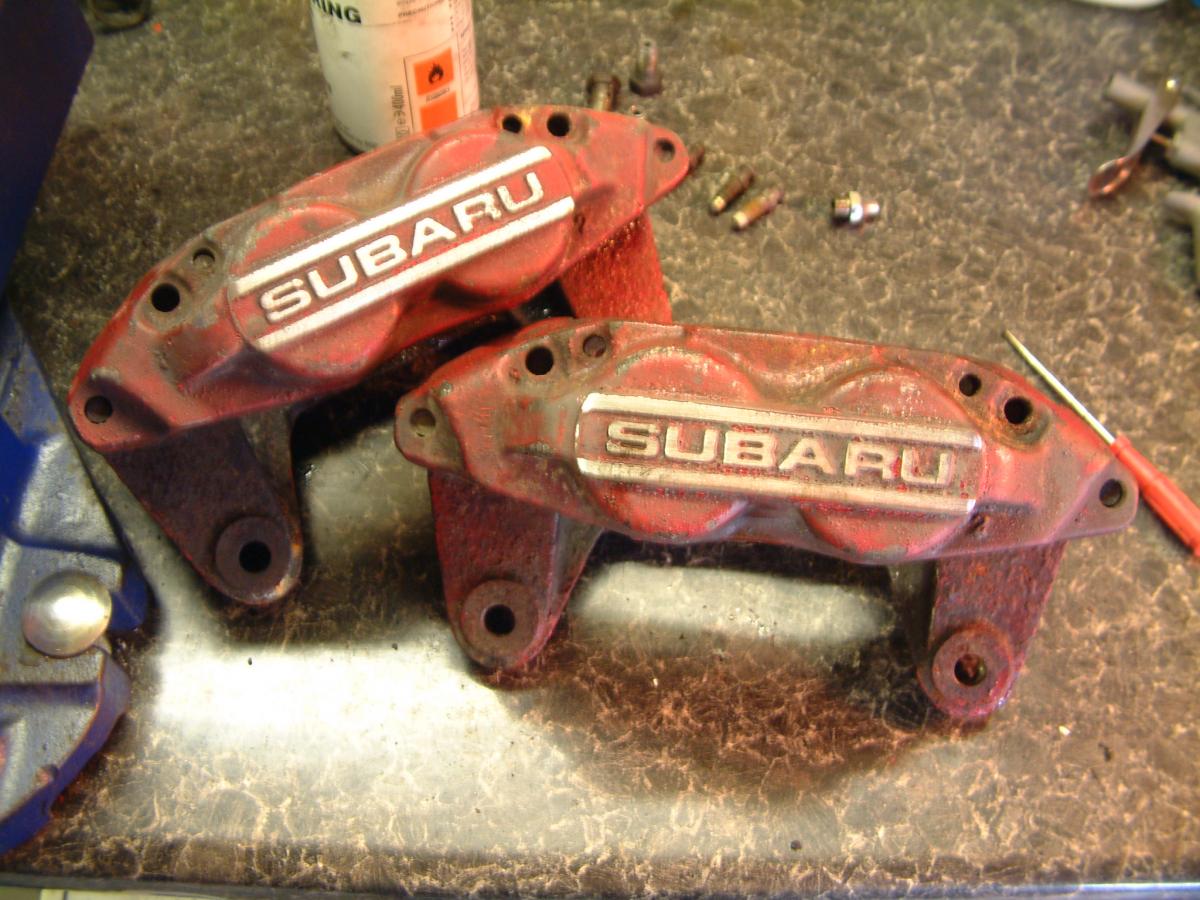

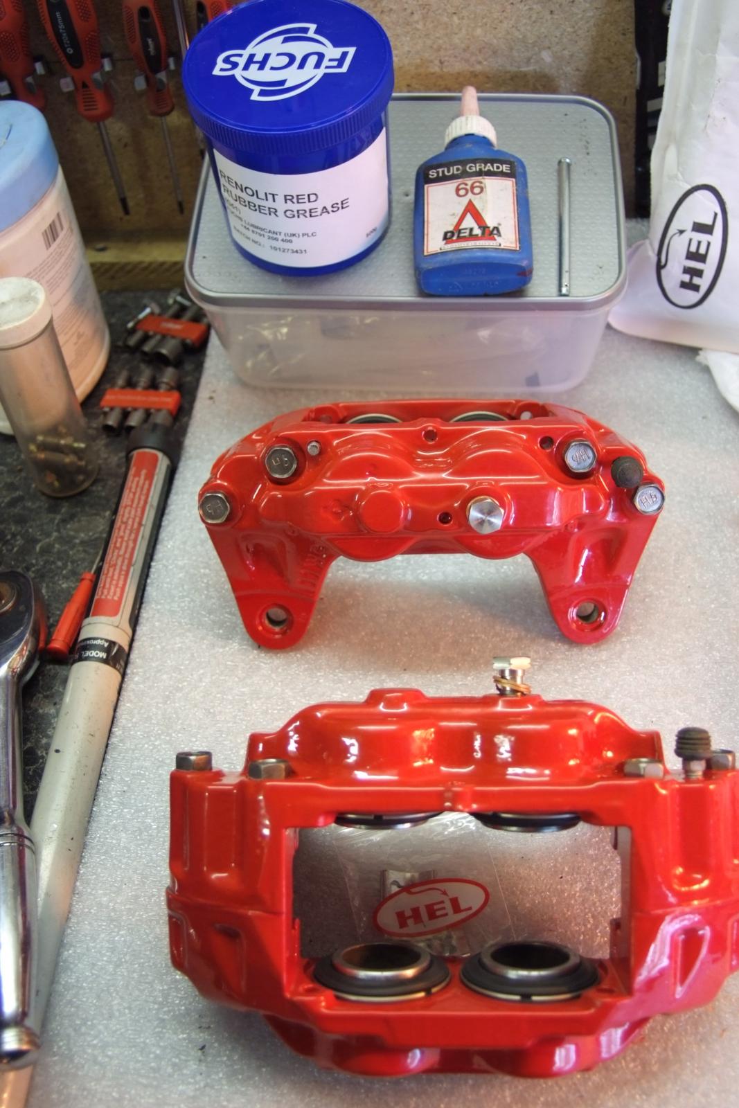

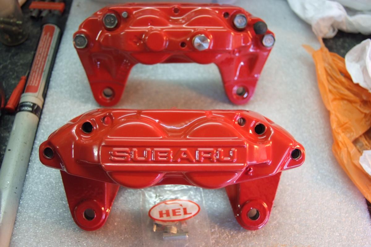

i can do the 4 pots if they need reconditioning,
  just doing some now  post-1114-0-52010700-1380328431_thumb.jp and i can get the HEL brake hose to match

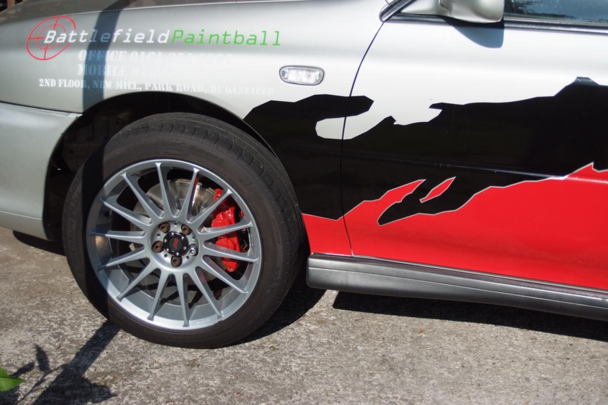

these are the ones i have on the wagon, post-1114-0-79062200-1380328384_thumb.jp
  before post-1114-0-15186500-1380328500_thumb.jp  and fitted to car post-1114-0-90510900-1384016881_thumb.jp

Going to rip the alloys off tomorrow and see what's what I may need them doing so might have to get a price. :) but might have to have ago myself. :D

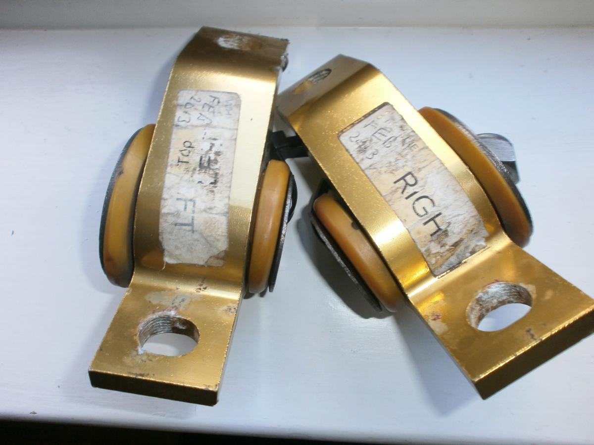

  the culprit we think was the rear control bush :angry:  that bolts to the body,
  the garage guy said who's ramp i was under at the time. the control bush isn't a MOT failure but it has some play (a lot) so i replaced them with (WHITELINE )
  so now its fit ohlins , refurbish wheels and fit new tyres..

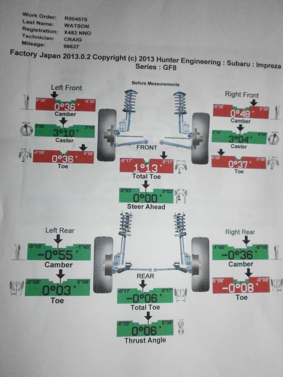

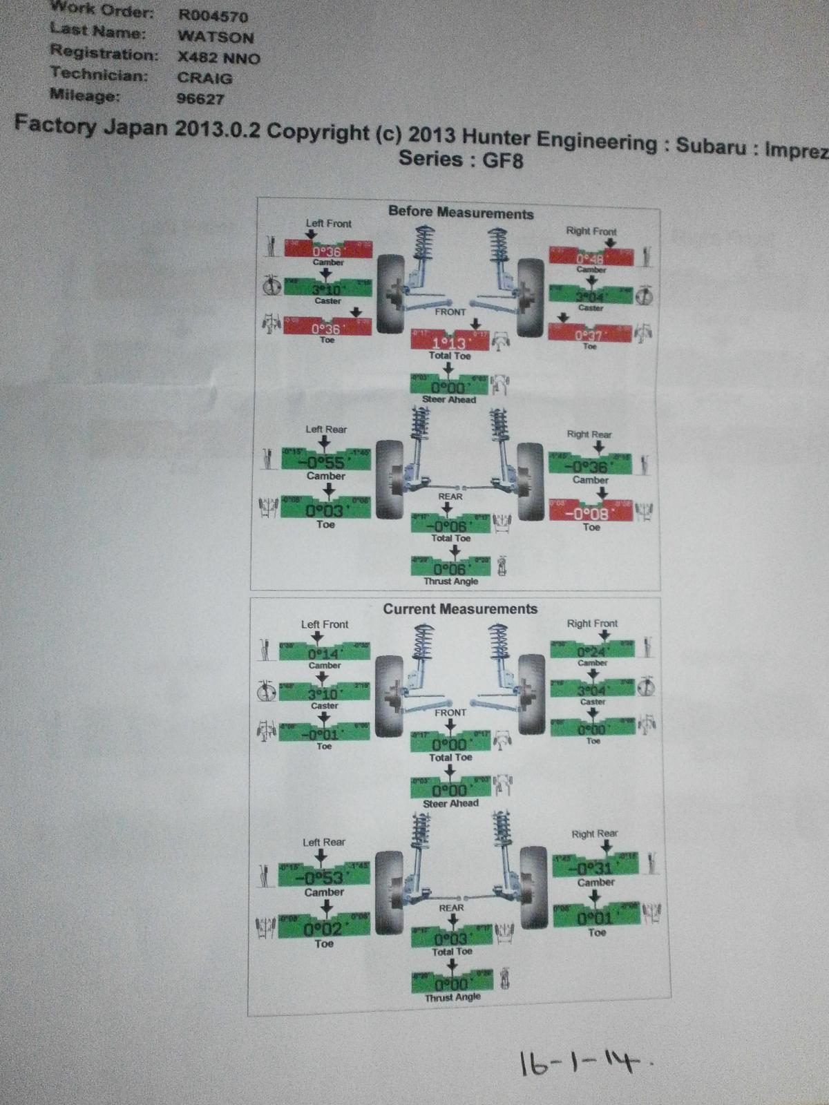

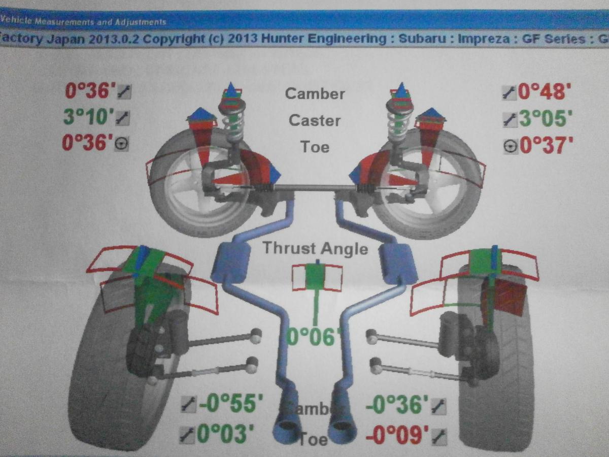

     and  i fitted the OHLINS  adjustable's  and now knowing they will for sure be out of alignment i hunted down (4 wheel aliment ) local to me.
    THE GARAGE DRURY LANE,OLDHAM.
     was the destination yesterday and 90 mins later i had a car with all 4 wheels doing in the same direction......
  it cost £40 to put it on the machine and if its just a tweak it needs that's all you pay but in my case it was a little more involved.
  1 post-1114-0-01231600-1389978963_thumb.jp  as you can see in the 1st  attachment you get a print out of before  adjustment made. the RED box indicates out of alignment and GREEN means OK.
   2nd  post-1114-0-06342100-1389979238_thumb.jp shows  where my wheels were pointing  (not literally )
  3rd (attachment  post-1114-0-10490800-1389979765_thumb.jp start and finished result.
 i can now say ive found a garage that know what there talking about,
