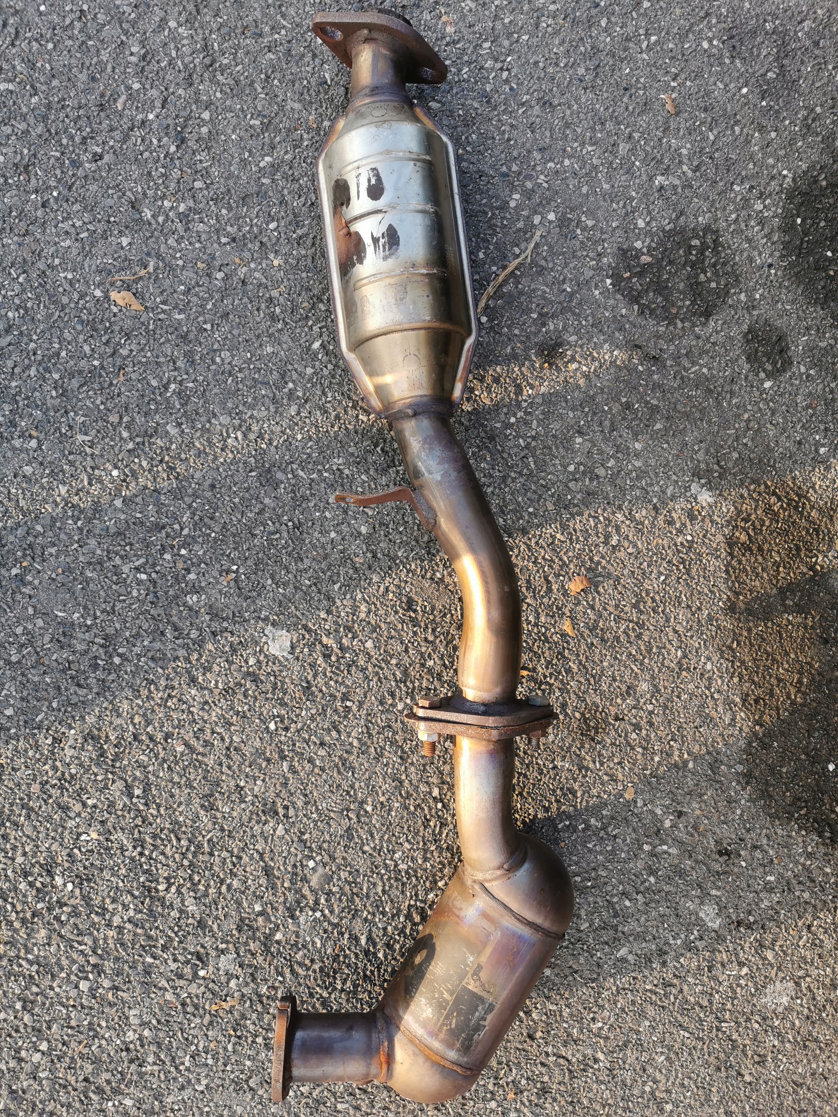

Wondering if anyone can help me identify the correct model this cat fits, bought it for my 1999 impreza wagon sport, fittings slightly off and knocks on the footwell when on, trying to sell it on but need to know what it actually fits, tried contacting the company i got it from but they have not been helpful and insist its the correct cat for my car, which it cannot be... Was wondering of any of you know what this actually fits?

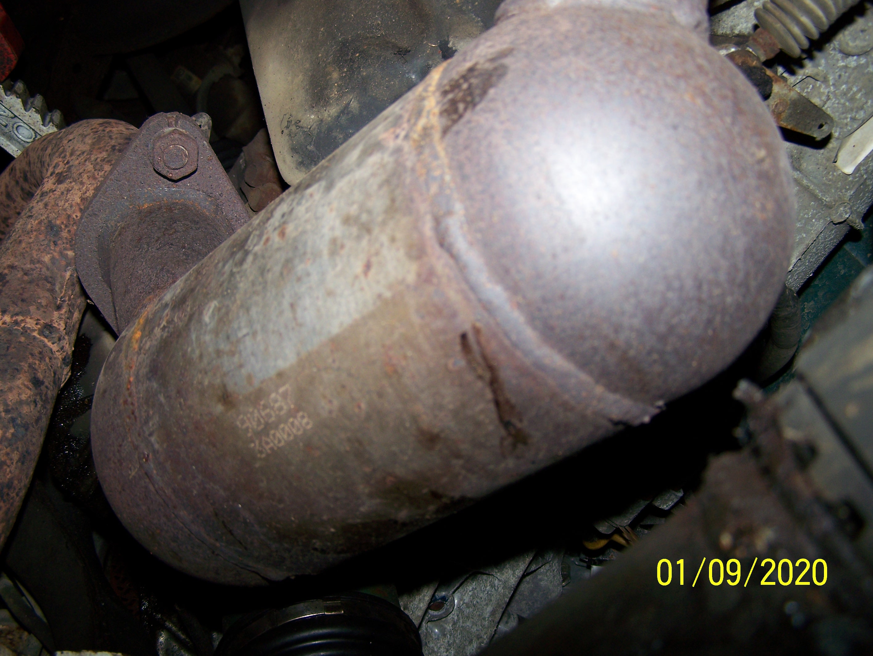

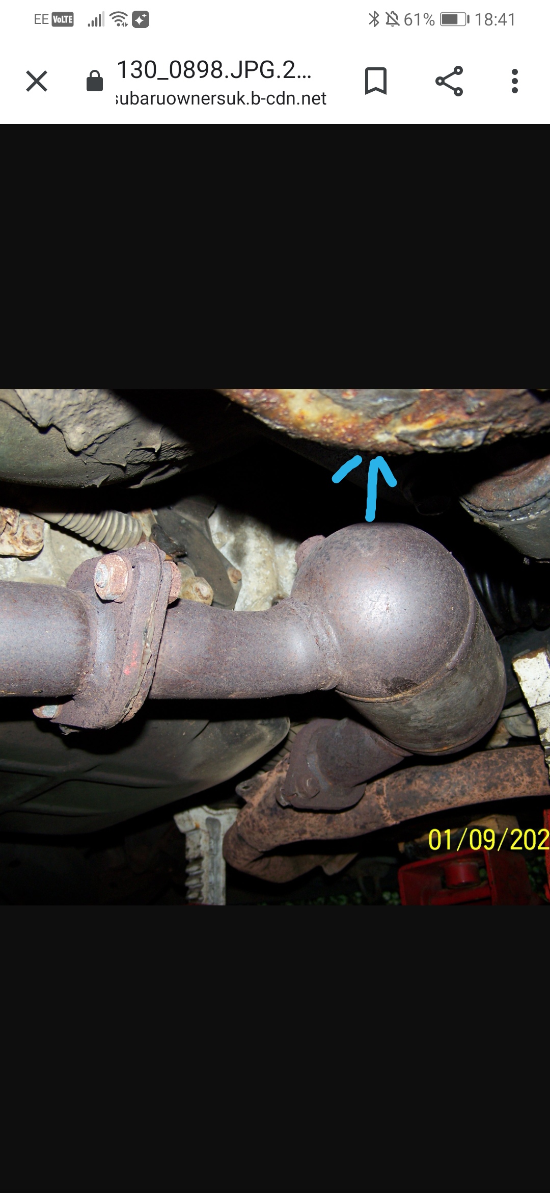

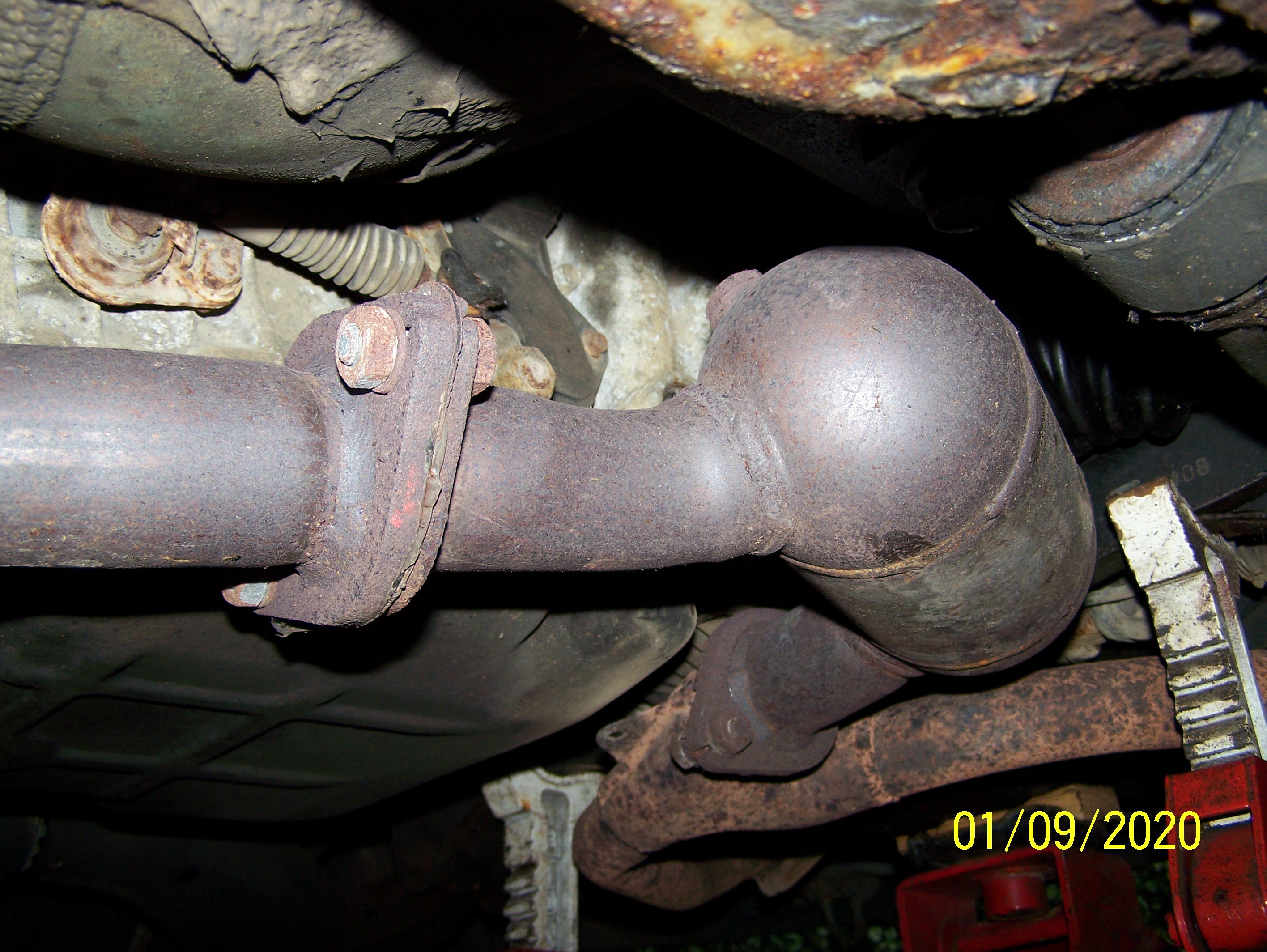

this is similar to mine on my gl 1998 model...3rd picture has numbers on it
Yeah looks just like it, fitting simular also but when on my wagon which is the same model as yours it knocks on where i have pointed the arrow towards...

Must be slightly different, whenci put yours into fitment it says its a no go, but looks likeni have figured it out, it fits some legacy and forrester models but not the impreza... Thanks for you help...
