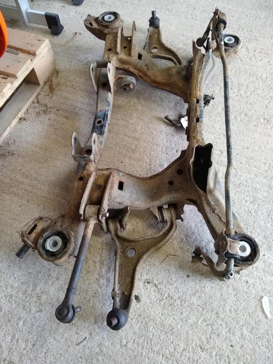

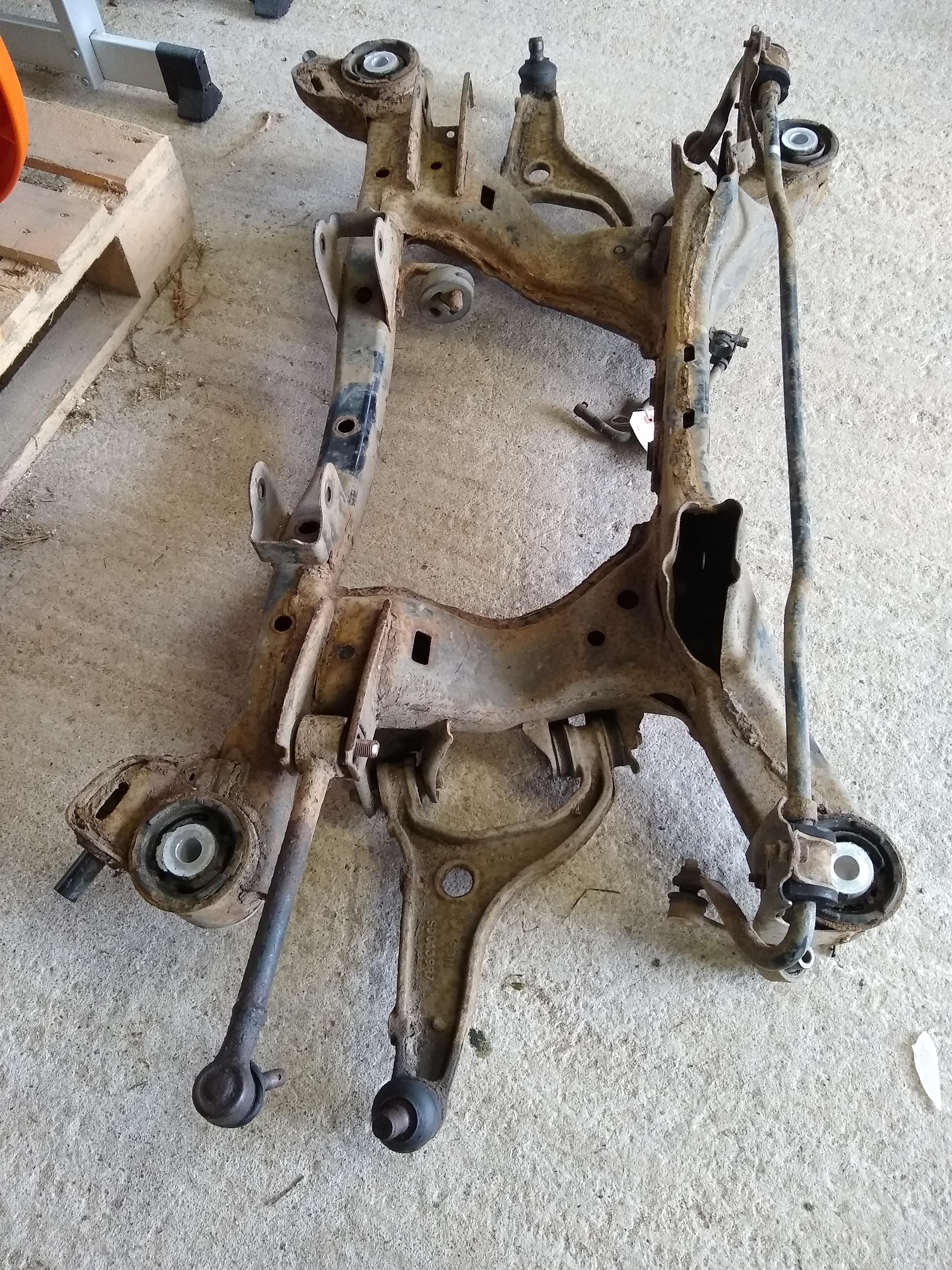

Devon Posted November 10, 2021 Author Report Share Posted November 10, 2021 Just wanted to follow up with what I've started! I picked up a rear subframe from Used Subaru Parts in Devon this morning. It's from a car with ~60k miles and is in much better condition that the one in my car (which started life in Scotland). There are a few bits I'll still need from a dealer if the parts already on my car can't be moved over. Time get wire brushing and wax oiling before I ask someone to fit it for me. 1 Quote Link to comment Share on other sites More sharing options...

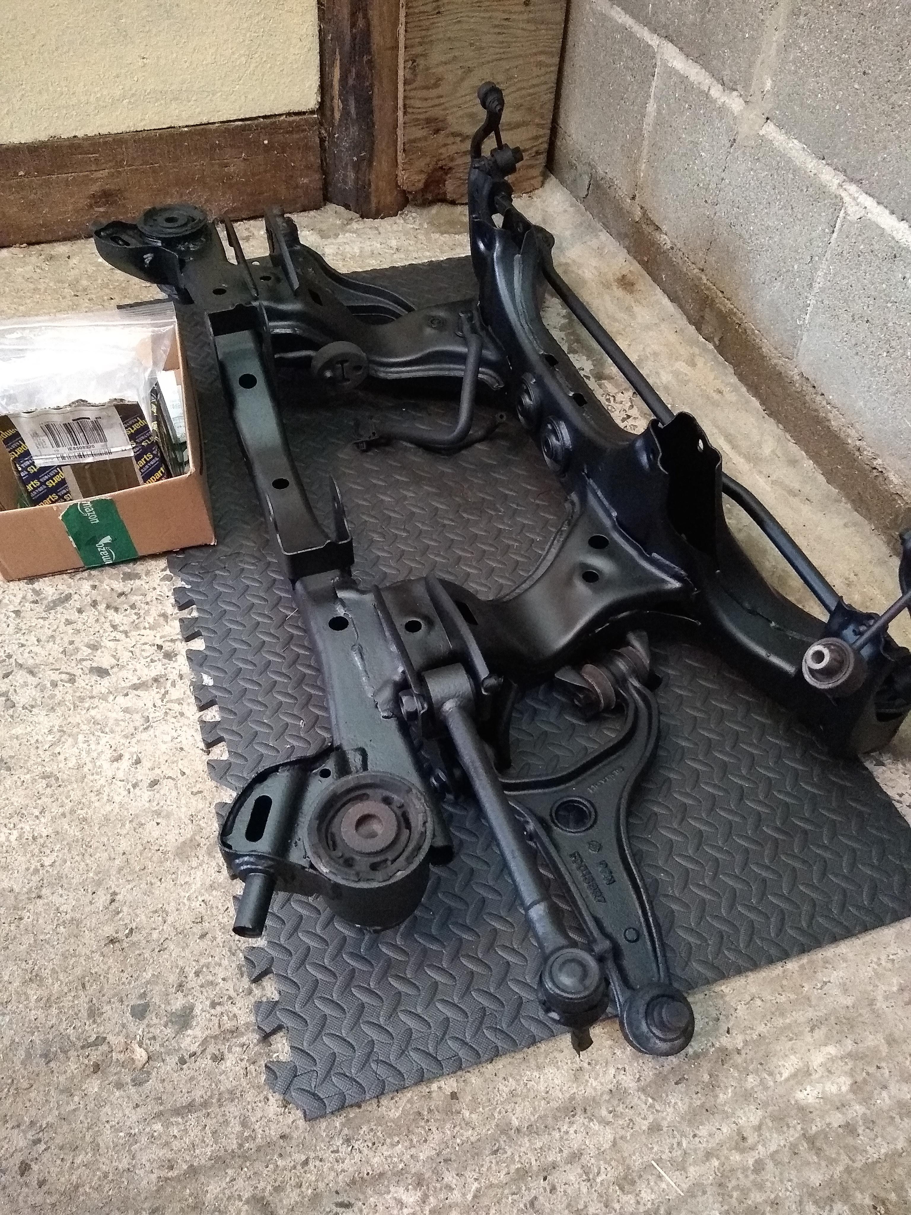

Devon Posted December 23, 2021 Author Report Share Posted December 23, 2021 Update on the rear subframe.... After buying lots of brass wire wheels to take off the rust, I decided having someone shotblast it would be much easier and end up with a better job. £50 later, I had a clean subframe. I've sprayed it inside and out with Dinitrol and bought a whole set of new bolts from ICP. Just need to wait for the local garage to fit it in the new year. 2 Quote Link to comment Share on other sites More sharing options...
