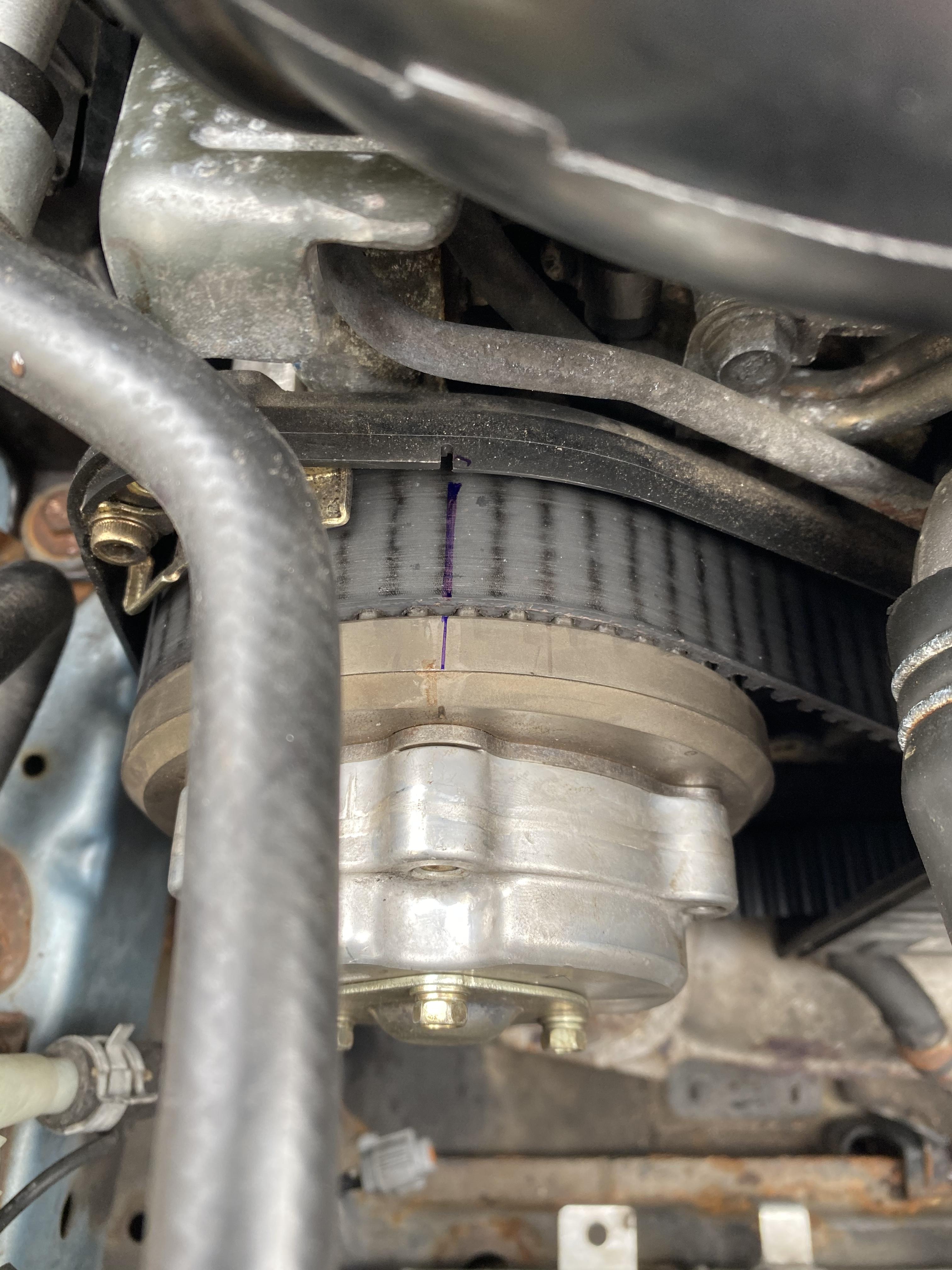

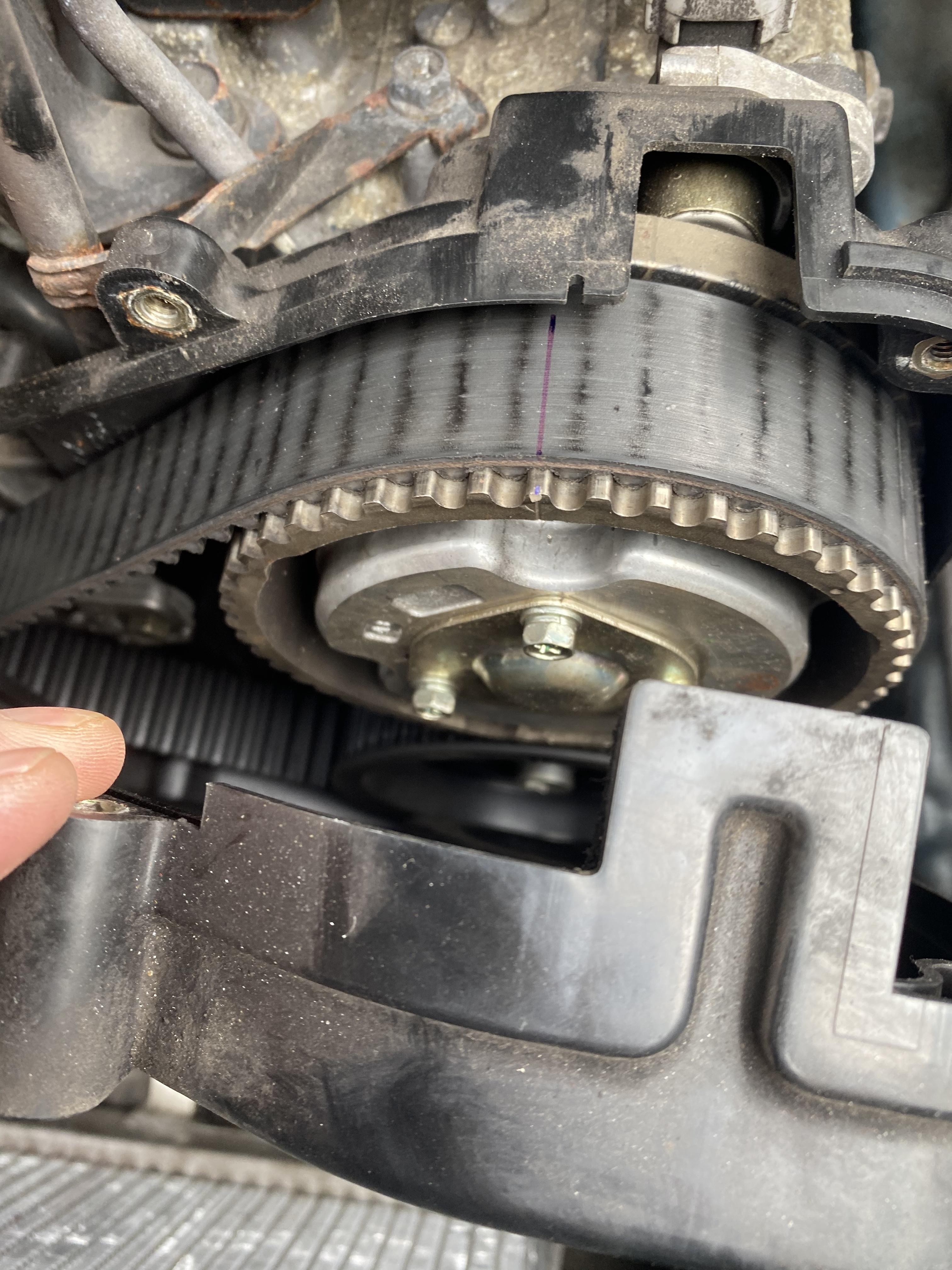

  • check the timing. I have done this for it looked slightly off, but was told this can be quite normal. I’m not too sure. Have a look for yourself
    Bank 1 aligned correctlyACB81217-01B1-4C63-BAB9-2FC49BE0D7DB.thumb.jpeg.a82b8cfd591fe122e64506e2fed386db.jpeg
    Bank 2 slightly off
The cambelt was put into be replaced 2 years ago, but on looking at it, it looks a lot older. I am thinking that the garage that did the job may not have done so, therefore, the belt and the tensioner may not have been changed. If the timing is out slightly, would this not throw a fault in the cam position?
as I said, I am clutching at straws and I want to drive the car without the dreaded engine light coming on after driving for a few minutes.
