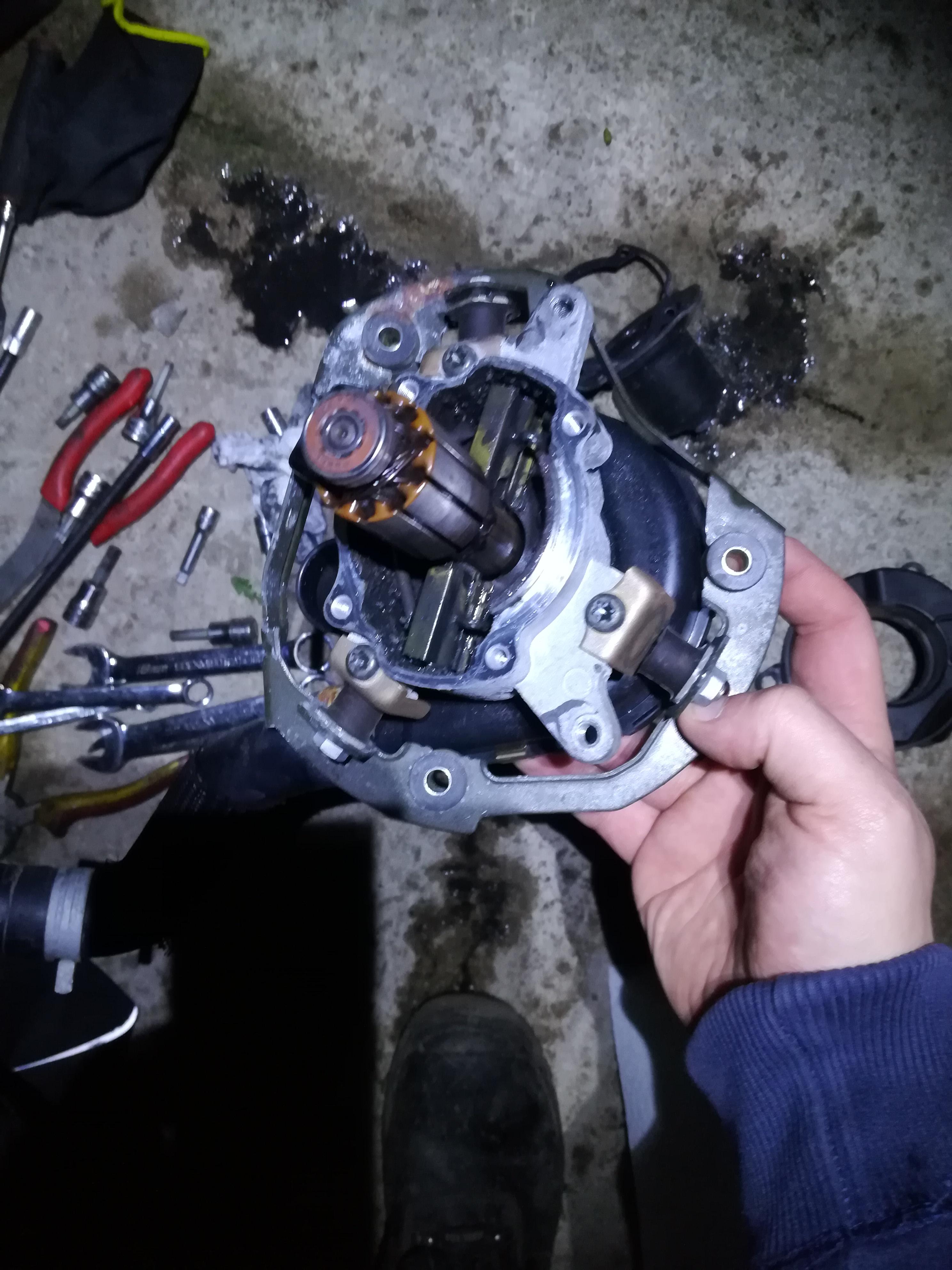

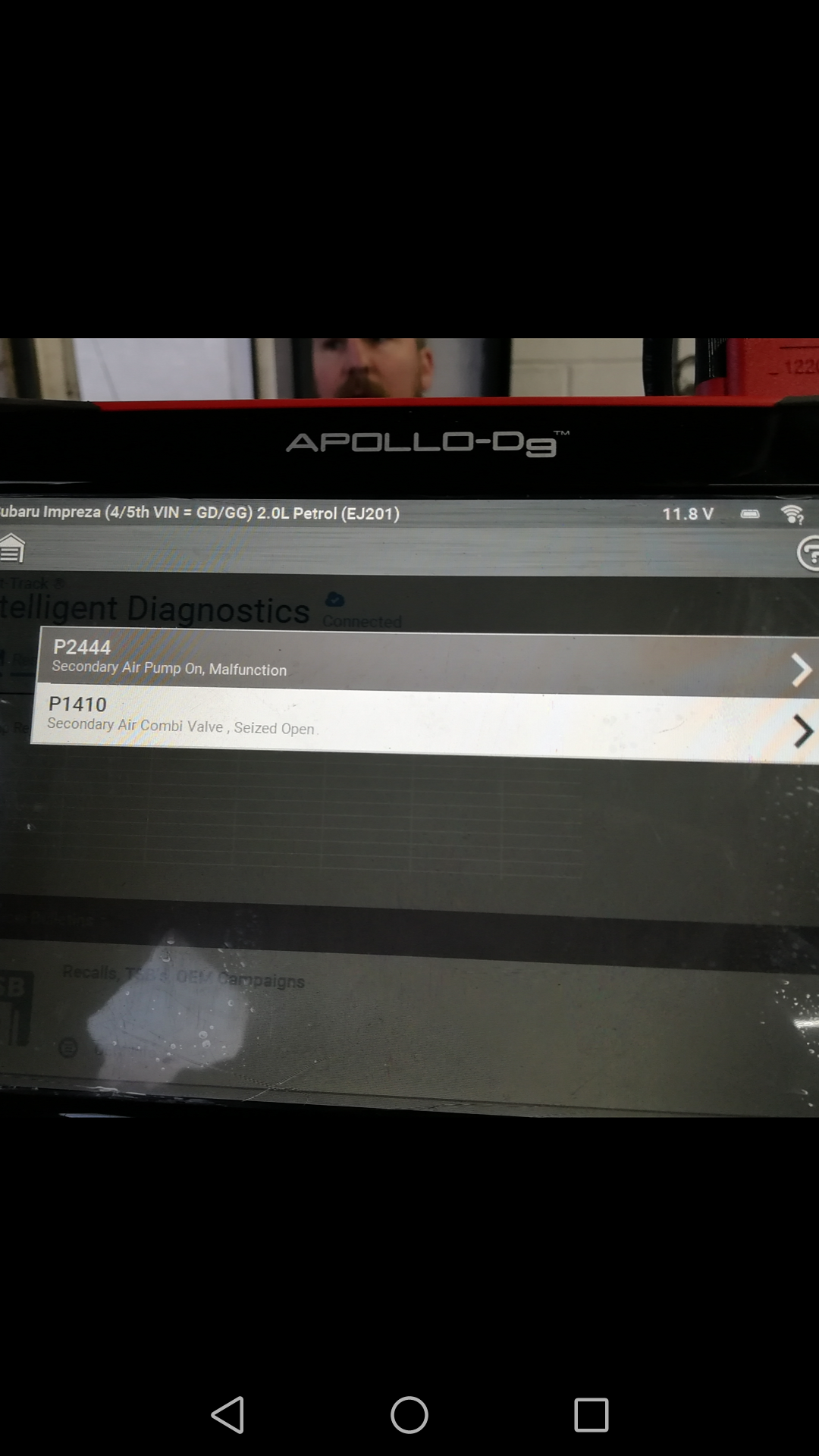

 Hi all I Removed secondary air pump and cleaned it out, dried it and re greased the inside as you can see it was clogged up and submerged with water, pump working fine now as eml light was on and also checked 1 of the 2 combination valves, as come up on diagnostics test, the secondary air pump and valves seems to fail and are a common expensive problem, even when replaced, reviews and write ups confirm this, the eml has stayed off but if it comes back on, can i have a secondary air pump delete eml codes deleted from a garage without tuning as want to keep the car as standard as I can?
