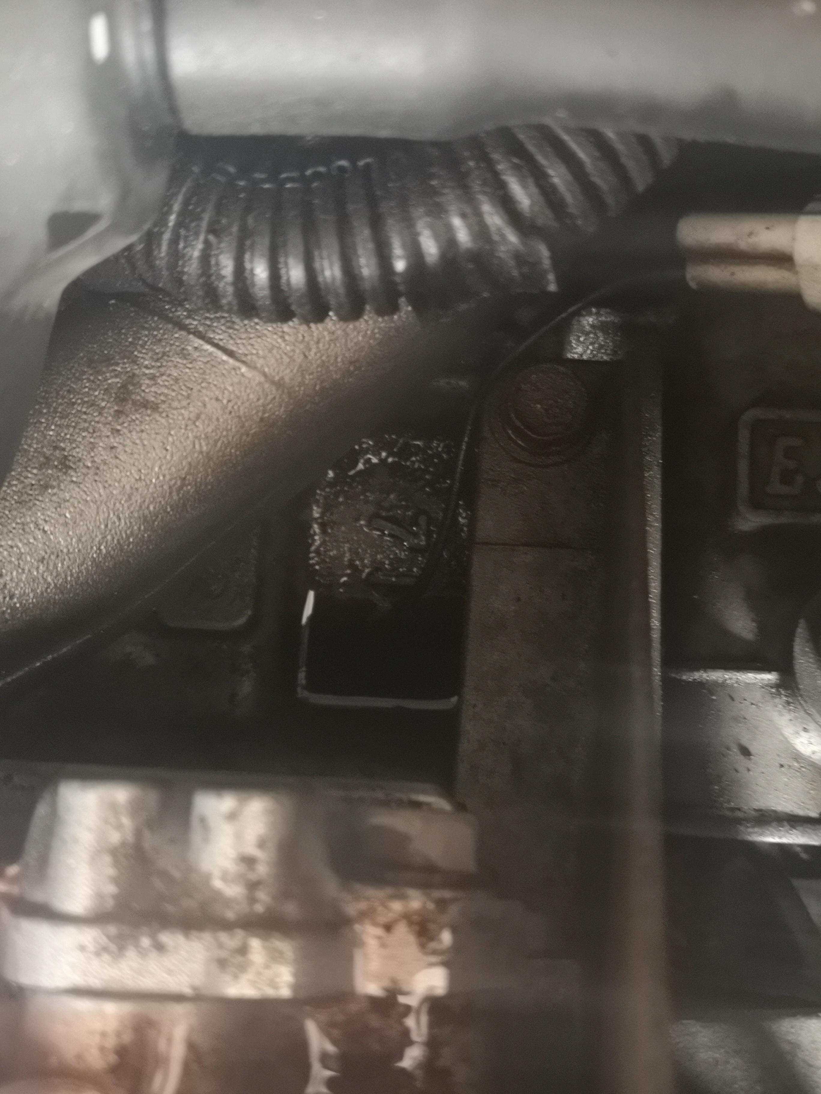

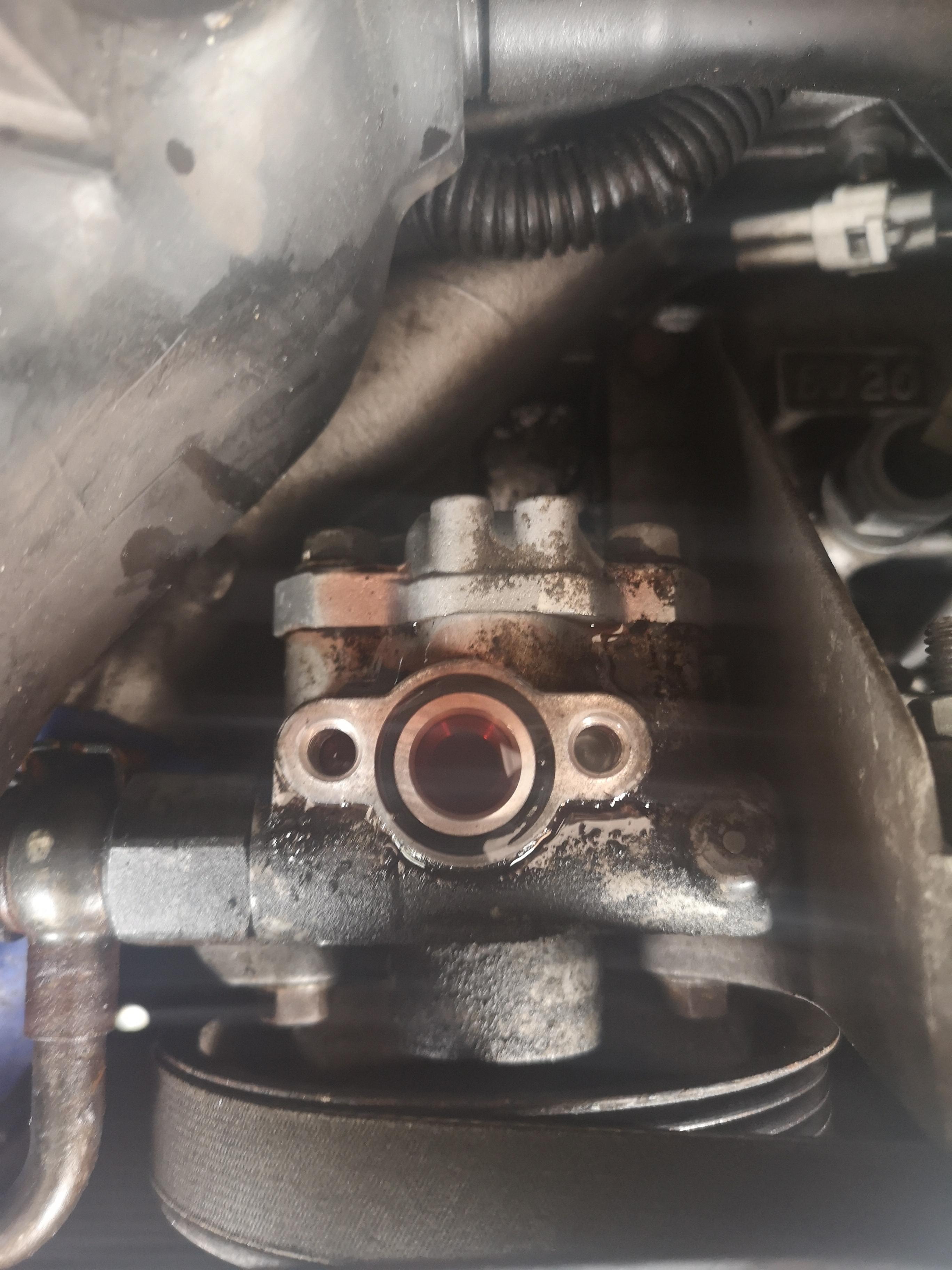

I have noticed a leak of power steering fluid from around the pump, I can't see anything obvious, banjo bolt is tight, can't see any flow of fluid. Is there a place where it commonly leaks from?

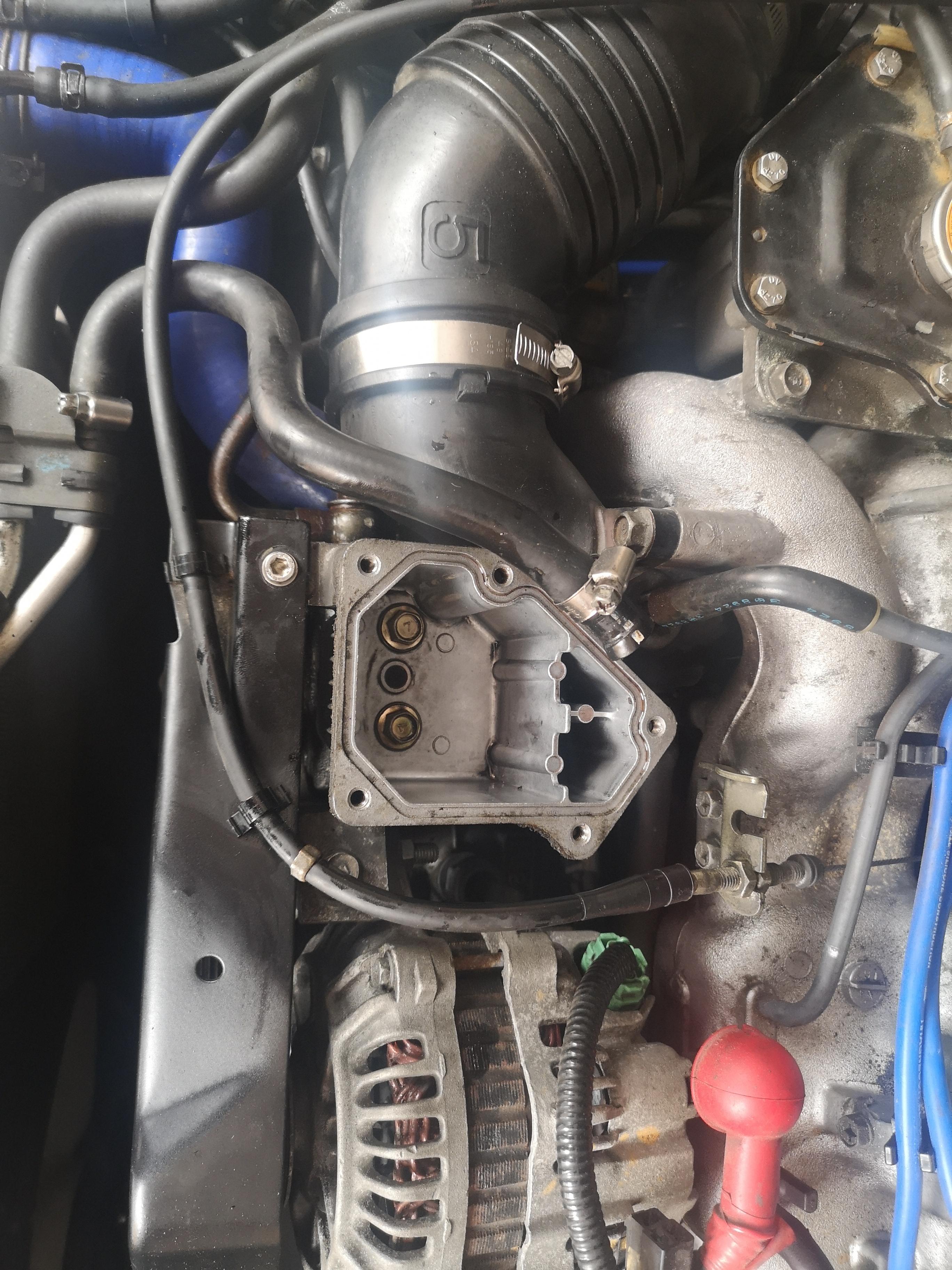

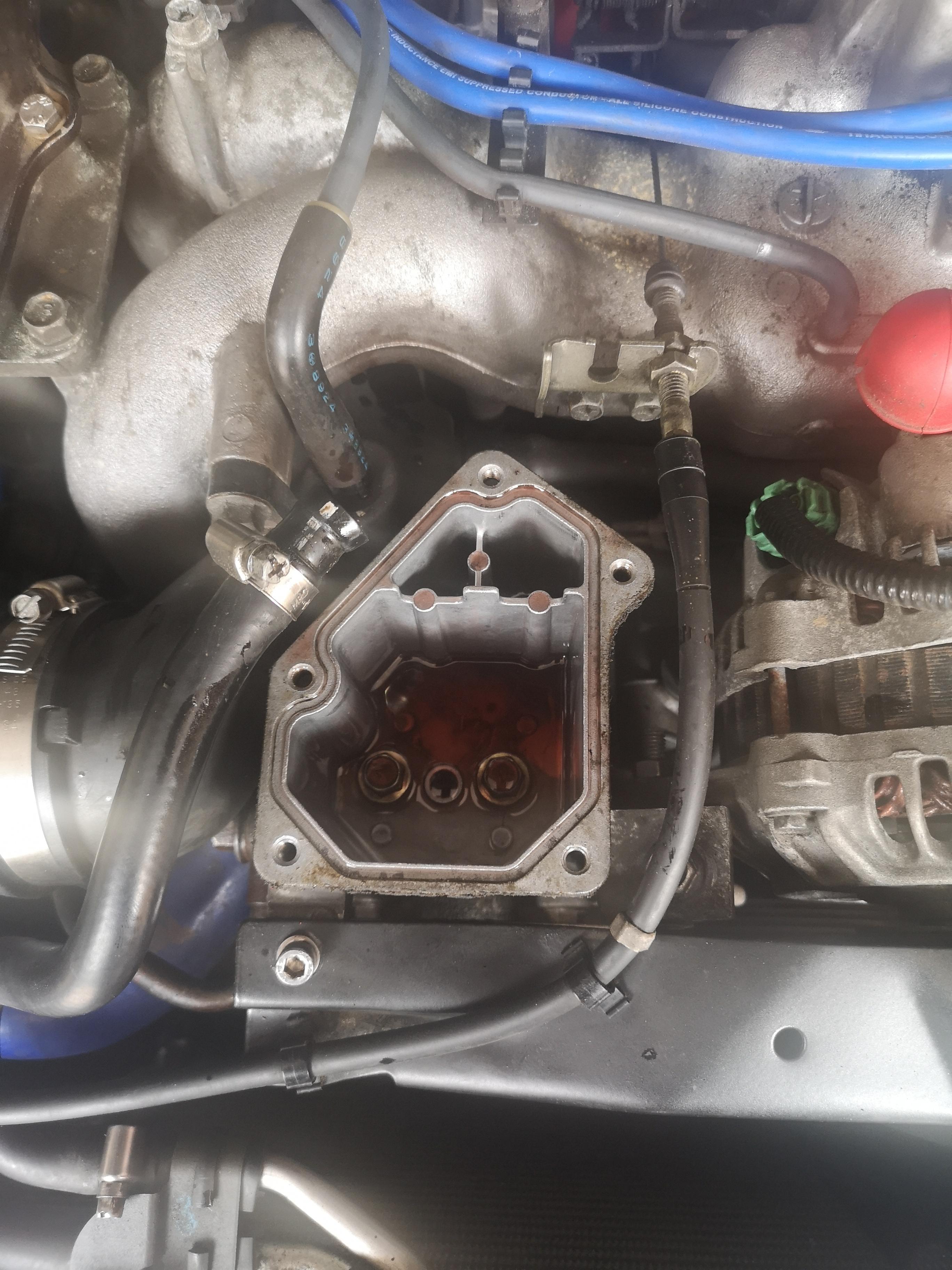

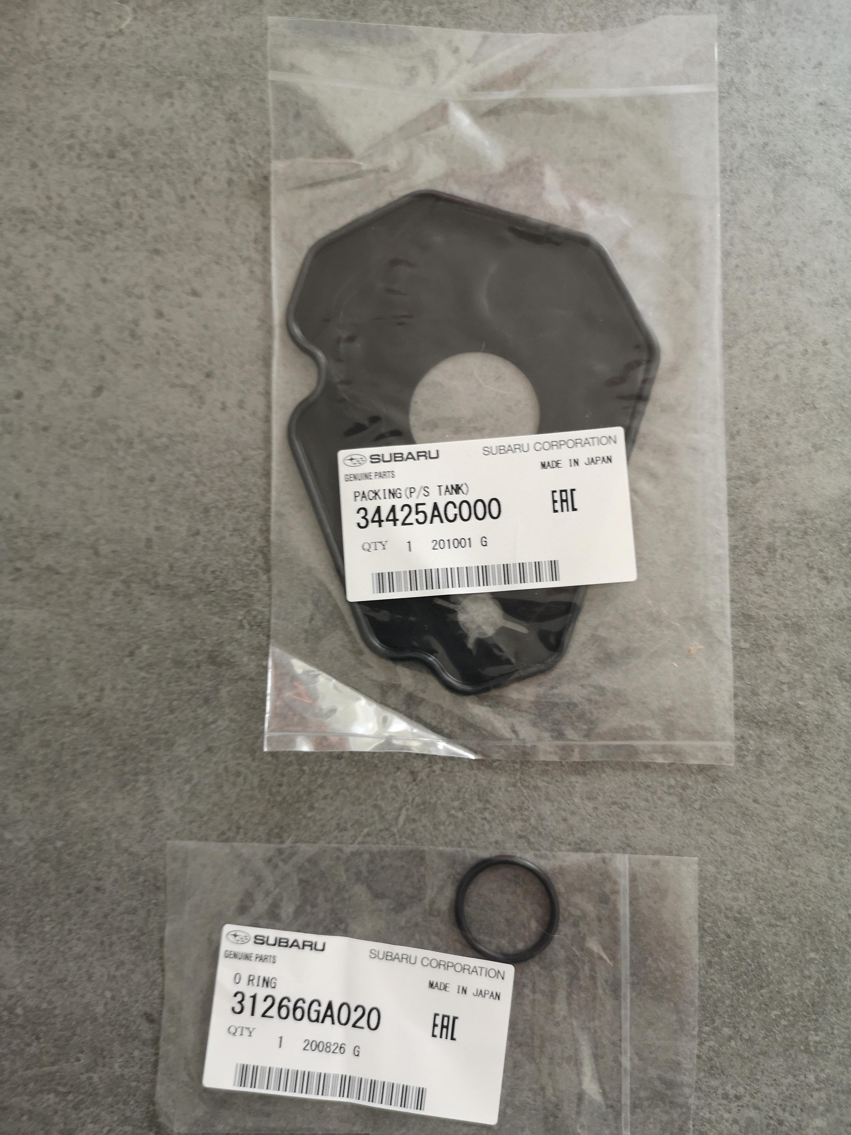

Hi mate
I had a similar problem. There is an O ring between the pump reservoir and the pump itself that can be the usual culprit.
Hope you manage to get it sorted ok.
Cheers David, I'll get onto that 😊

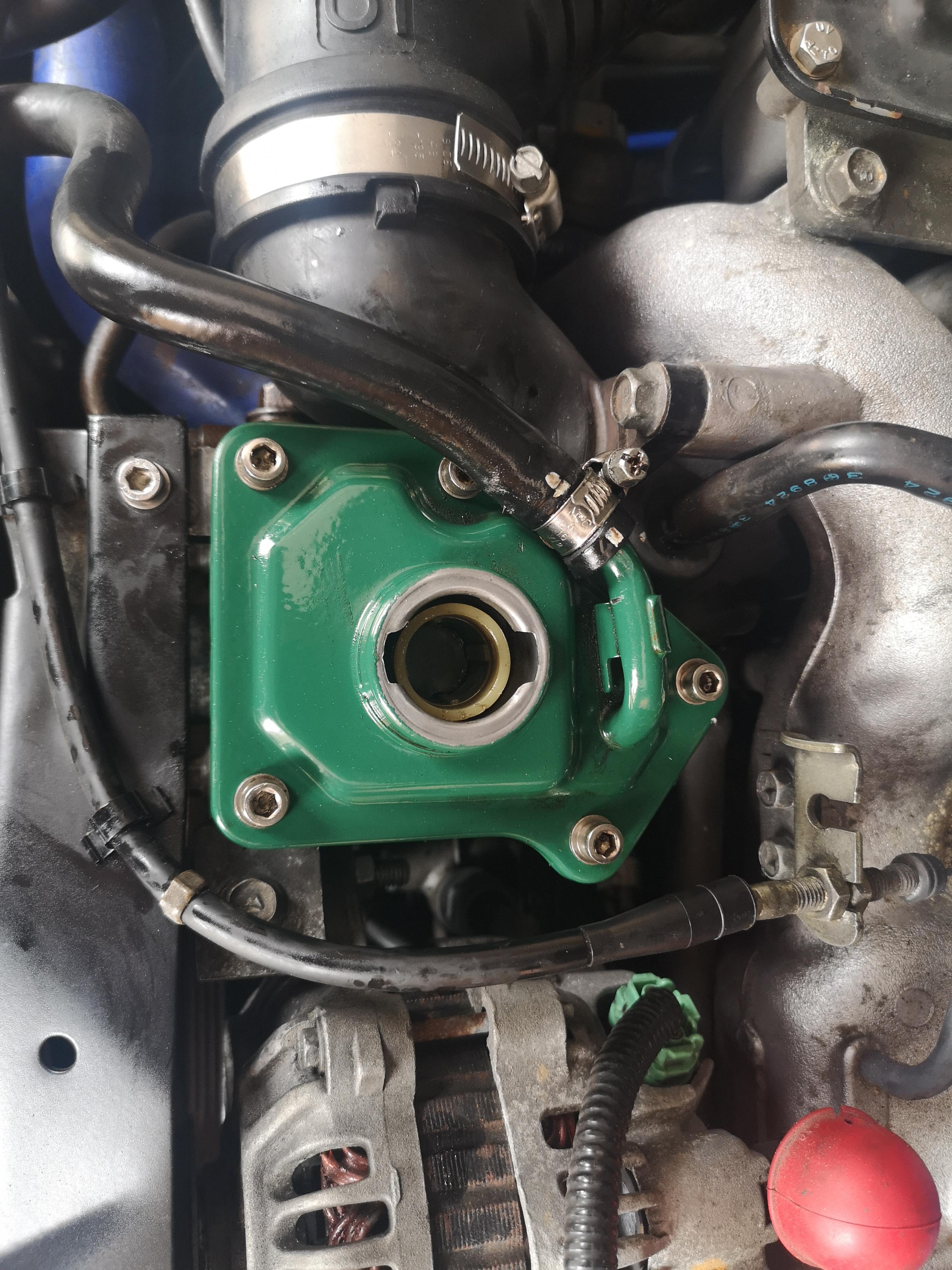

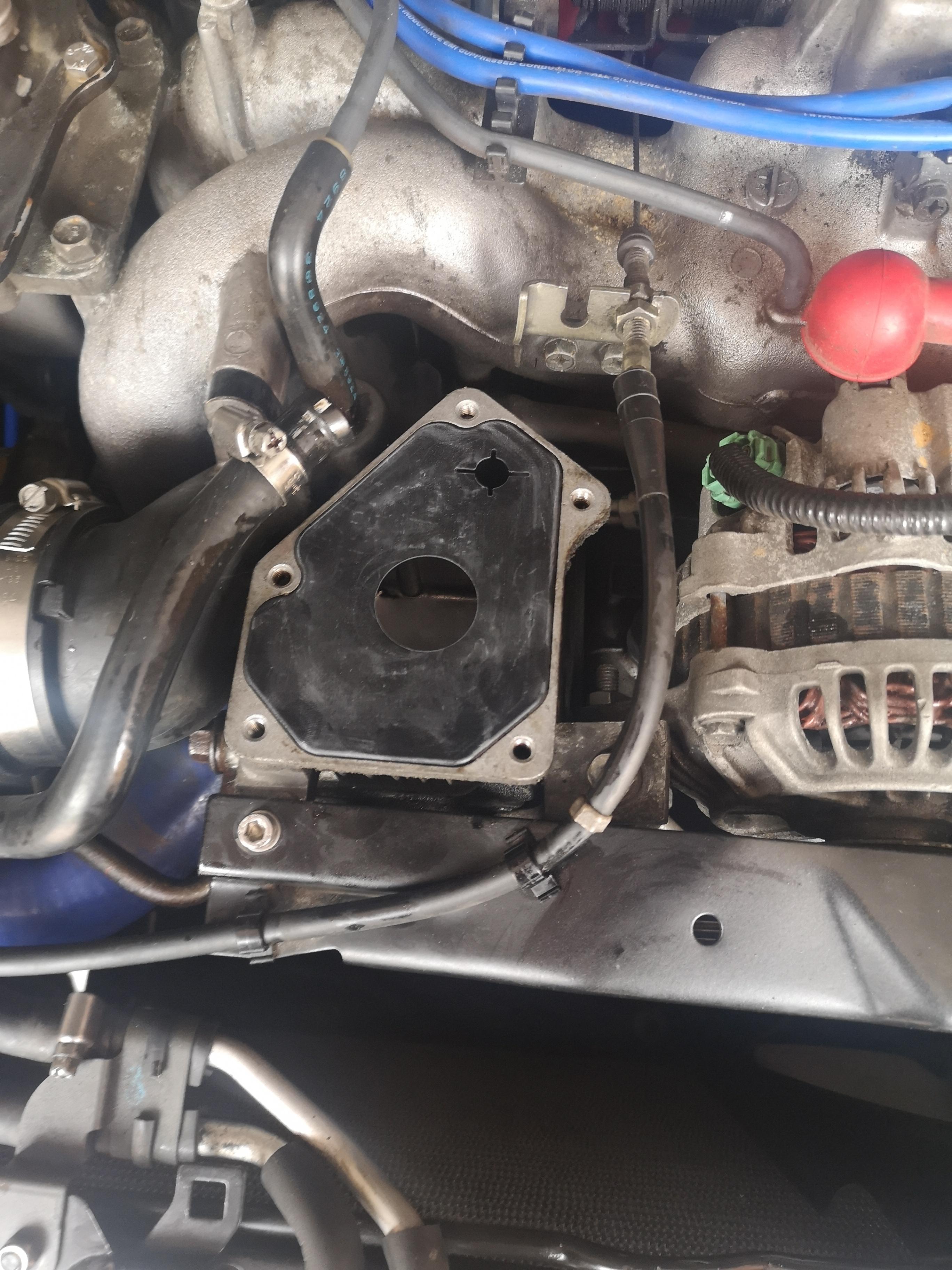

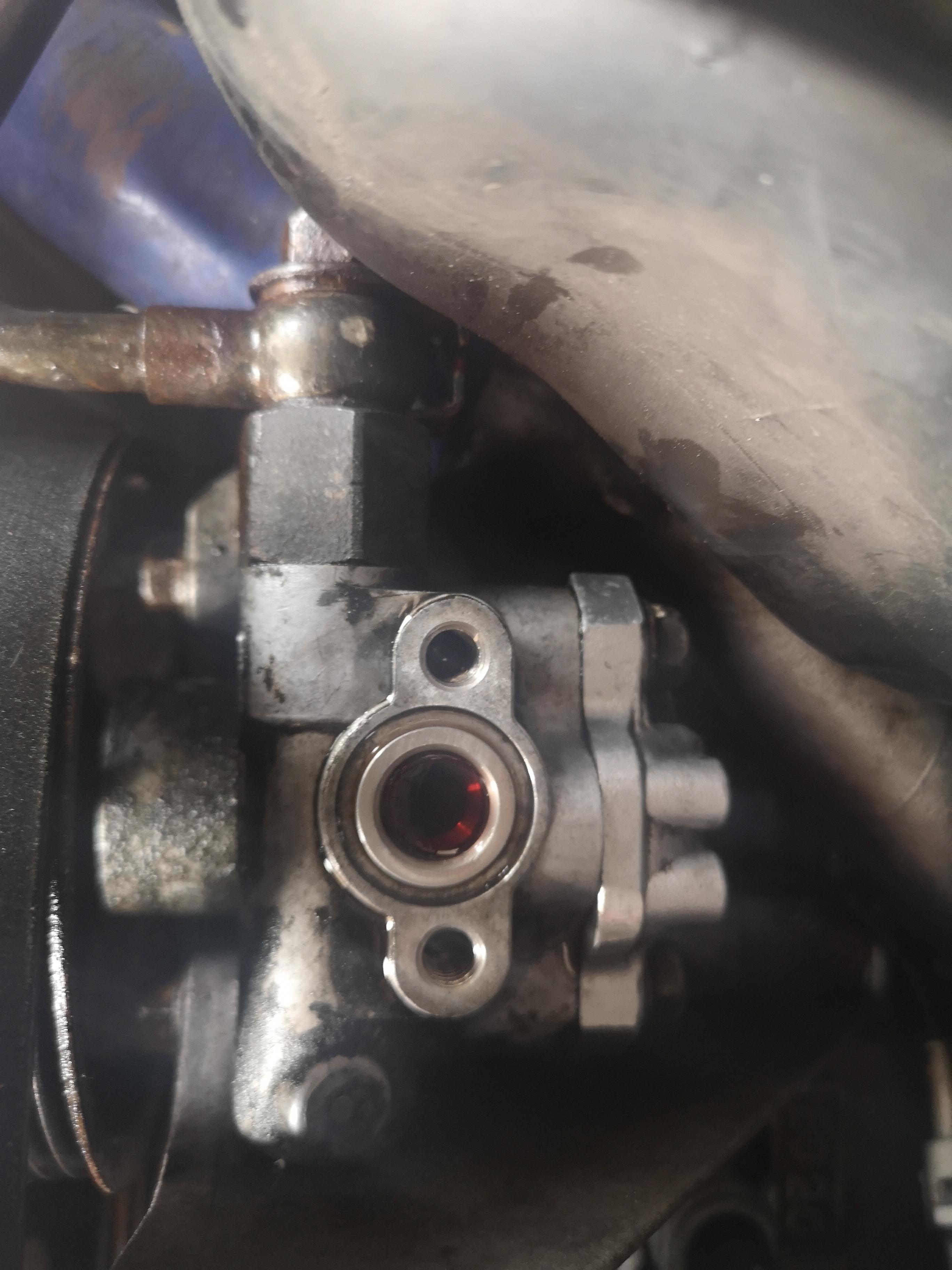

 Parts have arrived, will get to sort this out tomorrow 🙂
All done, if that isn't the cause I guess a new power steering pump is next!

Great job mate, thanks for the pictures too. You’ve done a good job.
