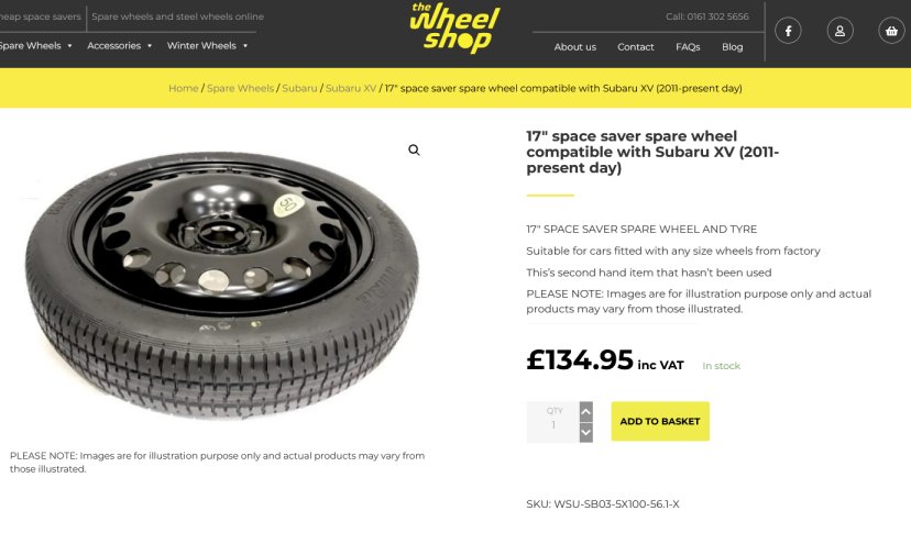

Well I took the plunge and bought a skinny space saver spare wheel from The Wheel Shop (I have no connection with them) who were helpful with dimensions etc. It fitted fine into the wheel well. It was slightly thicker than the existing trim allowed for so the carpet board in the boot was raised up by about a centimeter or two. You'll need to rig up, or buy, a hold down to keep the wheel in place but there is room in the centre of the wheel for existing tools except the wheel brace.
Subaru were happy to sell me a full size spare wheel + 'necessary' extras but they wanted about £600 for that !!!
17 SPACE SAVER SPARE WHEEL COMPATIBLE WITH SUBARU XV (2011-PRESENT DAY) Space Saver Wheel The Wheel Shop.jpg
