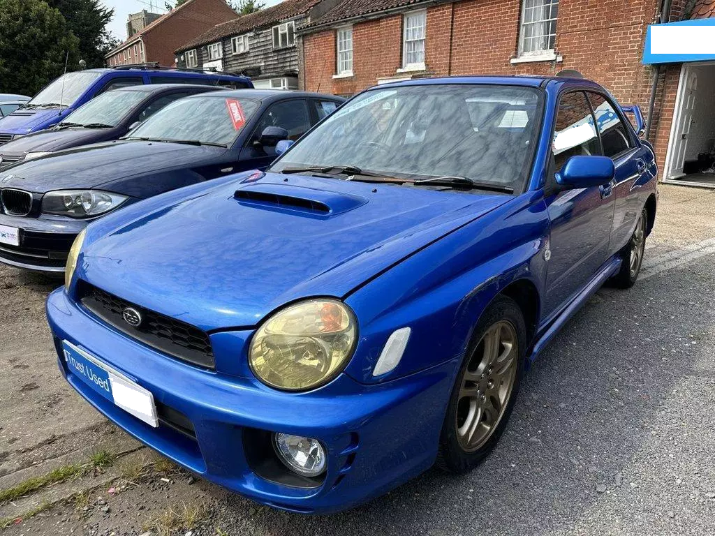

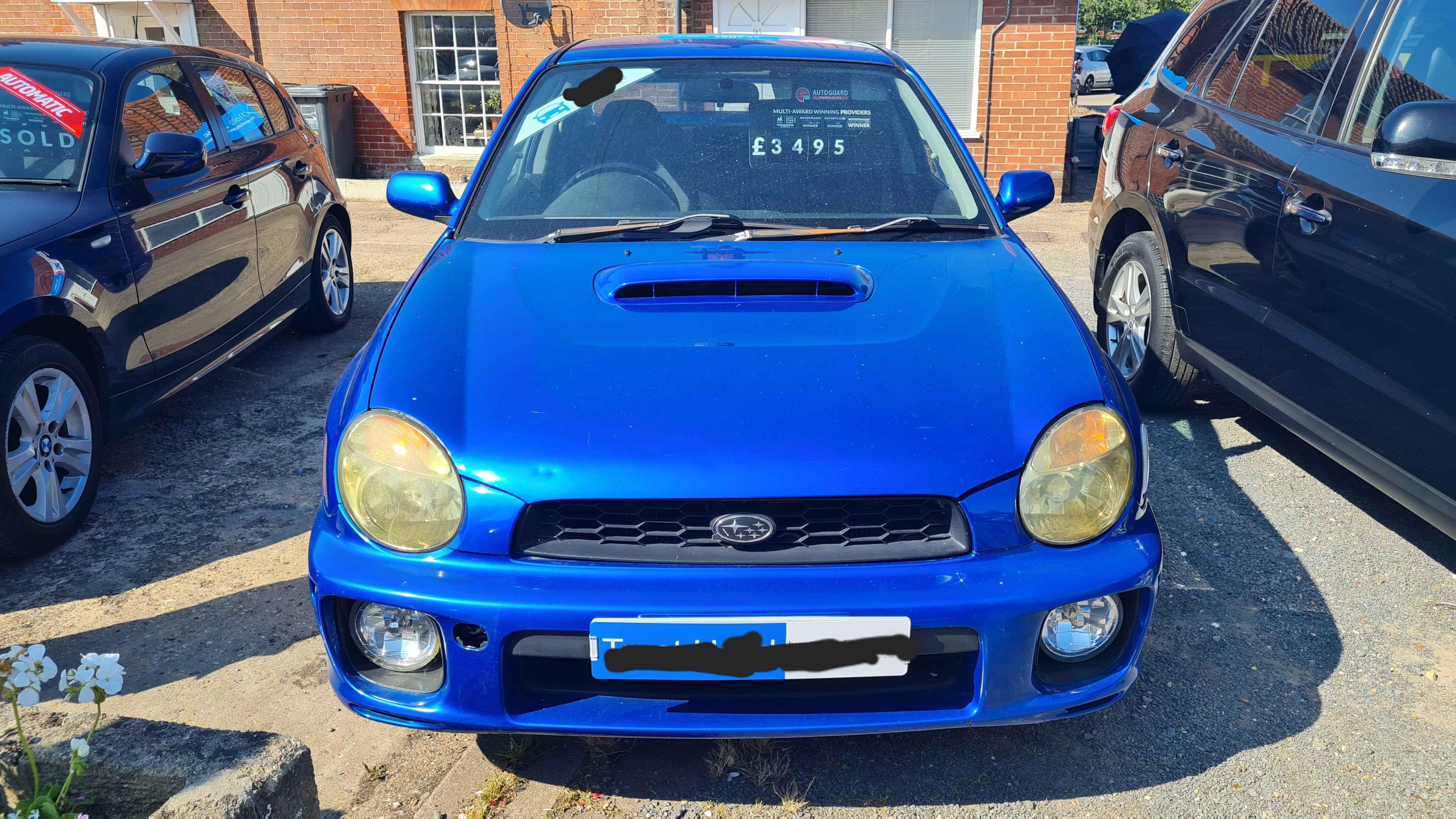

I came across this "WRX STI" for sale locally and I was immediately interested. I am by no means a Subaru expert and haven't owned one before but always did want one.

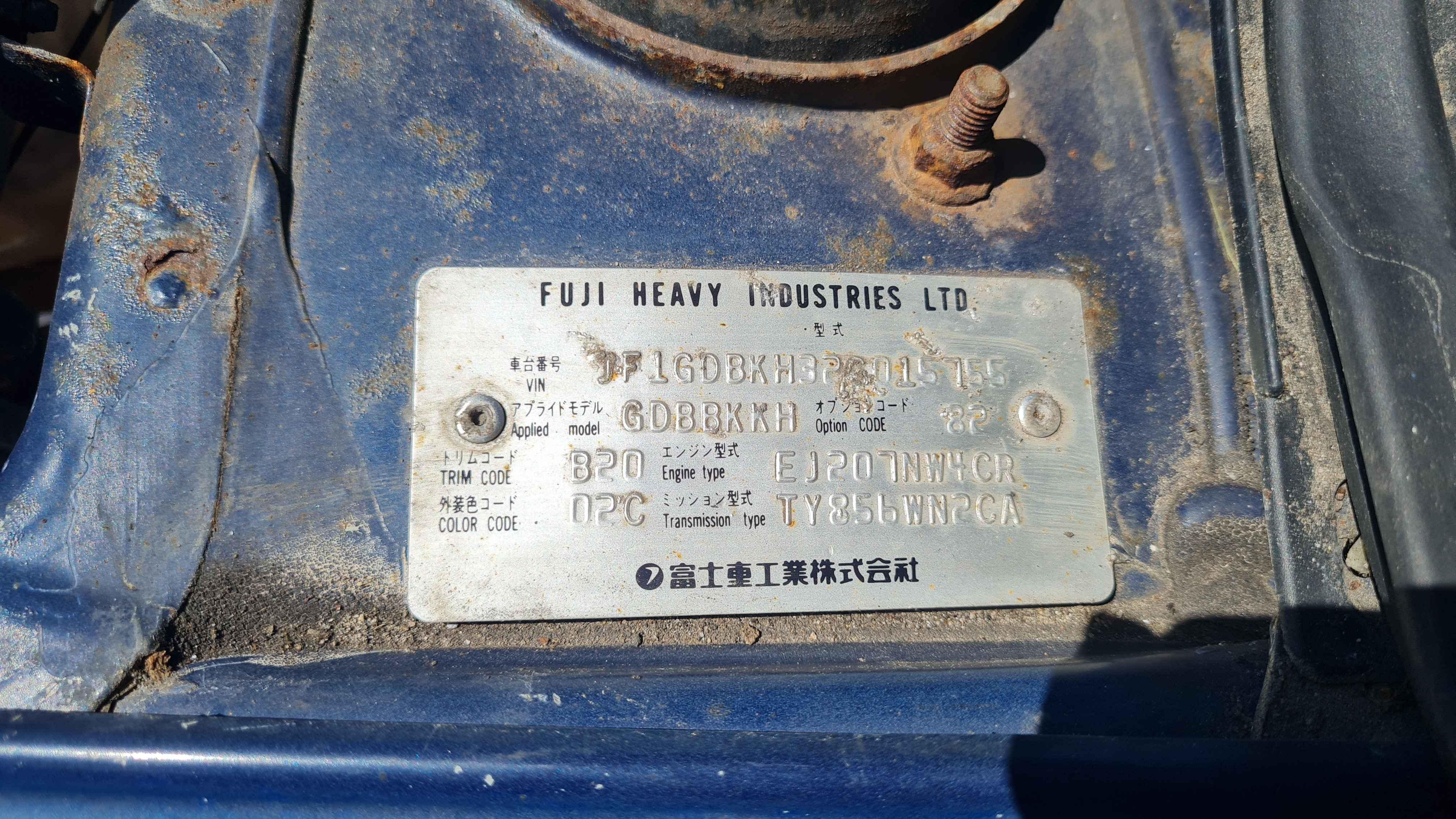

It is registered with the DVLA as a "Subaru Impreza 2.0 WRX-STI Type UK (Prodrive)" and the VIN plate seems to match that as its GDBBKKH and its on a 51 plate

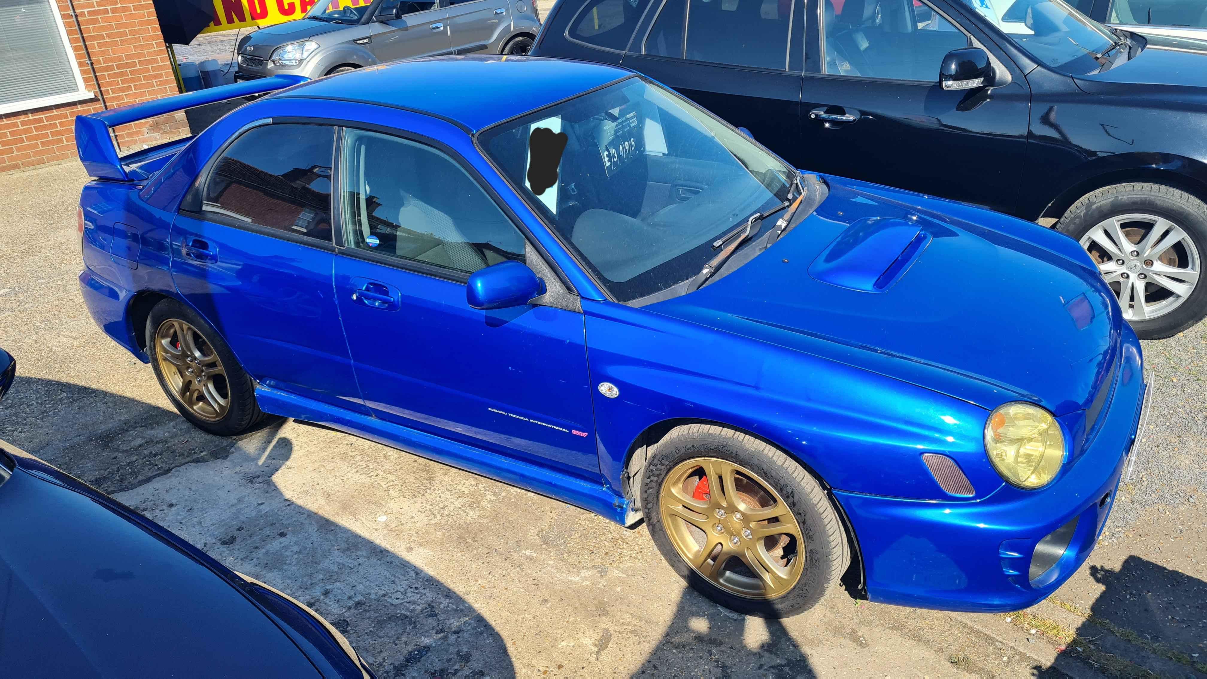

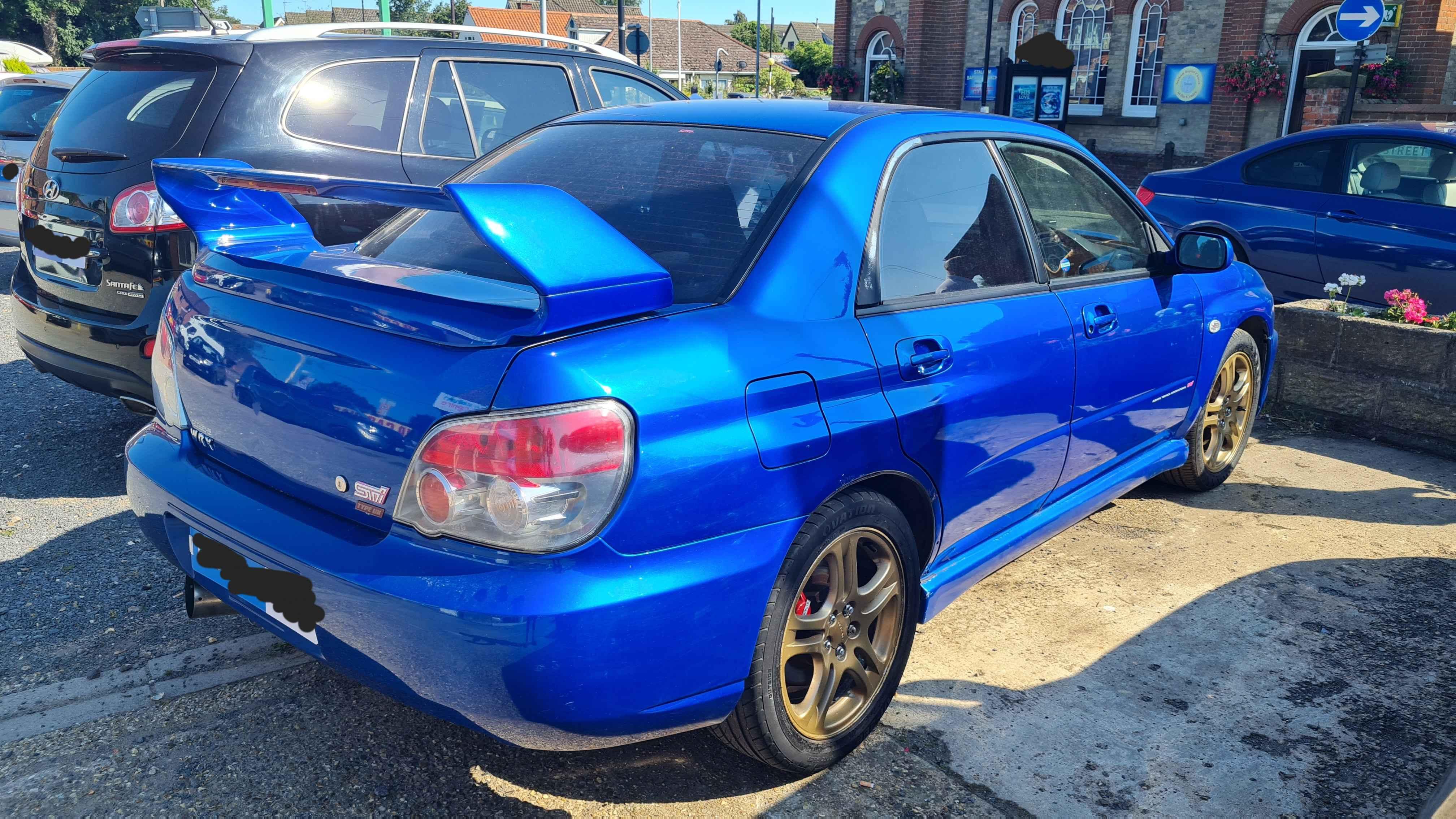

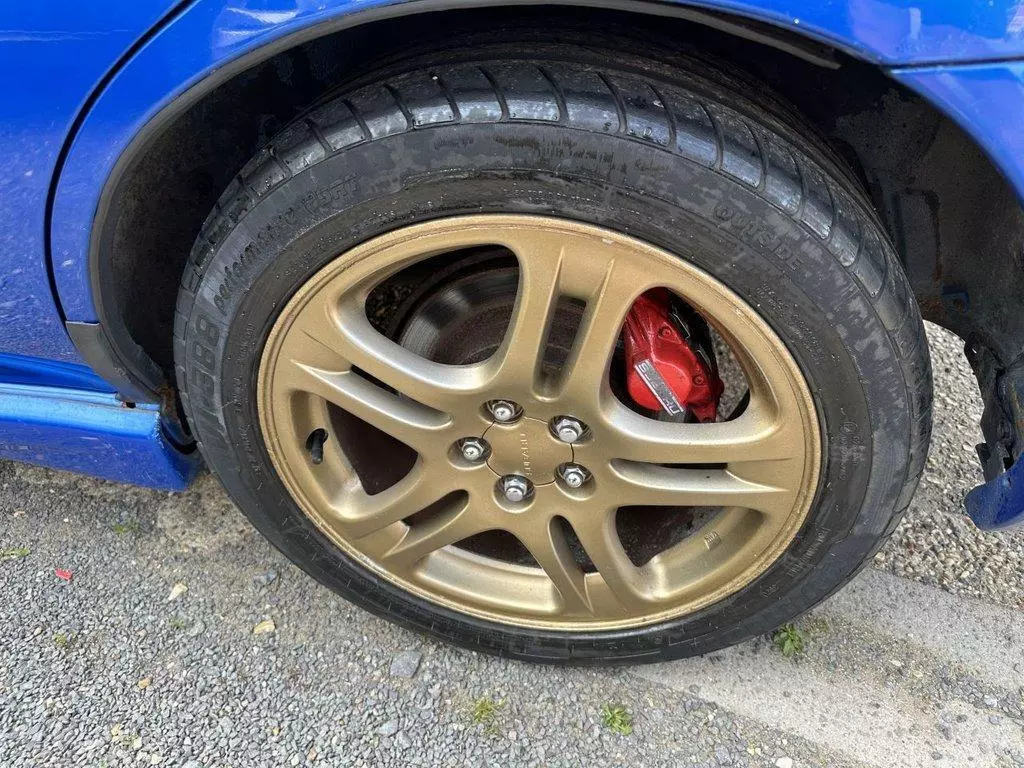

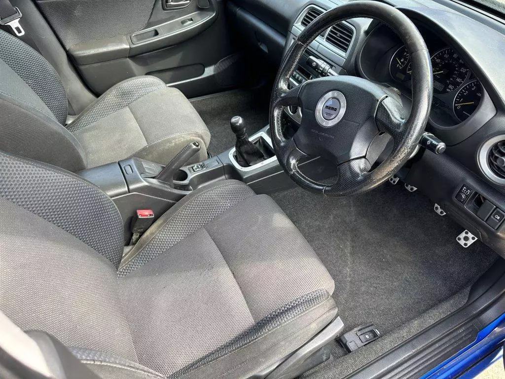

But there are some things i gathered online that an STI should have which this one does not appear to have - its a 5 speed not a 6 speed, no blue STI interior, no STI gauge cluster, no Brembo brakes, no STI intercooler. Where the intercooler water spray button should be there is a hole so i'm not sure if it is present. Also the wheel fitment seems a little odd (too narrow wheelbase?) it also has the hawkeye rear lights and bumper.

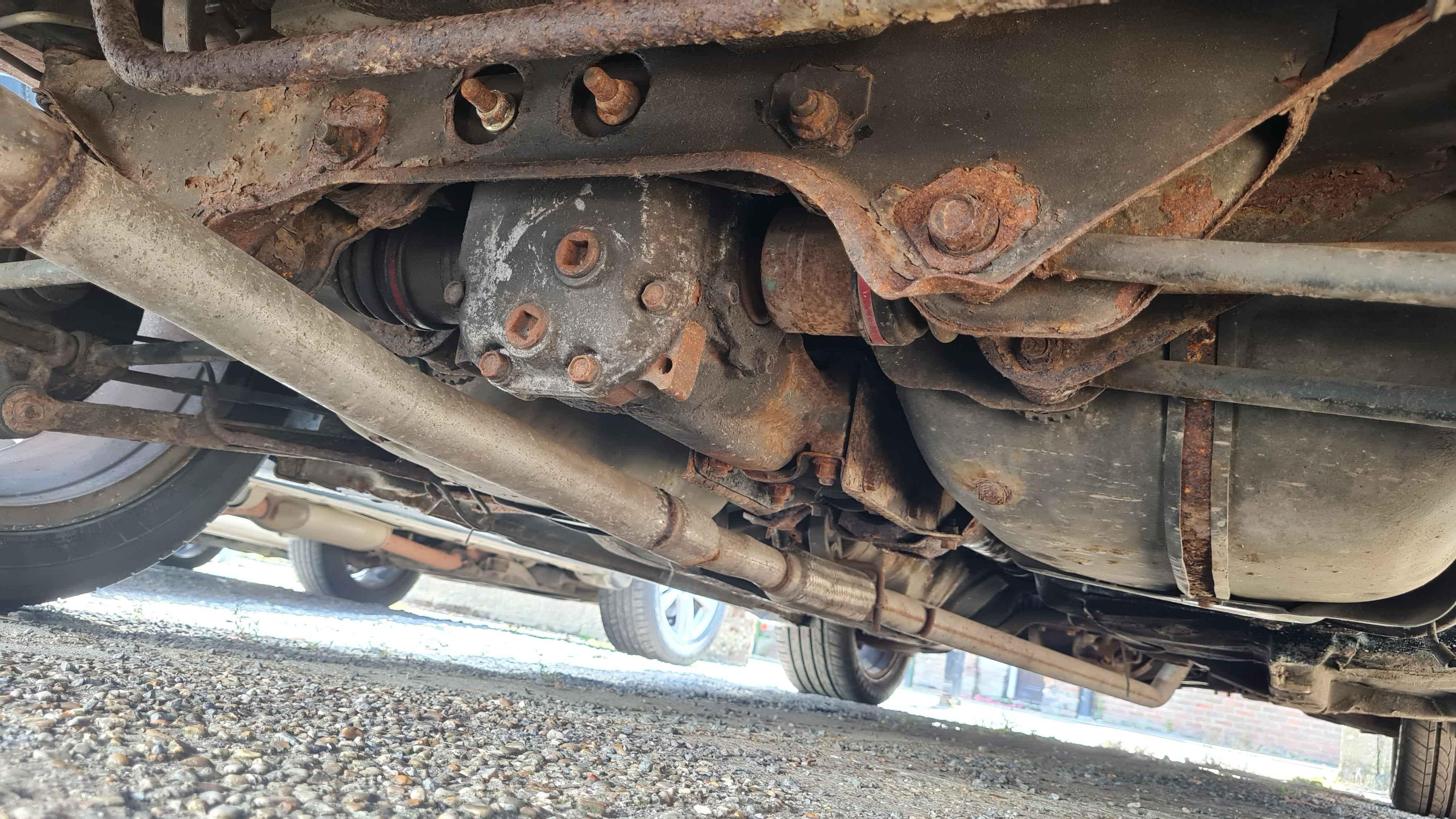

I'd appreciate the help of someone more knowledgable to help me figure out what I'm looking at here? Is it a geniuine STI Shell but with WRX powertrain? or a base model with a fancy bodykit? Also, does the rust look far gone? Maybe someone here even knows this car or its previous owner.

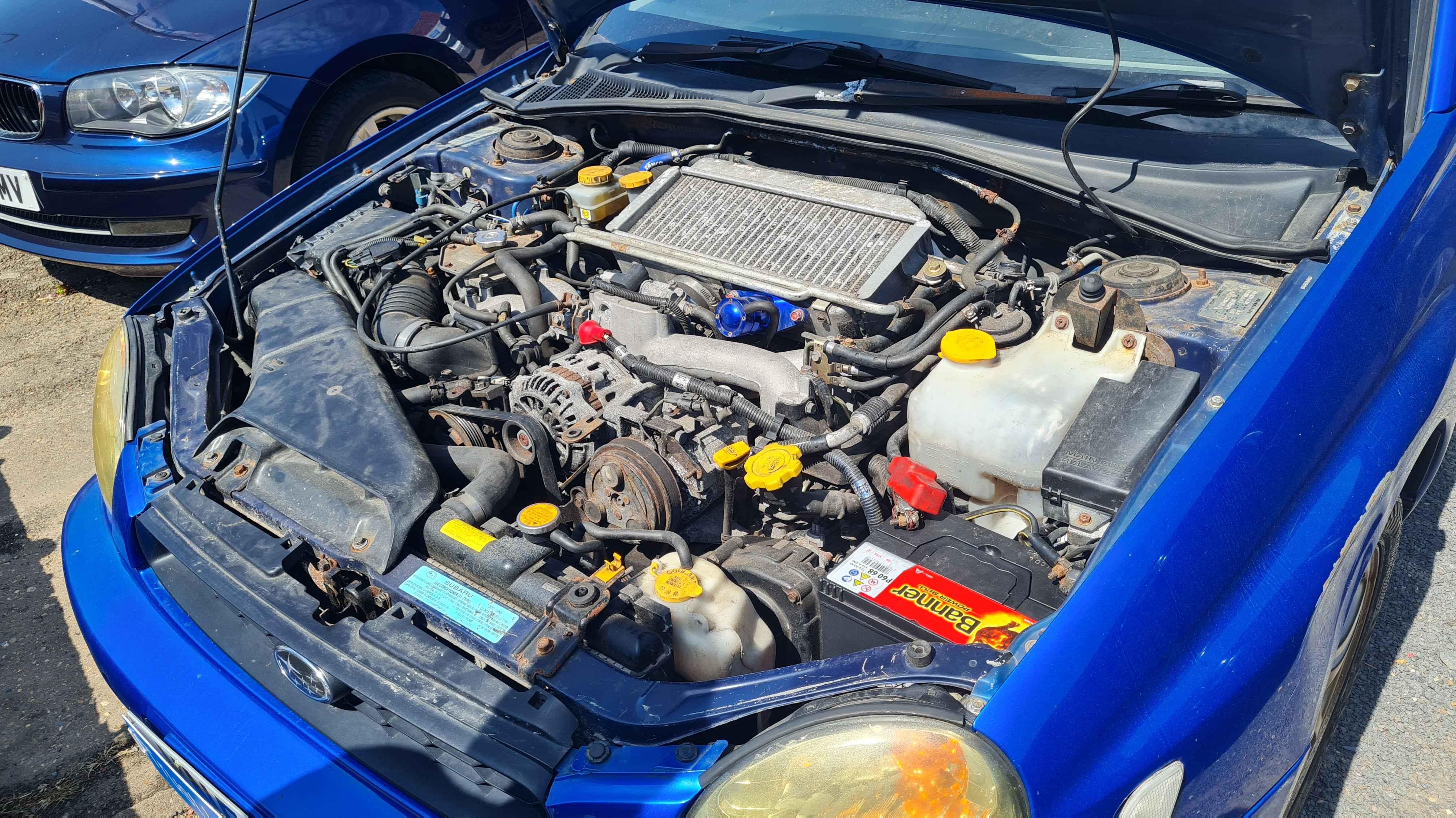

Looks like wrx that has had some badges and a vin plate thrown at it.
The VIN is a UK vin number, applied model code does indeed come back as a wrx sti prodrive uk, however i suspect its a ringer.
The parts i notice that look wrong,
running gear (rear diff is a R160 but should be R180) (2001 wont have DCCD even if it was an sti)
gear stick should be lift reverse type, this one isnt so its a 5 speed box
engine, no red inlet, missing alternator cover + various other covers and such
interior, seats, (carpet was grey for the sti model so is correct)
dash (dials should be blue, no intercooler spray buttons)
fog lights
brakes
Wheels

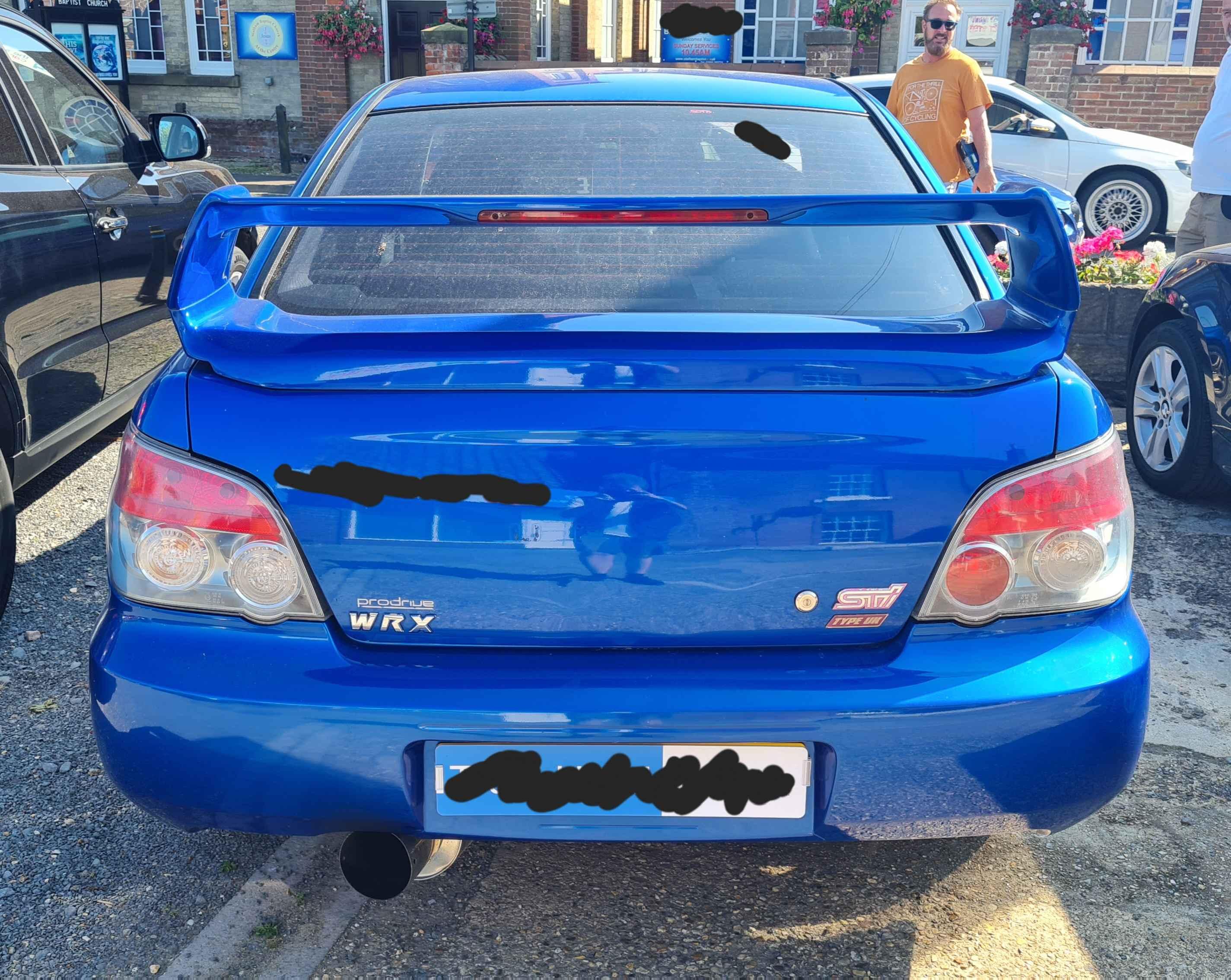

rear spoiler is STI replica (light should be at bottom for that year and angle is wrong)
WRX headlights
rear lights are from a later model
one side of the front wing has a reflector, other carbon insert, should be carbon both sides
The longer i look more i find, underside looks rather ropey, and for an sti its missing a digit in the price (Although not in the best condition).
Short version, walk away.
