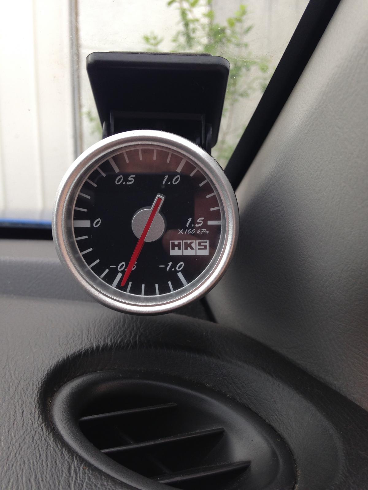

this is it today. i only started her up and was running for 10 mins. didnt move it and hasnt been moved for few days.
basically im sure wen i just had the normal recirc on it was idling 2 notches less than this. this seems particuly high today its normaly one notch less with the DV on.  am i right in thinking that this is somehow leaking there for losing power?

If it was leaking boost pressure you'd see it when you put your foot down, when it's sat at idle it's under a vacuum if it fluctuates a couple of points I wouldn't worry too much mine normally sits at -7 but after a hard drive will show 8 maybe 9.
You have to take into account the atmospheric conditions outside, air density etc, is that one a mechanical gauge ?

what u mean by mechanical gauge mate? im so new to the turbos. just bought it with it and iv fitted DV.
like i say it just seems that little bit less power but it might well not be and once i saw the gauge at different point it just had me wondering if im losing boost or had a leake
Hi mate, some gauges are electronic and some mechanical, electronic boost gauges have a vacuum line coming off the engine that then goes into a little box converts it into an electrical signal so all you have going into your gauge is a load of electrical wires, mechanical ones will have the vacuum line running all the way from engine to the gauge and maybe some electrical stuff if it illuminates at night

Don't worry about the gauge at idle, shows no boost, should be just sat in the negative section of the display, even when driving gently under small load the gauge will read between 0 and a minus figure when you come off the gas, it won't start showing boost till it reaches a designated point, usually anywhere betweek 2.5k and 3k depending on car size of turbo mods etc, gambit should be able to tell you roughly where your model starts too come on,
If you have a leak it won't hold boost at a steady pressure, you'd see it on the gauge by it not rising properly when giving it some welly, would probibaly get to a certian figure (we'll call it 0.5) then drop a bit and try again, if you have a leak chances are the cel light would indicate a problem, and put he car into safe mode before you did anything to destroy the car,
