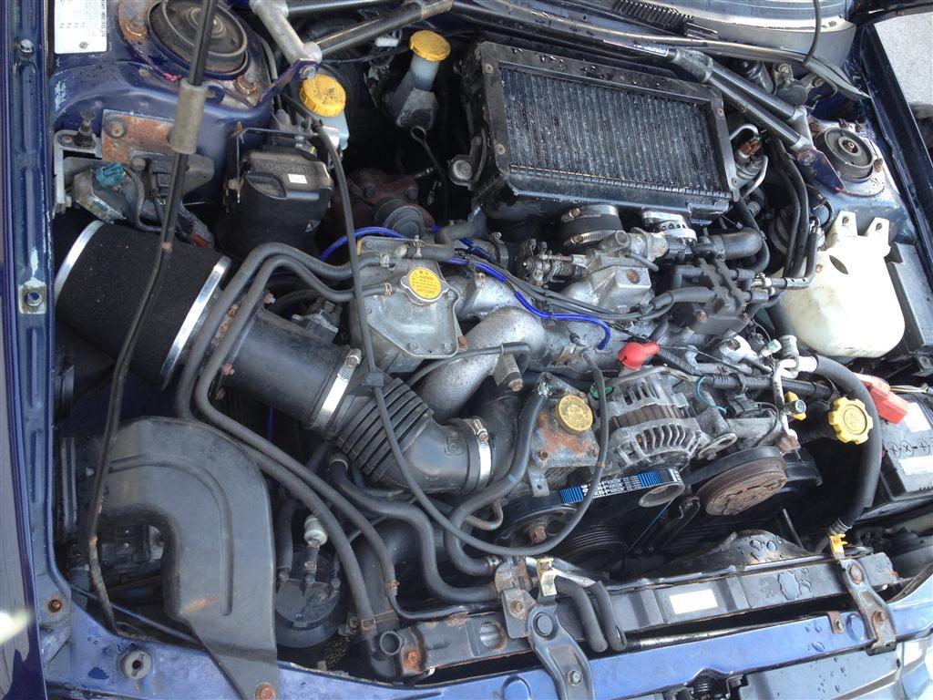

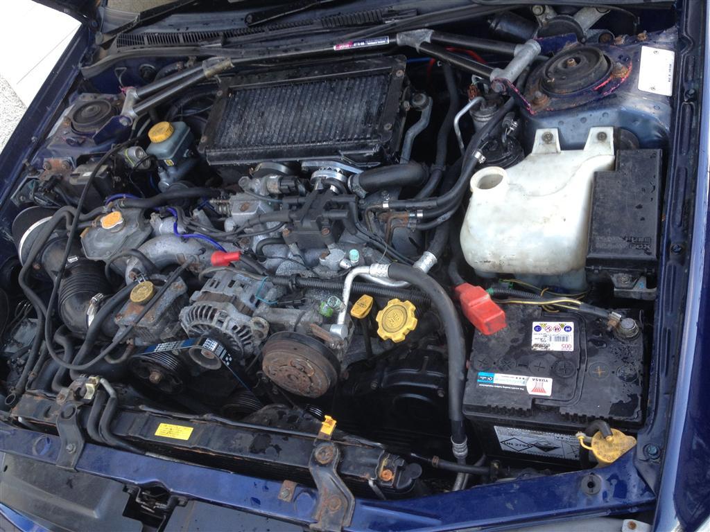

The outside looks clean has the engine bay had the same attention?

Inside the engine bay doesn't looks quite so great but it has new belts all round, cam, alternator, etc so it should be sound enough. Her it is at home after a wash.
