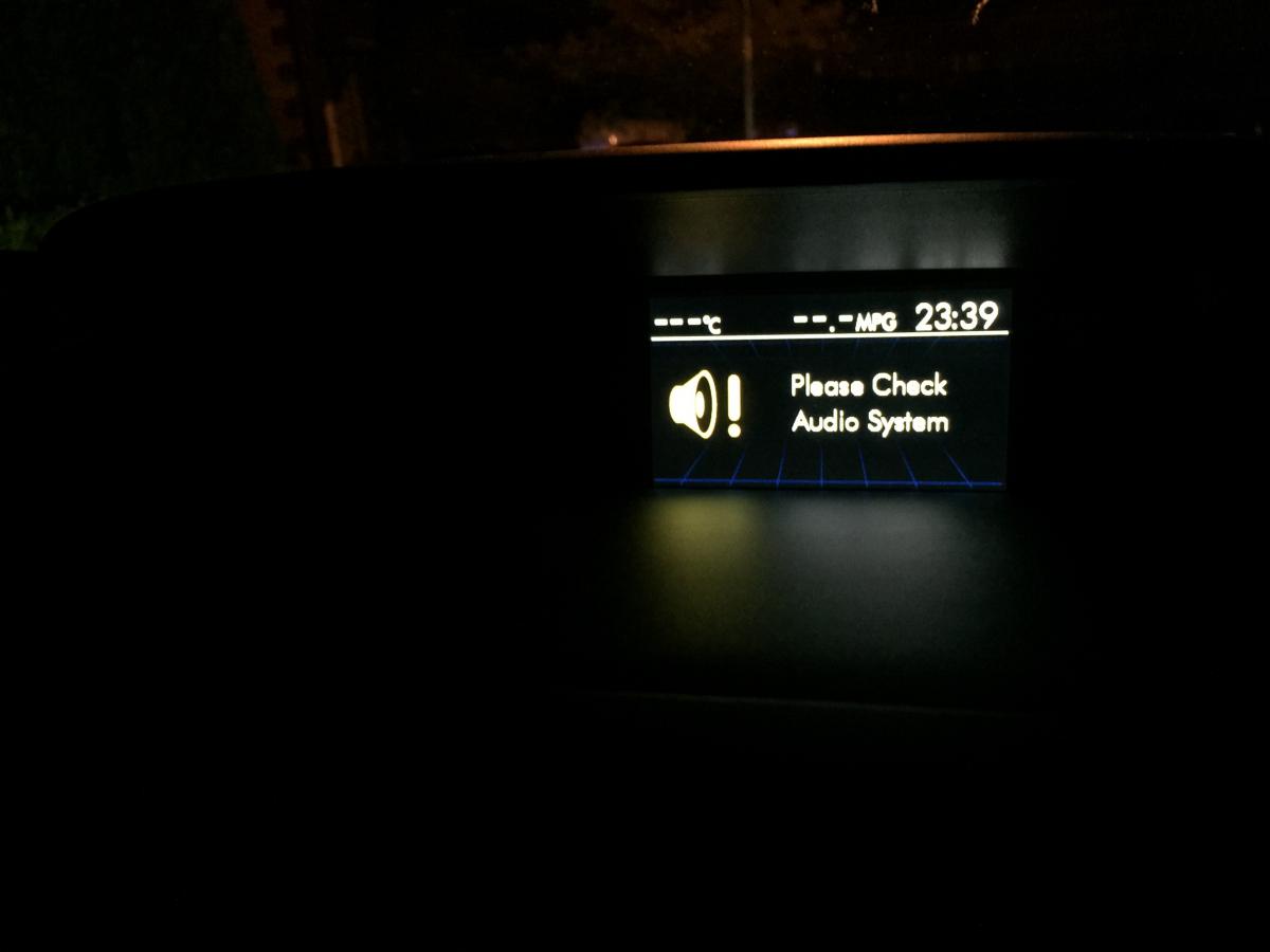

Hi just installed a new Stereo in my 2015 sti which has not been going well att keeps comming on and off got no serivce on Bluetooth will have to pull it back out and have a look does any one know how to hook it up so the message on the boost gauge screen saying check audio system does not cheap showing up too any suggestions would be good I some how all ways manage to make a simple job a mission :(

If all cables are connected correctly I think I know what's you problem may be who ever installed it may not of disconnected your Battery try that by doing this it will reset the system so the car forgets and is not looking for the std Stereo codes which will throw up a audio waring disconnect and leave disconnected for 5 min then reconnect you will get a call from the Tracker people thou just tell them what your doing and will be reconnecting in 5min they be fine I done it about 4 times now for different thing they must love me lol
