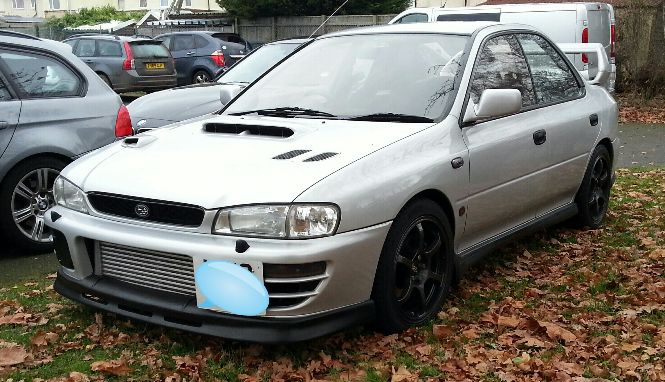

I run elbach pro springs with the standard uk turbo strutts they're progressive rate , so not too stiff on the straight but stiffen up under load (in the corners)
Think they lower the uk turbo and wrx 30 mm to the height of a standard sti
Pic of mine
