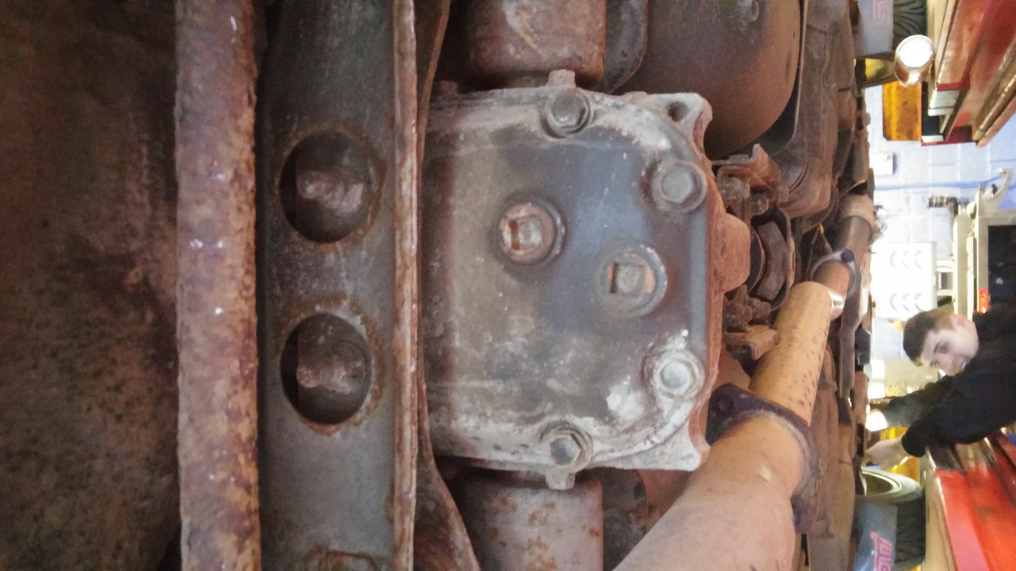

Which one?
post-4007-142687318336_thumb.jpg as I understand one is to do the oil and one is to drop the gears out....which one is which lol
One on the far right is sump drain one in the middle is sump filler, i'd undo the filler 1st to make sure it comes off,
Two on the left in the frame hold the diff onto subframe.
I did it this morning all good
