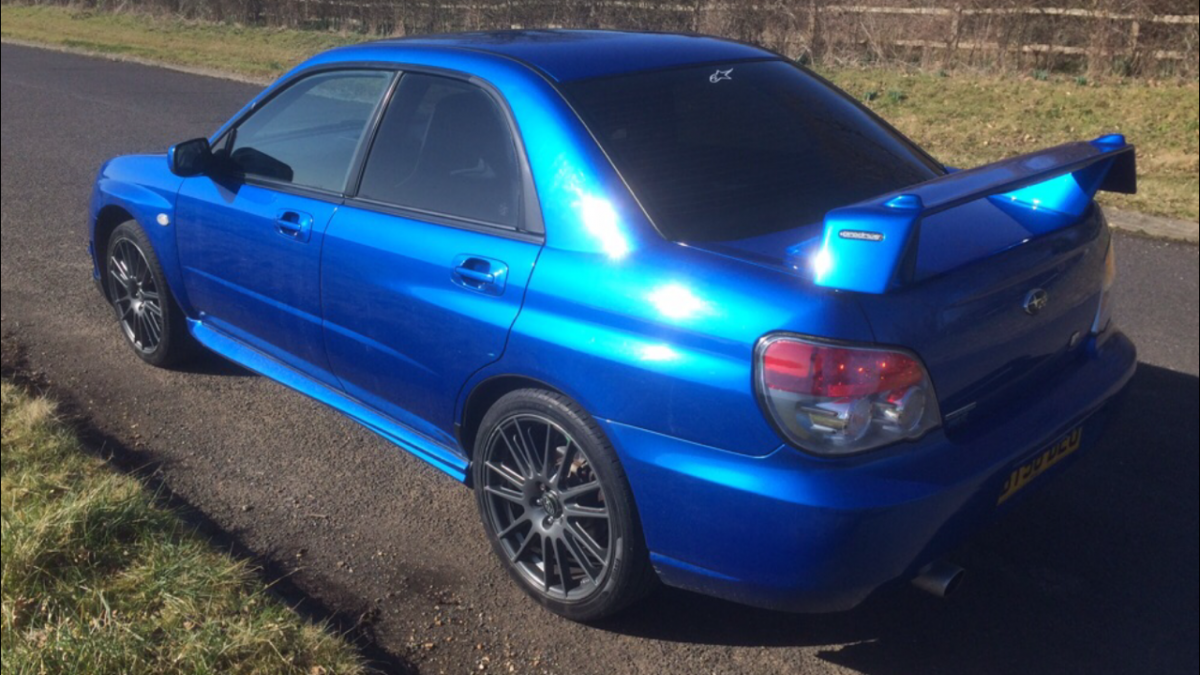

Loving the car drives like a dream and an amazing step up from a Renault  :lol:
done about 500 mile in a week since having it cant get out of it, 200 was picking it up like
but last few days say 30-45 mins driving i get squeaky brakes when coming to a stop at low speed
its a little annoying but it doesn't take it away from its beauty
passed MOT last Friday with no advisories
post-4058-0-84896300-1427476796_thumb.pn
