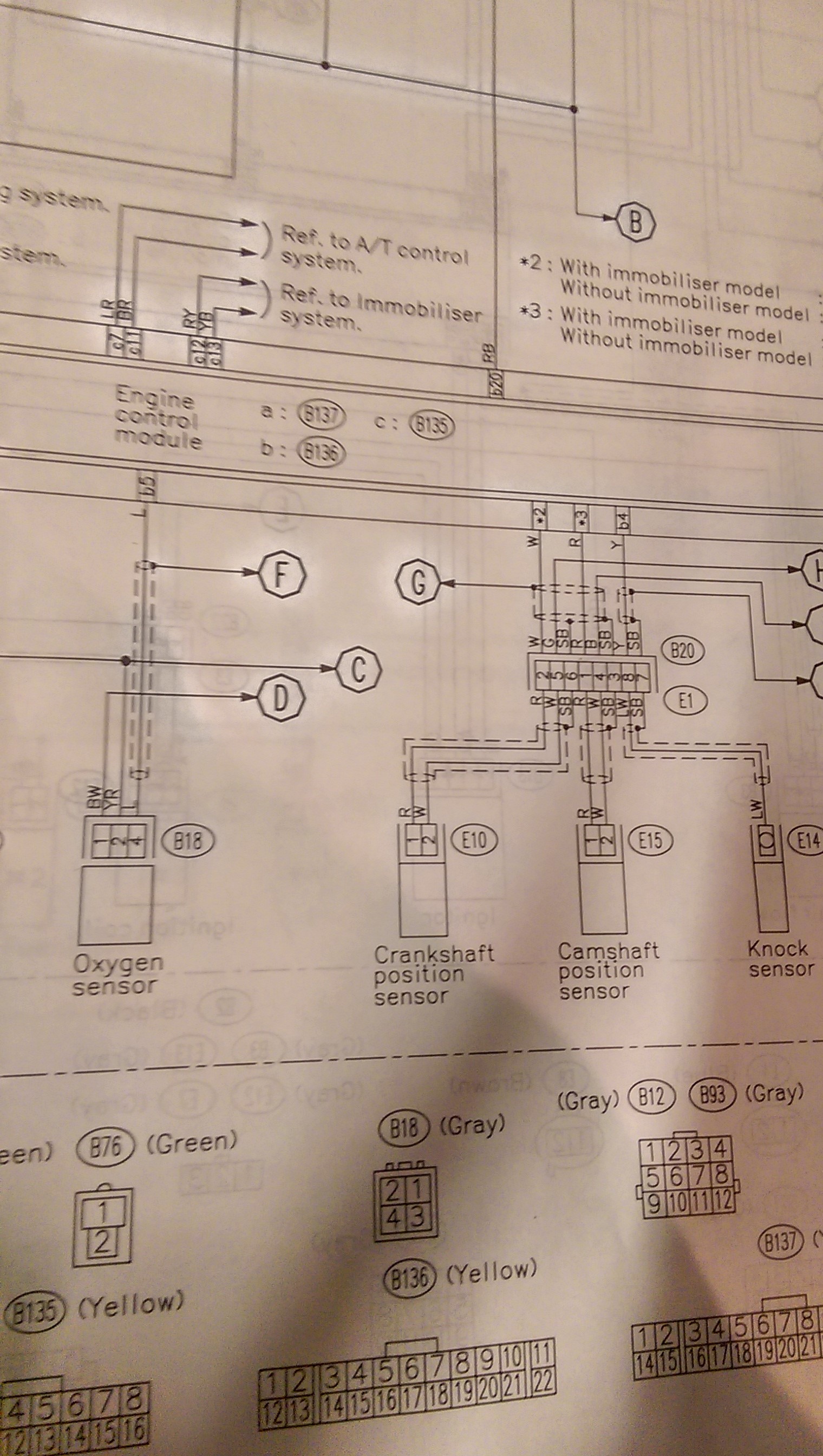

so thats pin 2 and 3 on the ecm(ecu)
and connector type B which is B136
at the bottom of the picture is connector b136 which plugs into the ecu.
 IMG_20160229_171320.thumb.jpg.ff6766fd73
if you need anything else let me know
Cheers mate I will take a look tomorrow at pin 2 and 3
