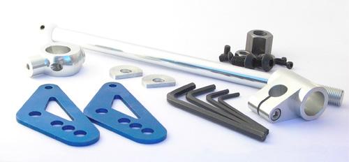

never used 1 but i was going to get this for my hatch  http://www.tarmacsportz.co.uk/GB/WRX_Perrin_Short_Shifter_Adapter/SU8_PSP-INR-200_.aspx

How does that Perrin adaptor work?

the perrin adaptor is much easyer to install,you dont have to take the gear stick out.so if your not good with macanics then its better for you
this is how to fit the cobb but it is what you would do to fit the japspeed and kartboy as well,much more work then the perrin.the japspeed is not ajustable either so what ever its like when you fit it is what you get.
I don't mind getting my hands dirty working on cars but after those vids I think i'd be tempted by the Perrin adaptor, that looks nice and neat. Good value too.

So I went with the Perrin adaptor.
Fitted it yesterday, took about 45mins and I didn't break any plastic trims so thats a bonus.
Its adjustable up to a 50% reduction in throw (which is where i have set mine to) and it has massively improved the feel of my gear changing now :D.

The perrin kit from tarmac sports comes with poly bushes for the front of the linkage. Is that what you mean?
Dose the shifter sit any lower with the perin kit? As I like the look of the cobb but the perin sounds like the better option over all.
No its the same height it sits a bit further forward though.
