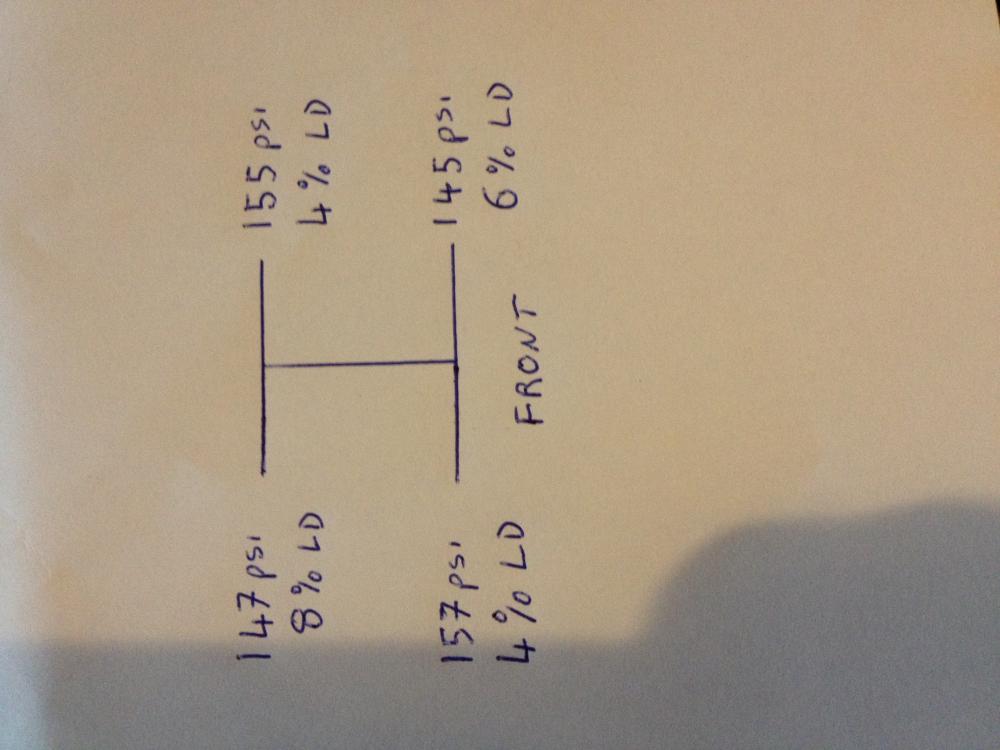

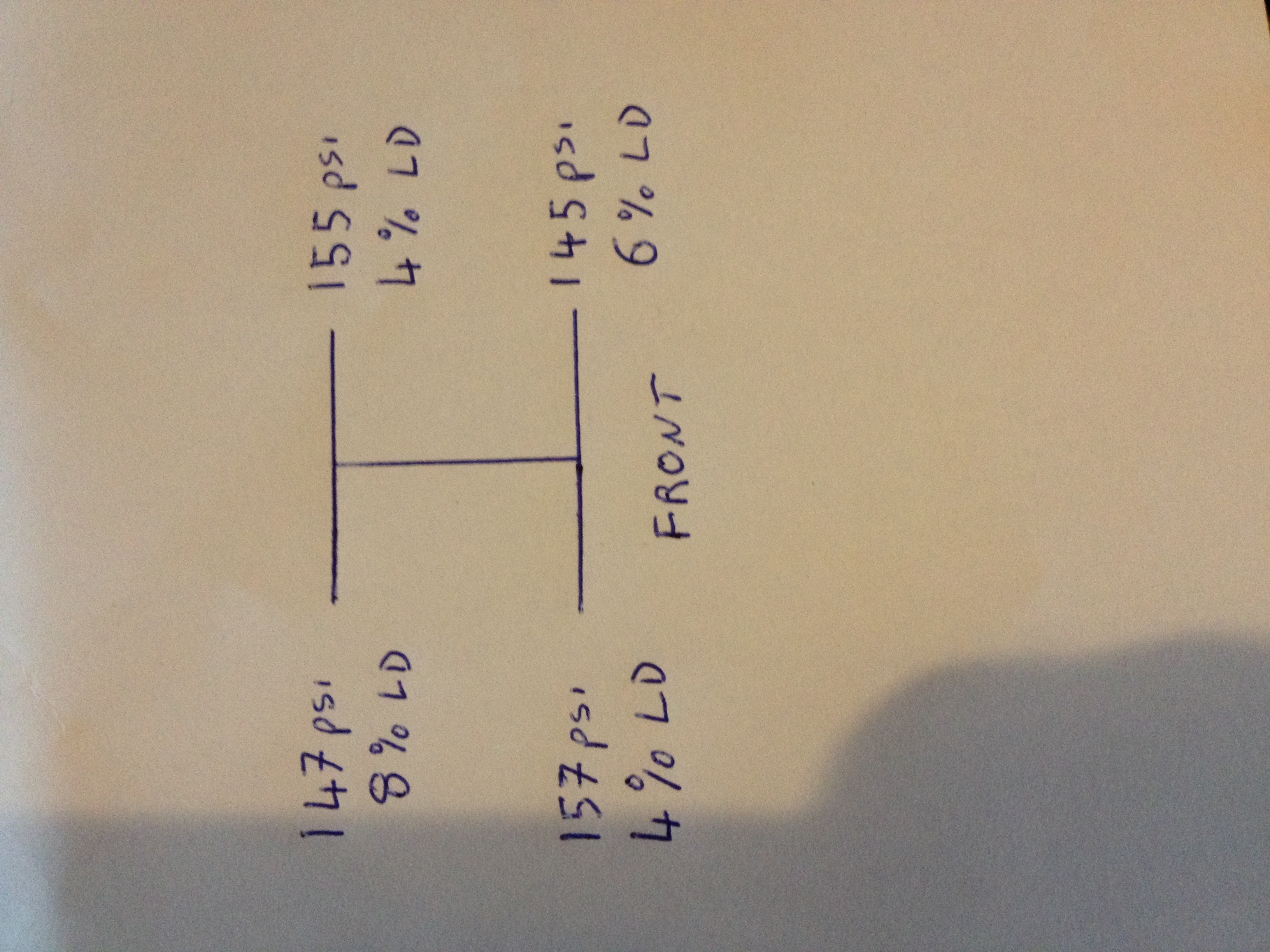

Mine has all those parts new, I've replaced loads of stuff due to the mileage being just over 100k and trying to get rid of some of its little issues lol, I think it either the map now or ringlands, it does use a bit of oil but the bores are pretty glazed tbh, judging the owner from new on the paperwork I have I would say it got babied on the break in period tbh, anyway we will see
conpression and leak down tests as follows
