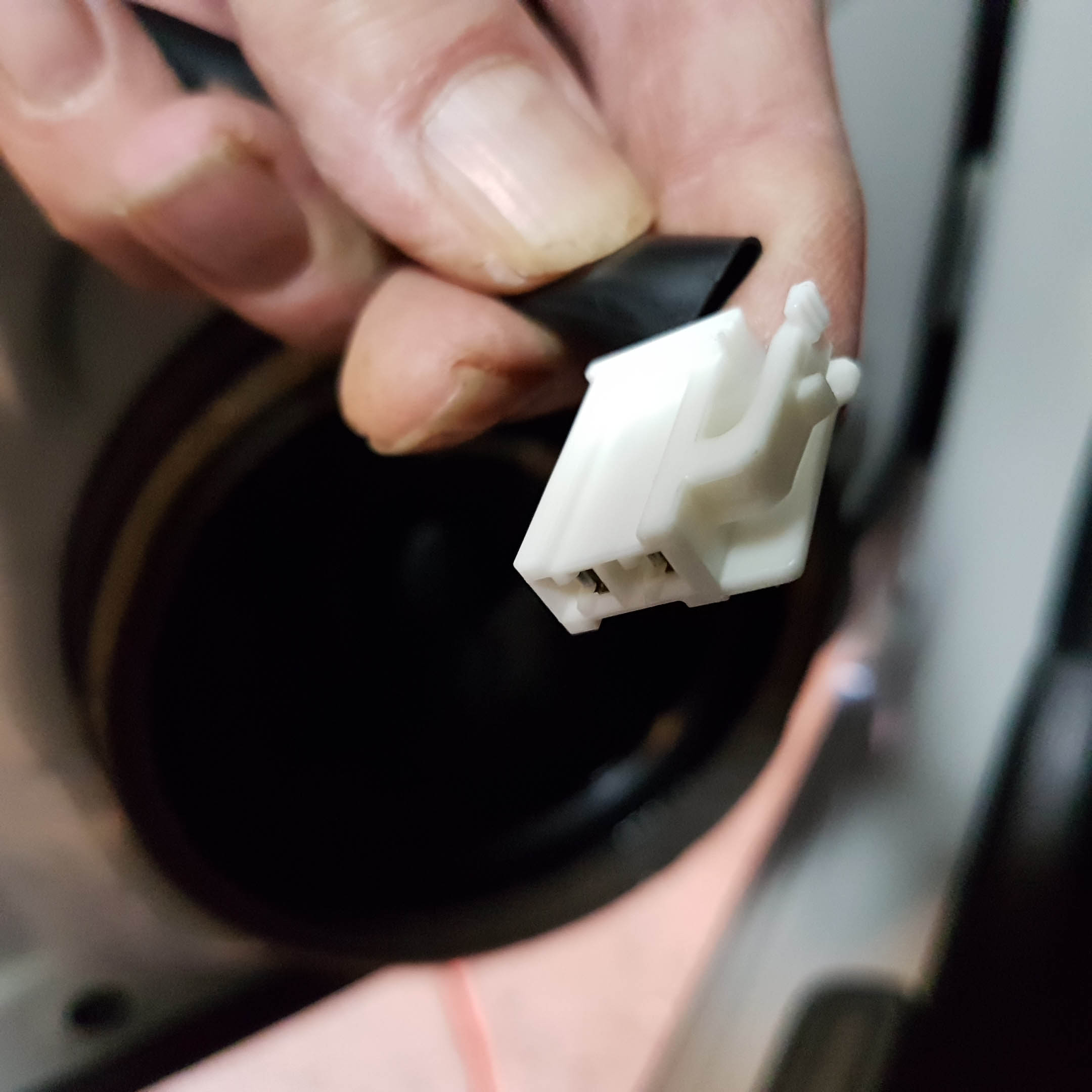

Hear's what I found :-

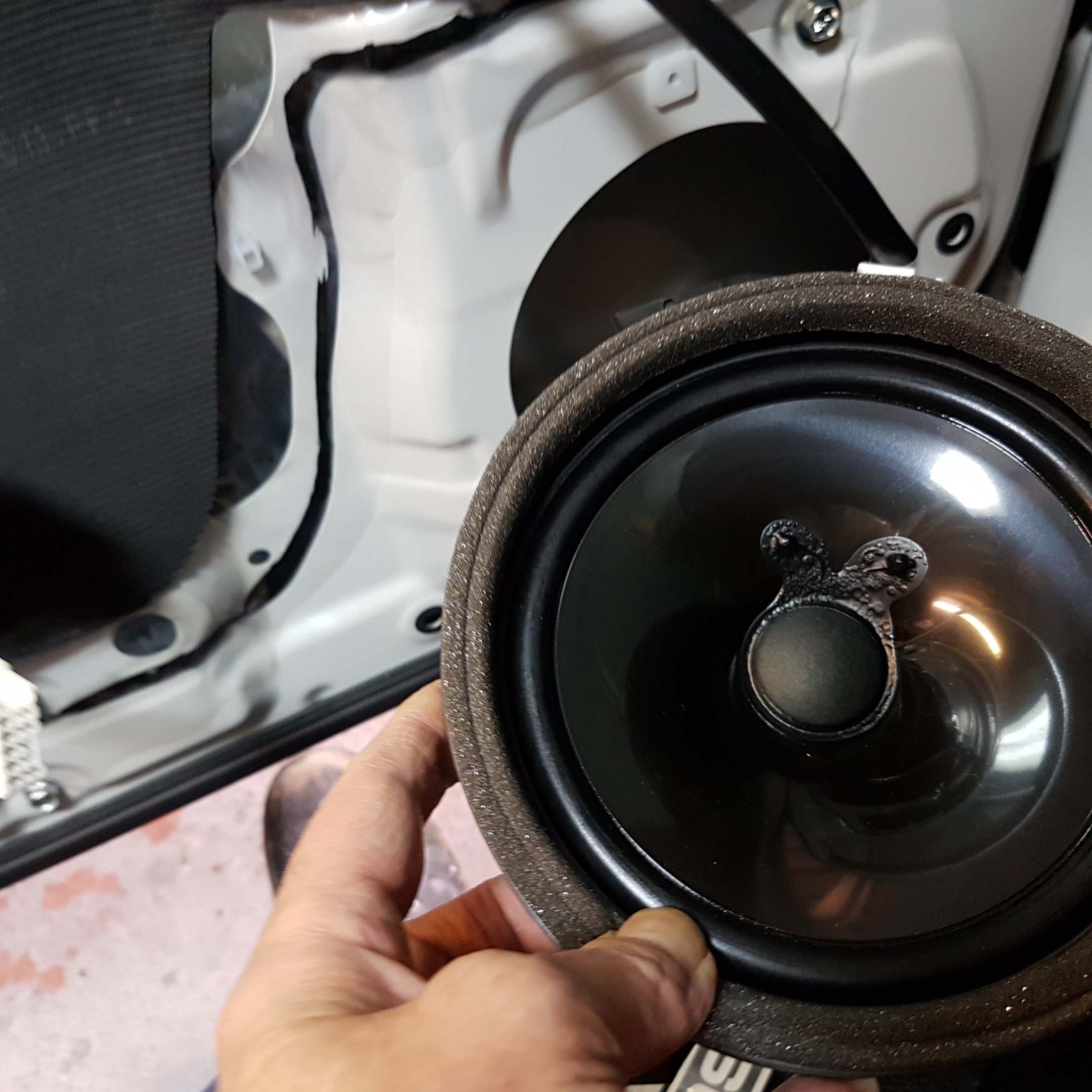

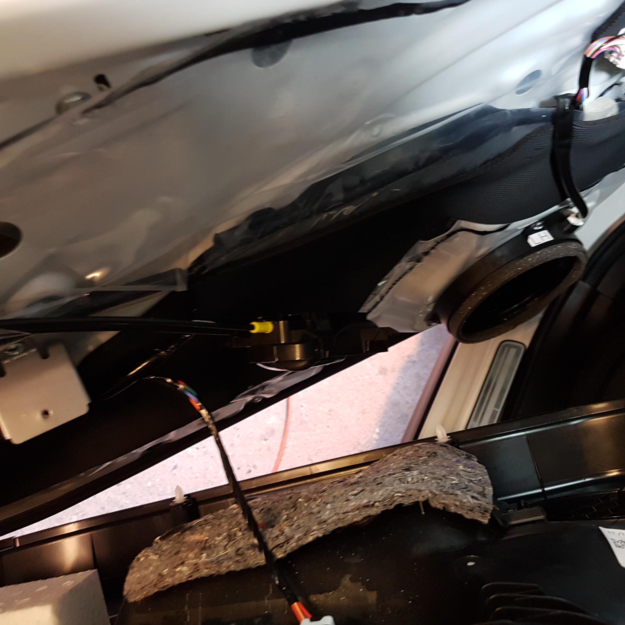

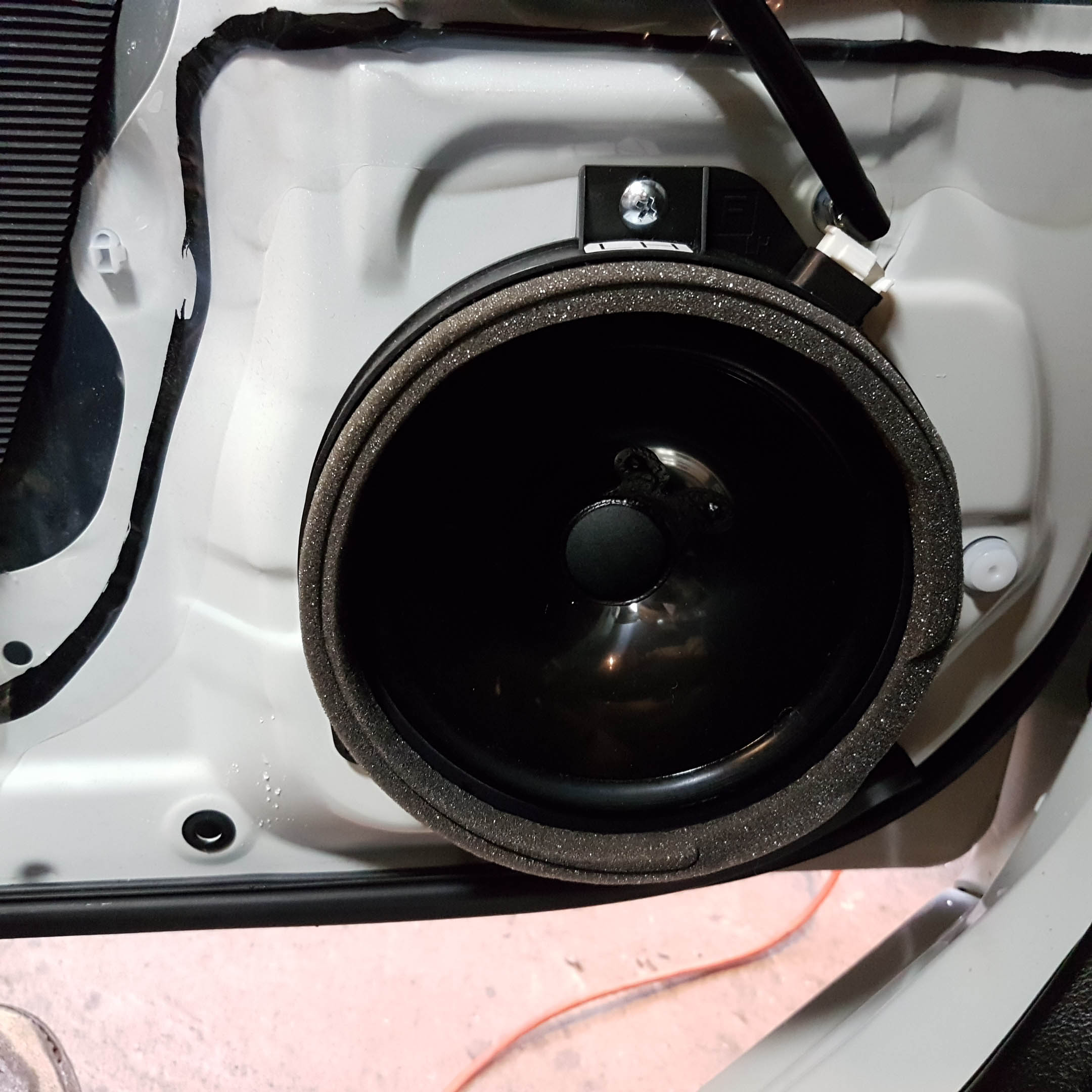

1, the speakers sit of the door in a specially constructed aperture housing.
2, when you remove the door card there is one side quick release tab to push in to disconnect the connector block for the electrics,
3 the speaker is attached by three screws rather than the usual four,

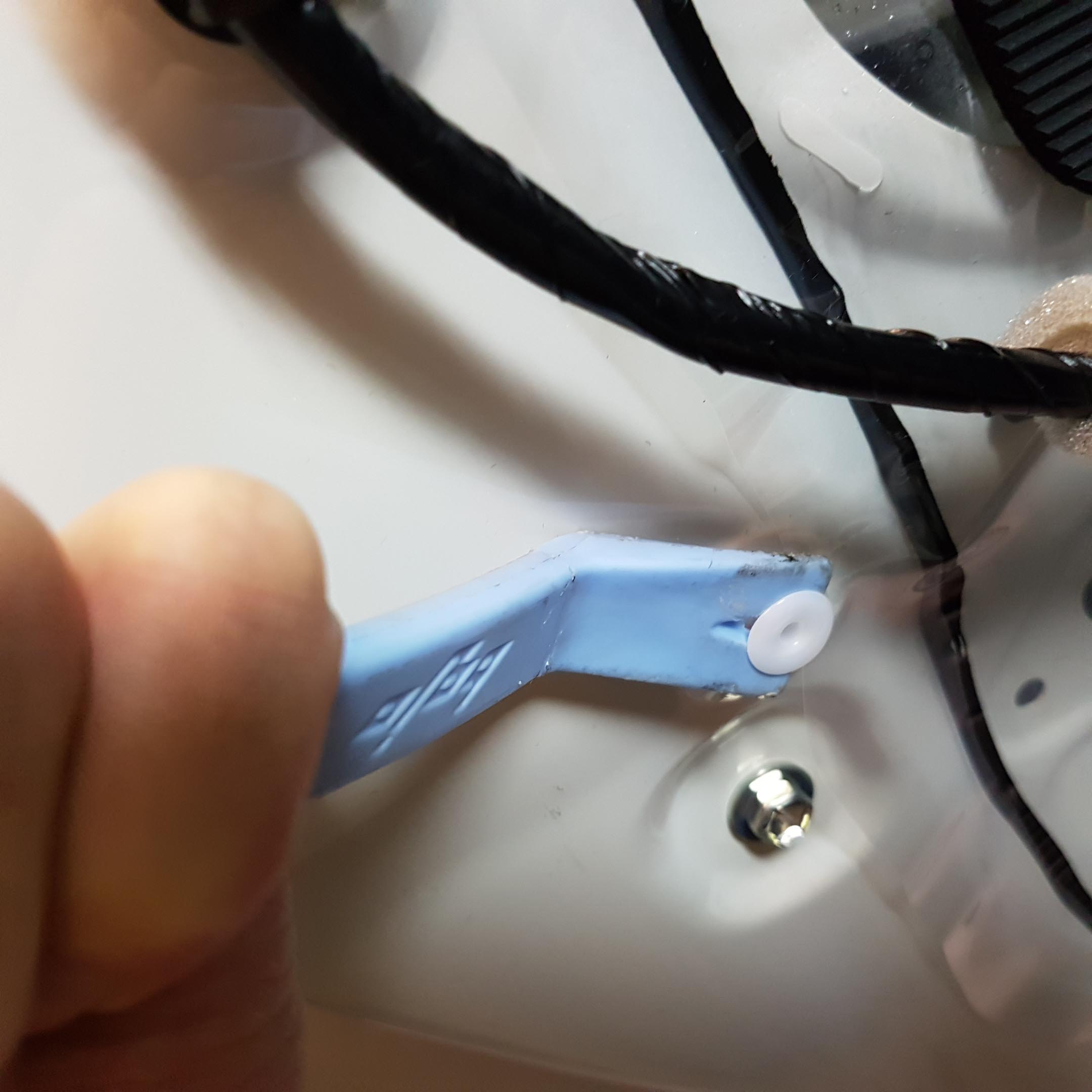

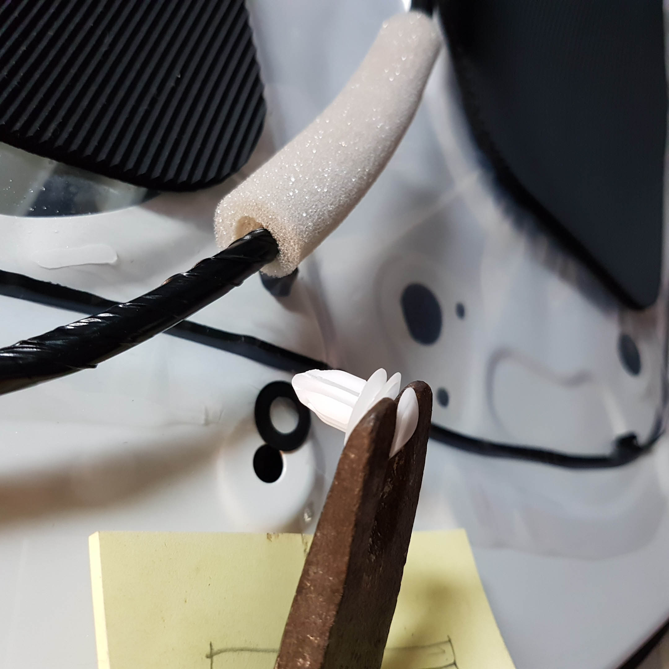

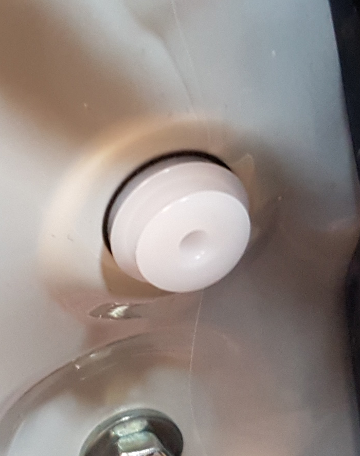

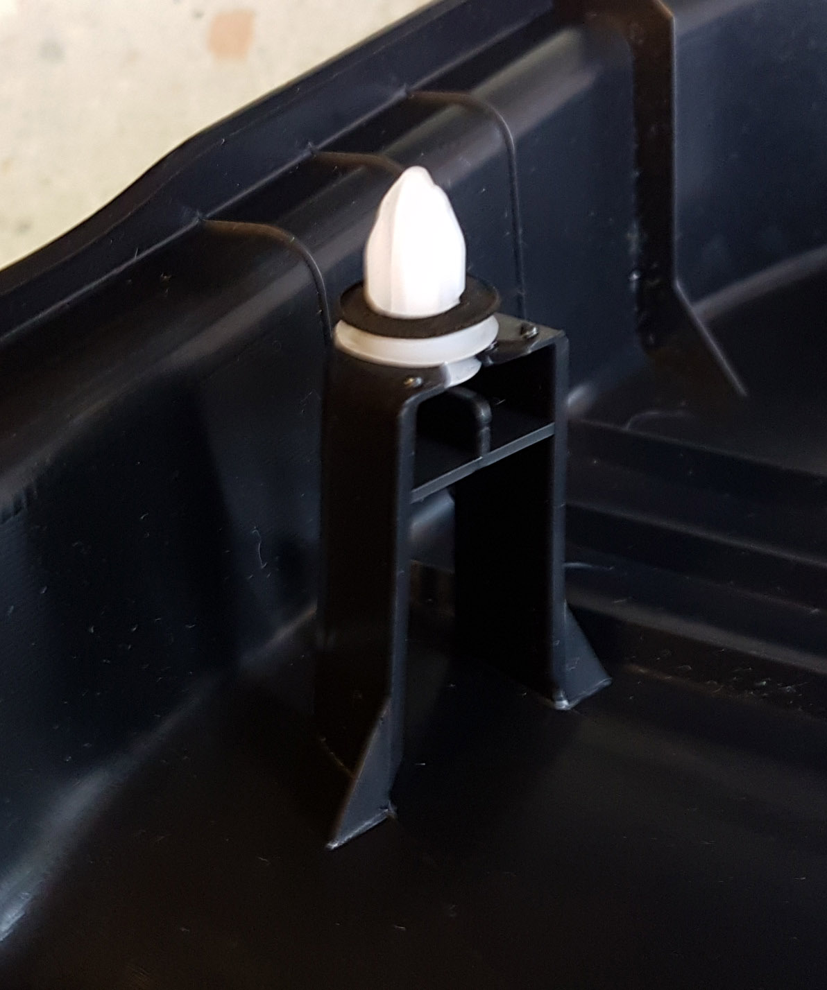

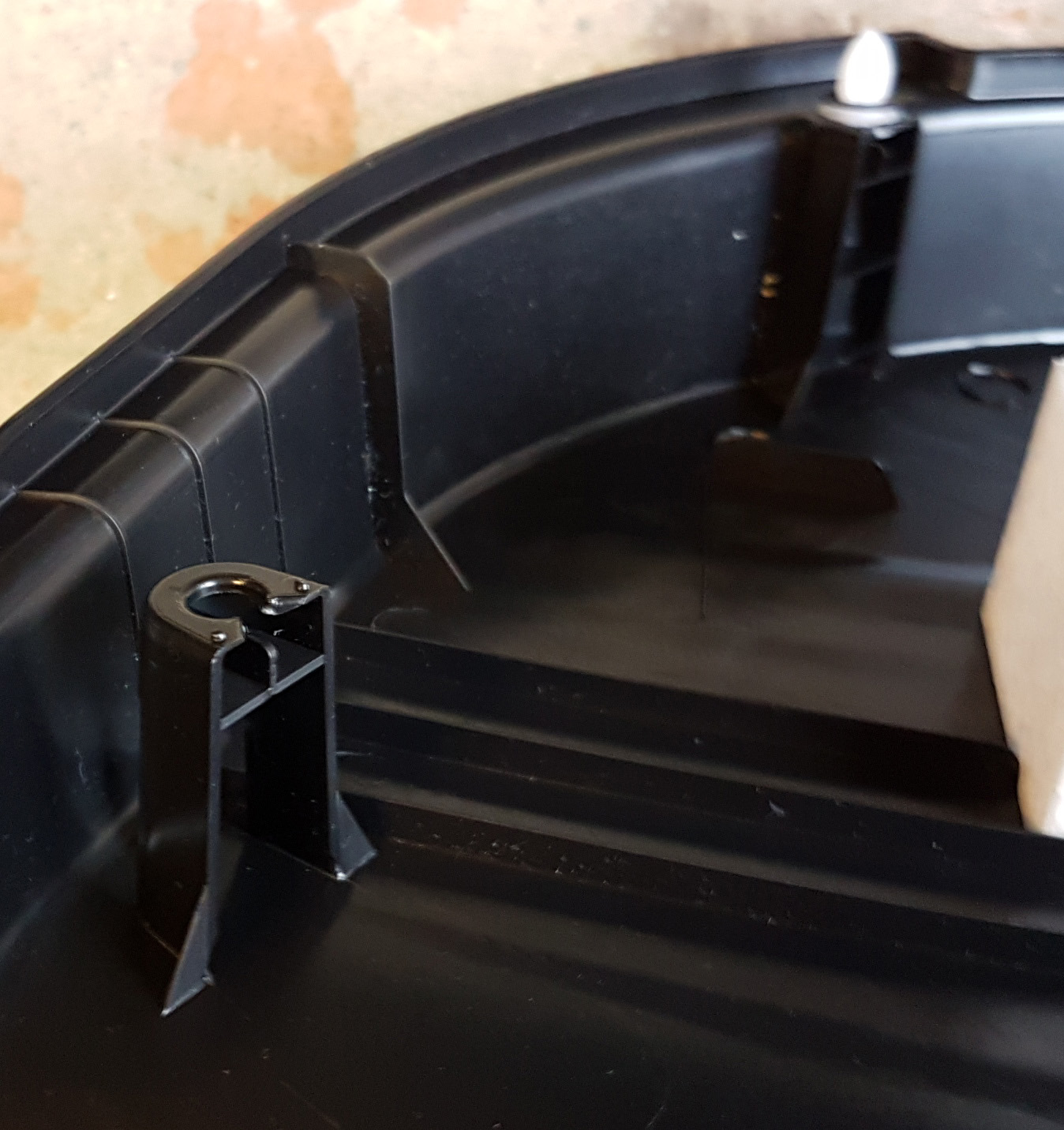

4, some of the white door card clips did not release with the door card, but stayed in the door. so it was nessesary to remove them from the door and re-fitt them to the door card prior to re-fitting the door card.
5, A standard trim removal tool was unable to rebove the more stubben clips,
6, a heavier tool got them out easily,
7, pic of door card where clip detatched and 8, the removed clip re-inserted in advance of re-fitting the door card,

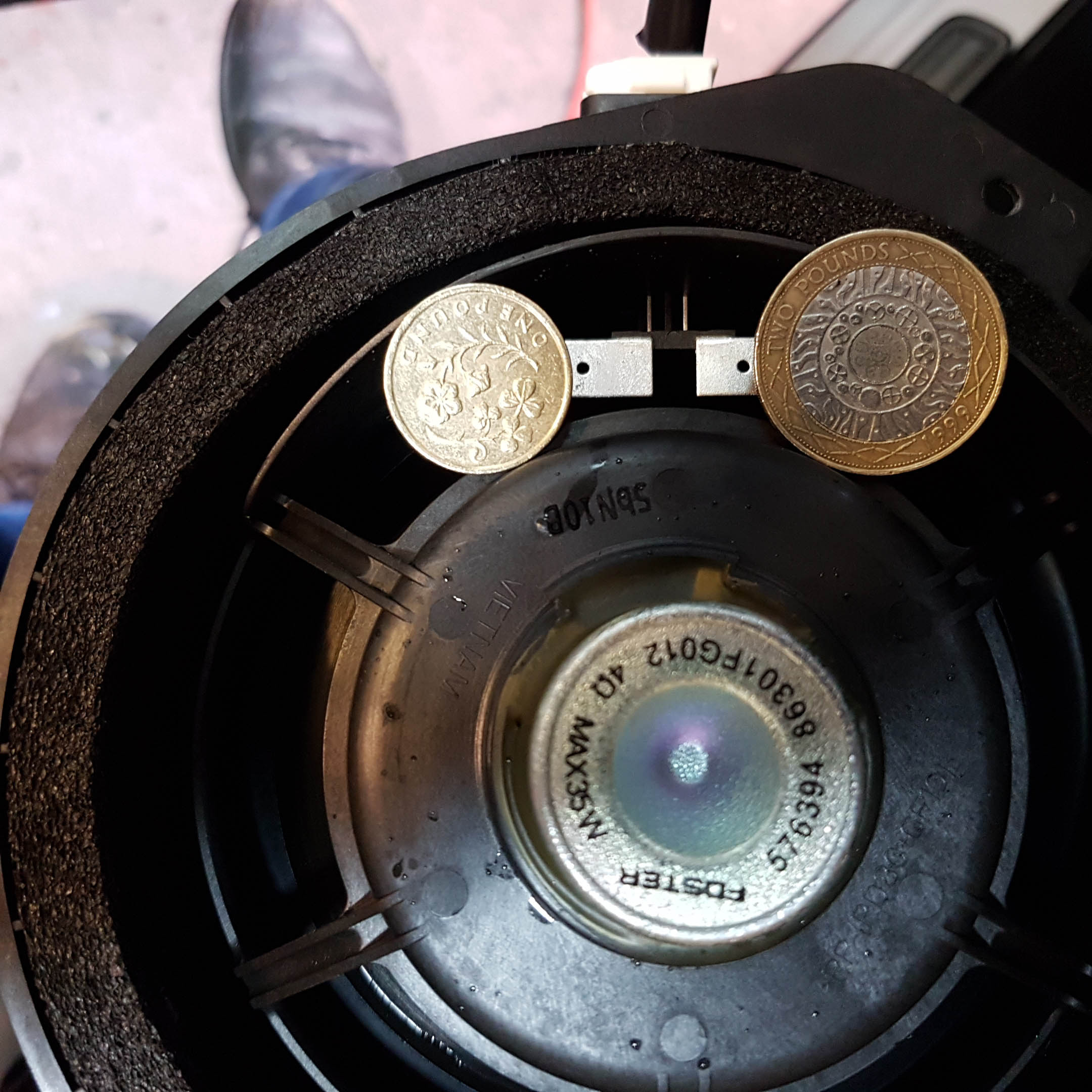

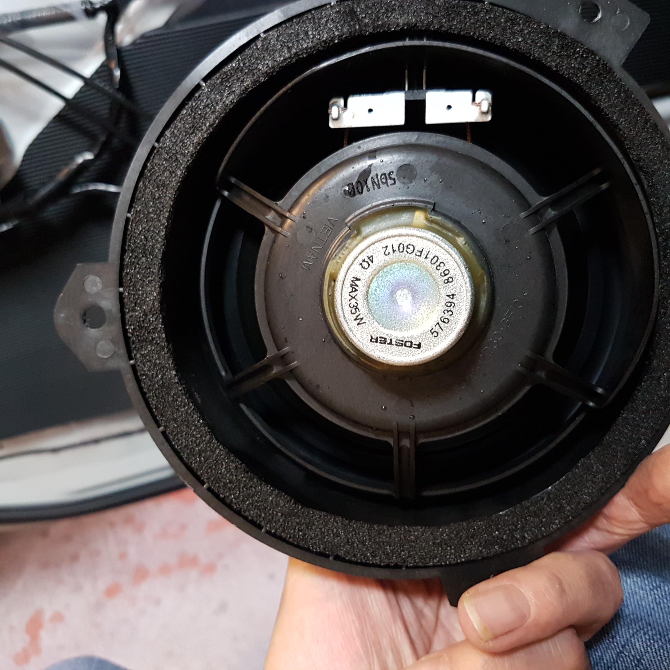

9, the speaker removed had the feel of 'Much Cheapness'
10, from the back you can see it's structure is all plastic apart from the minuscule magnet,
11, I took a photo with a two pound coin, and a one pound coin to to give scale to the tiny proportions of the magnets that drive the speakers. If you look more closely you will see they are rated for a whopping 35 Watts... Awesome-Not!

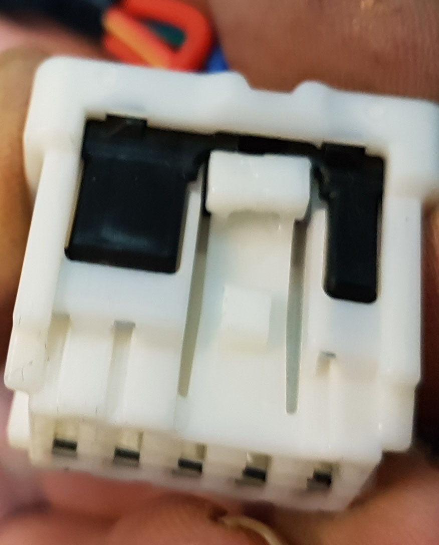

12, there is a special connector for the speaker

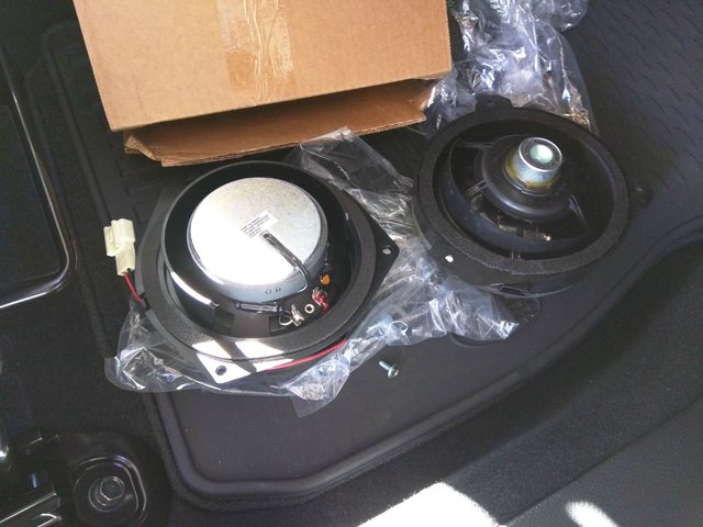

I have ordered this kit which is made as a direct fit and is offered as an OEM upgrade in USA by Subaru dealers
OEM Speaker Upgrade Kit by Kicker for SUBARU Impreza & XV Crosstrek - H631SFJ001
You can see from the pic that they have decent magnets and I believe are a good solution as although expensive at just over 200 quid del, have the correct connectors and are a direct replacement for the original speakers. You can see they have slightly larger magnets also.
