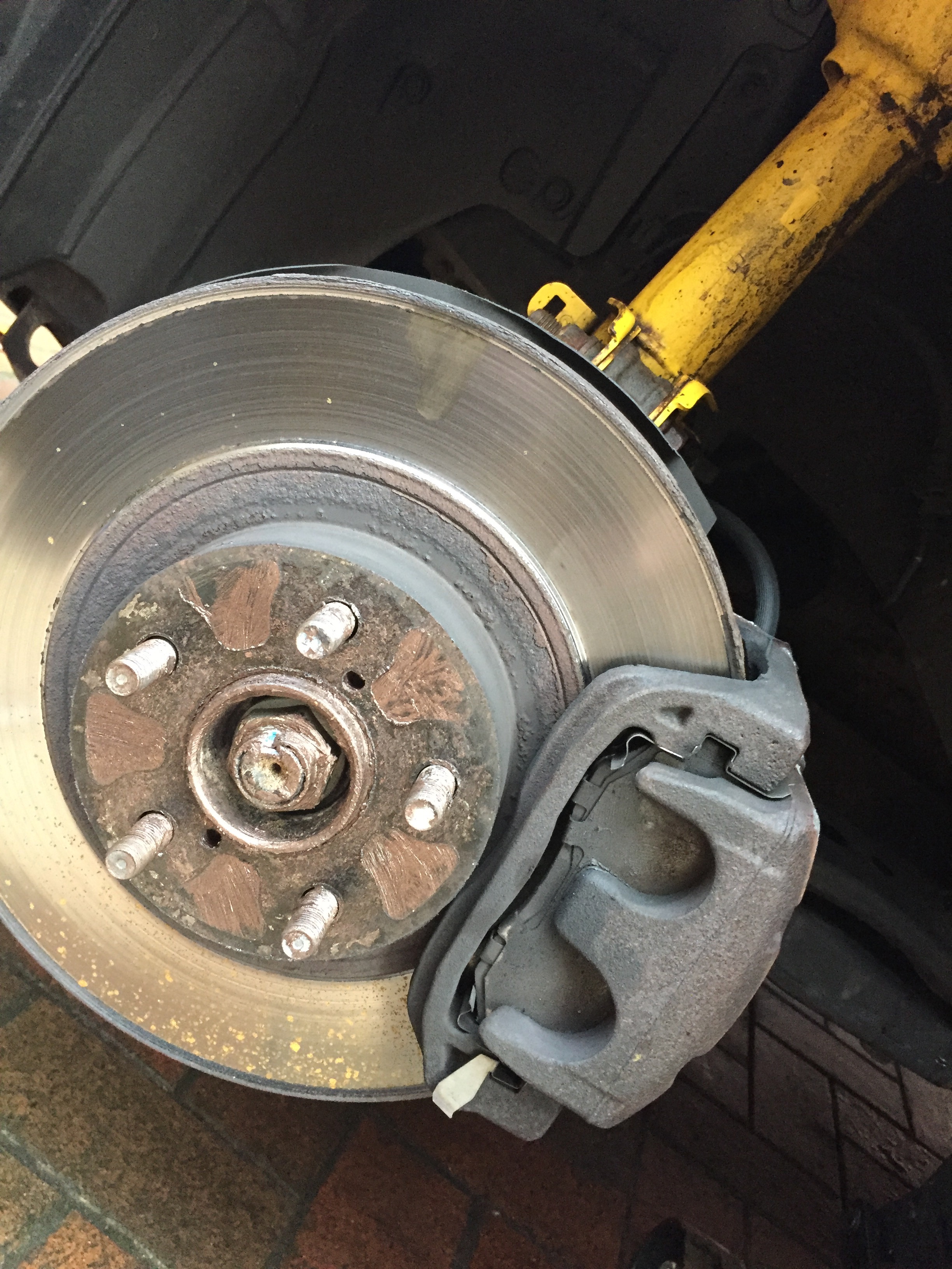

We may have a spacesaver that is 17" x 100 .  But can you tell me have you got Brembo brakes , or standard sliders. as the offsets are different..

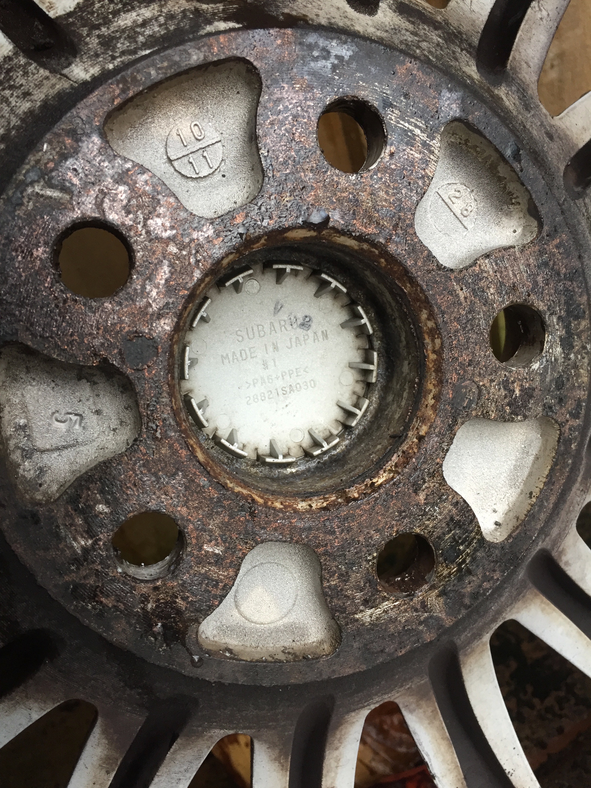

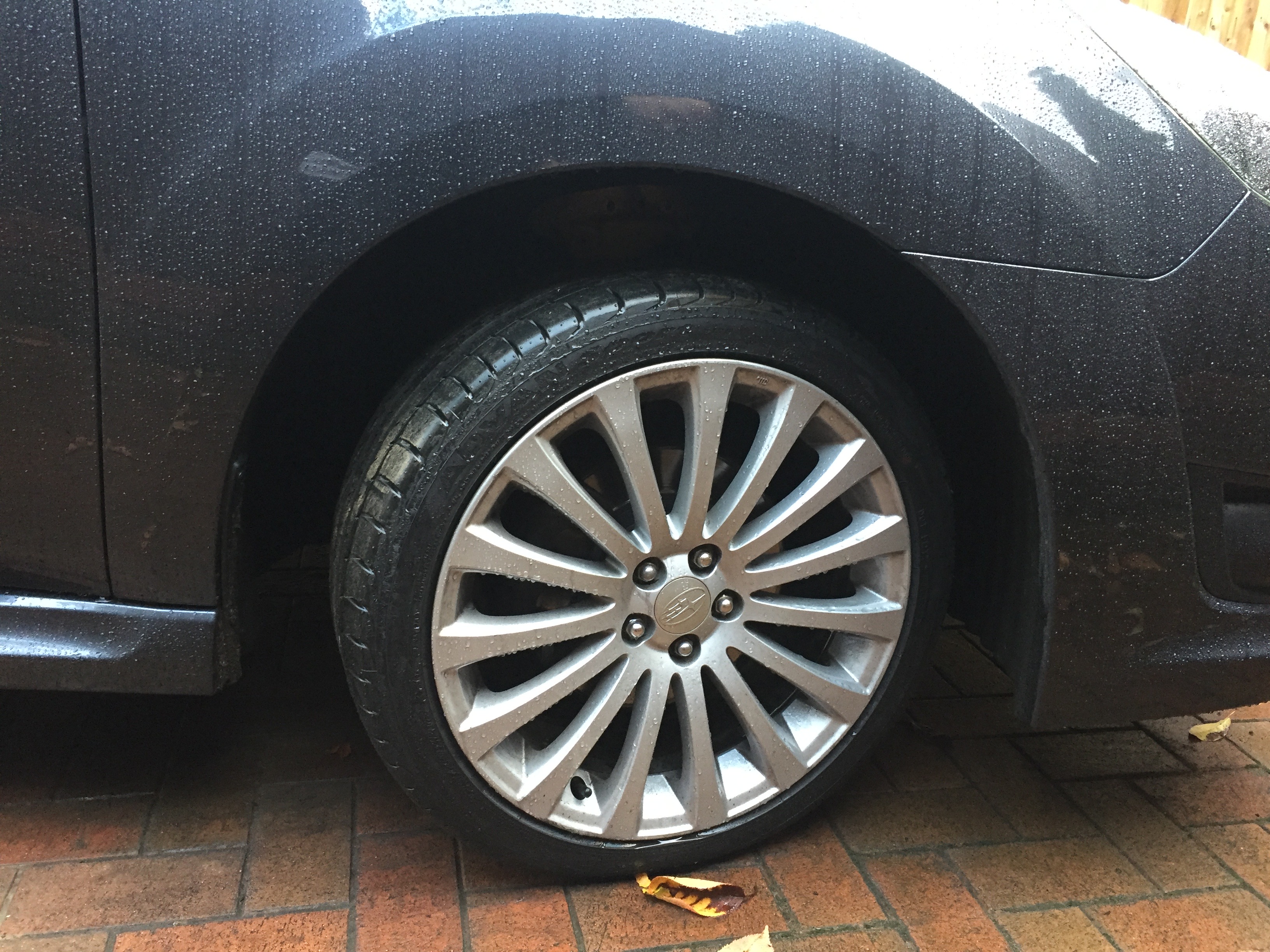

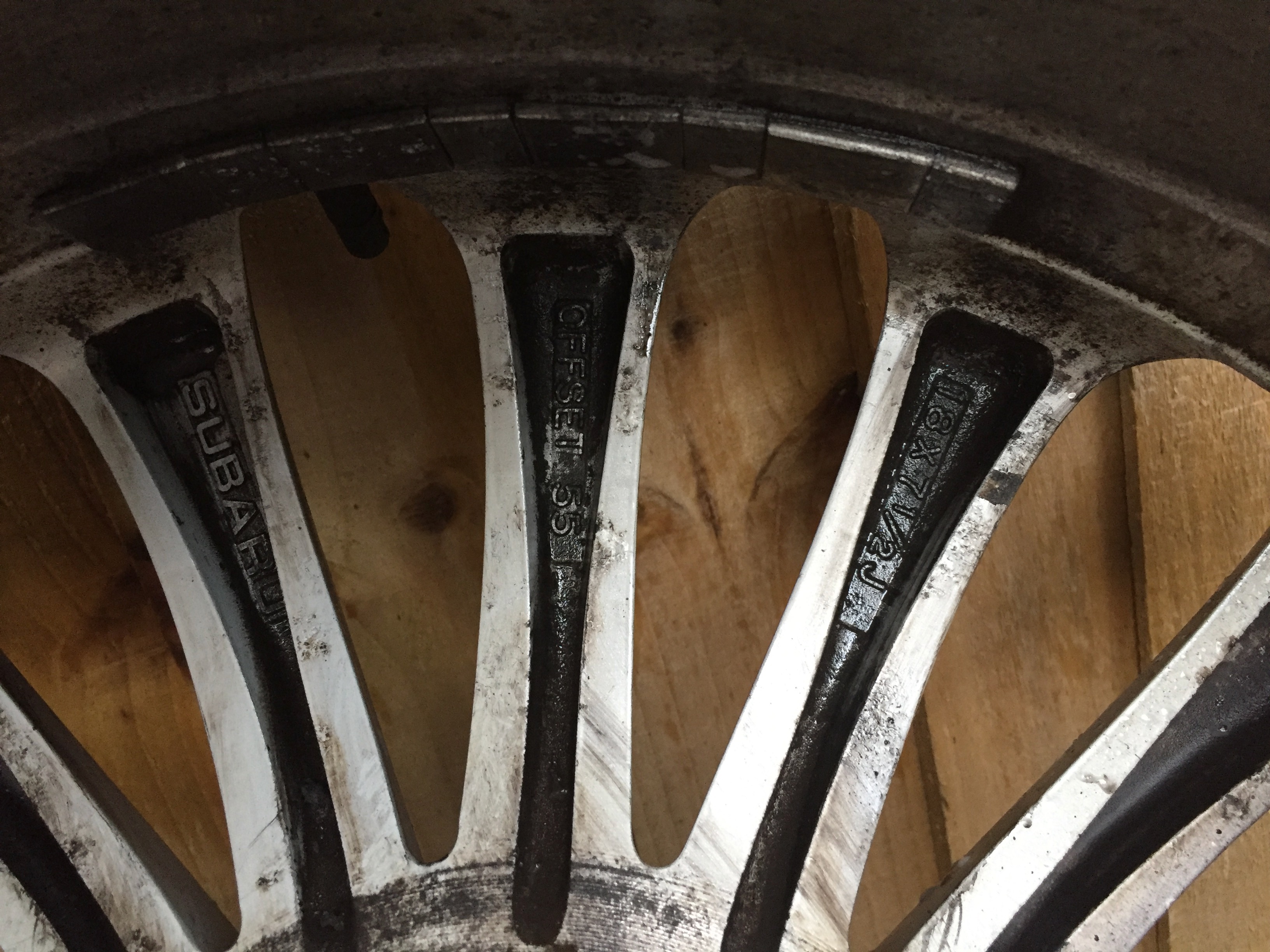

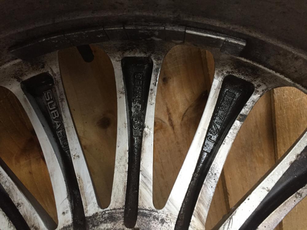

Thanks for the reply, have attached some photos.
The wheels are standard Subaru as fitted to the 2.0 Legacy SE
18 x 71/2 J
Offset 55
Hopefully the pics will help identify the calipers, it doesn't say Brembo on them, so I guess that means they aren't.
