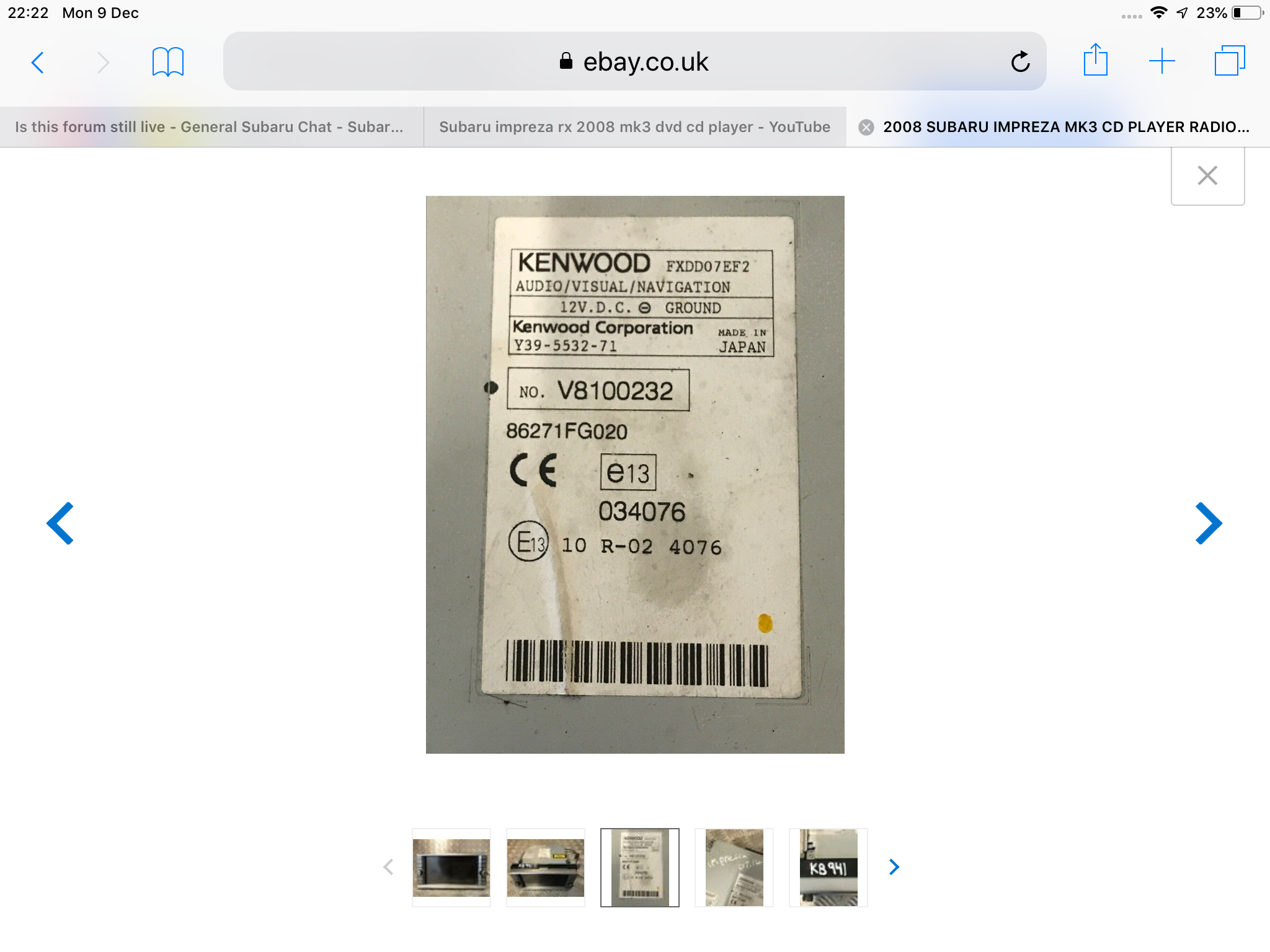

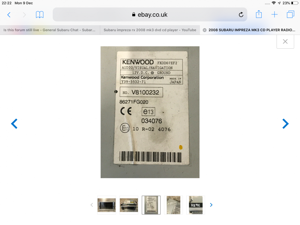

Help CD DVD instructions drop sat nav
Robert McGowan
This is what I have
To eject the cd/dvd you hold down the tilt buttom while it opens and continue to hold it for a few seconds to eject
To eject the MAP DVD - while the screen is tilted (horizontal) press the top right of the screen for 5 seconds.
You will need to insert disc 1 of the Nav DVD's before trying to add any of the update DVD's
