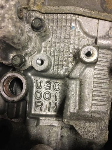

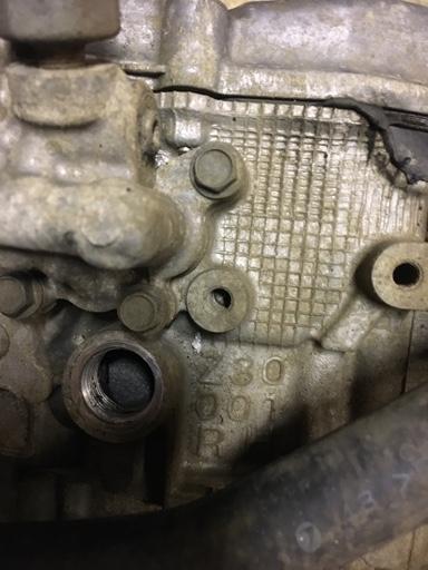

Sadly I had a fairly catastrophic engine failure in my 2005 3.0 spec B last month.
I have bought a replacement engine which came from a 2008 Spec B which seems identical except is from an automatic.
Both engines are EZ30"R"s. i.e. plastic inlet manifolds etc.
I am just a bit bothered that the original heads are marked Z30 (e.g. Z30 001 RH) whereas the newer heads are marked U30.
Can't find anything listing these codes or suggesting what they mean.
Does anyone know if there is any significance to those codes, are is just a date indicator?
Thanks

Hey mate, I only just came across this post. But the Z30 heads are 04-06, U30 is 07-09. Z30 has slightly smaller lift & duration on the intake cams, but slightly larger lift and duration on the exhaust cams. Completely interchangeable heads, and the cams can be swapped between the two without modification also
