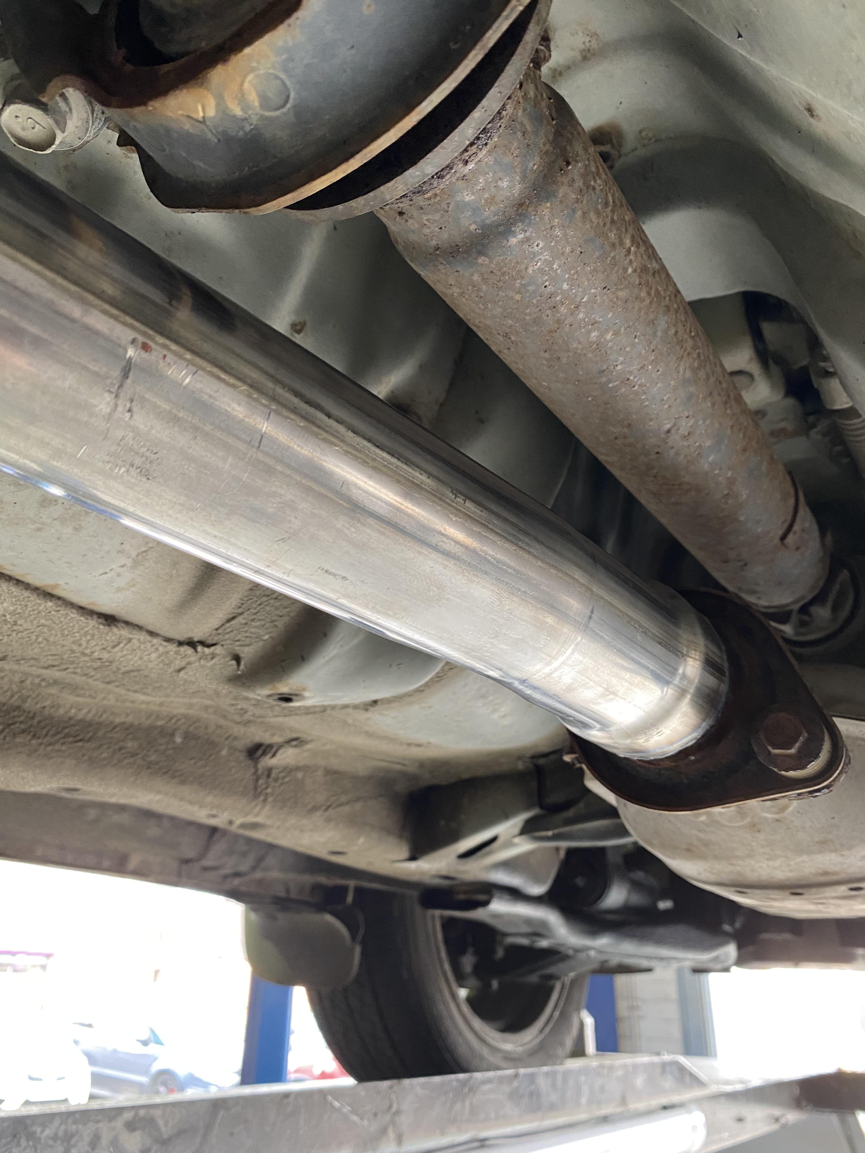

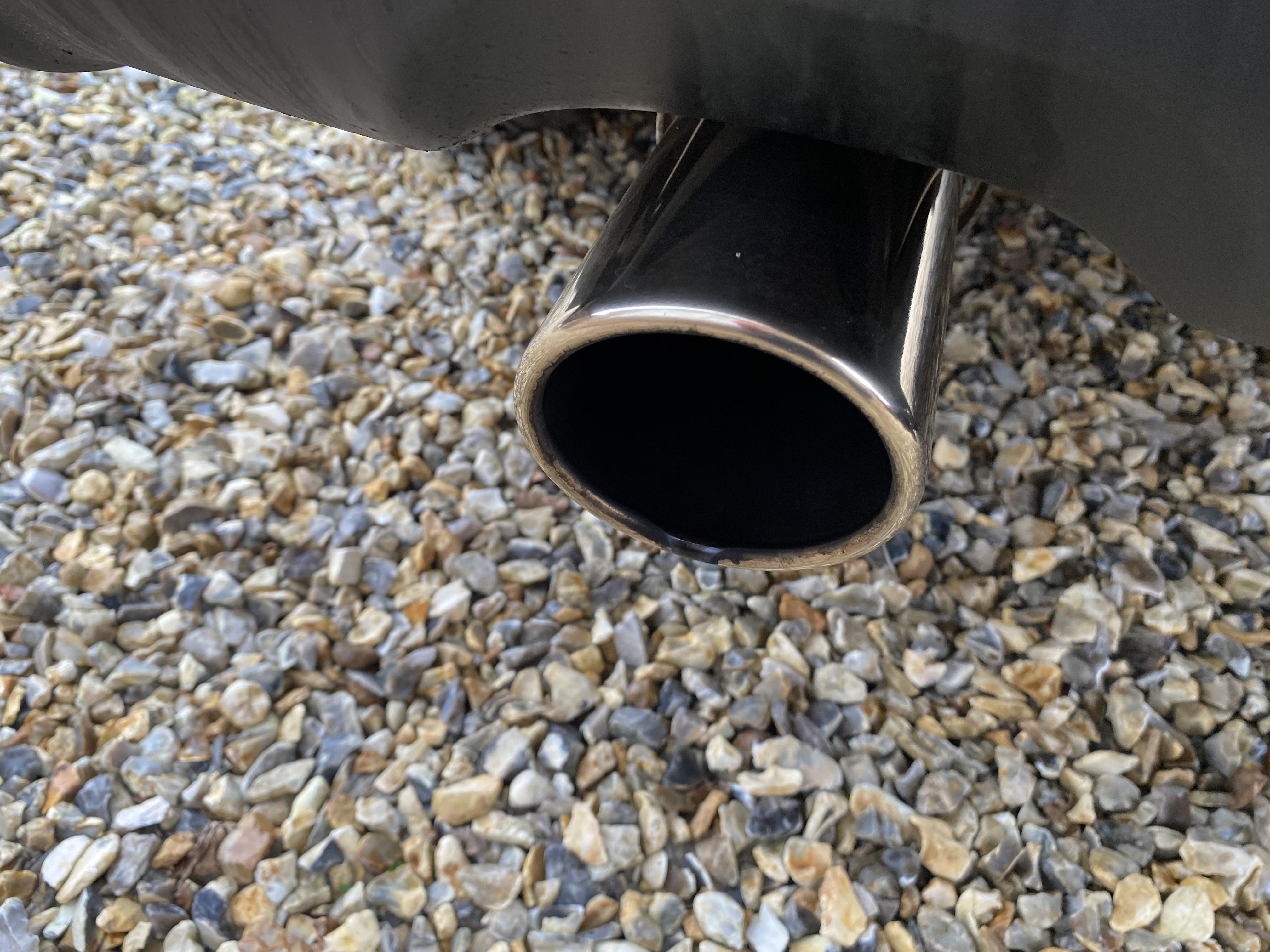

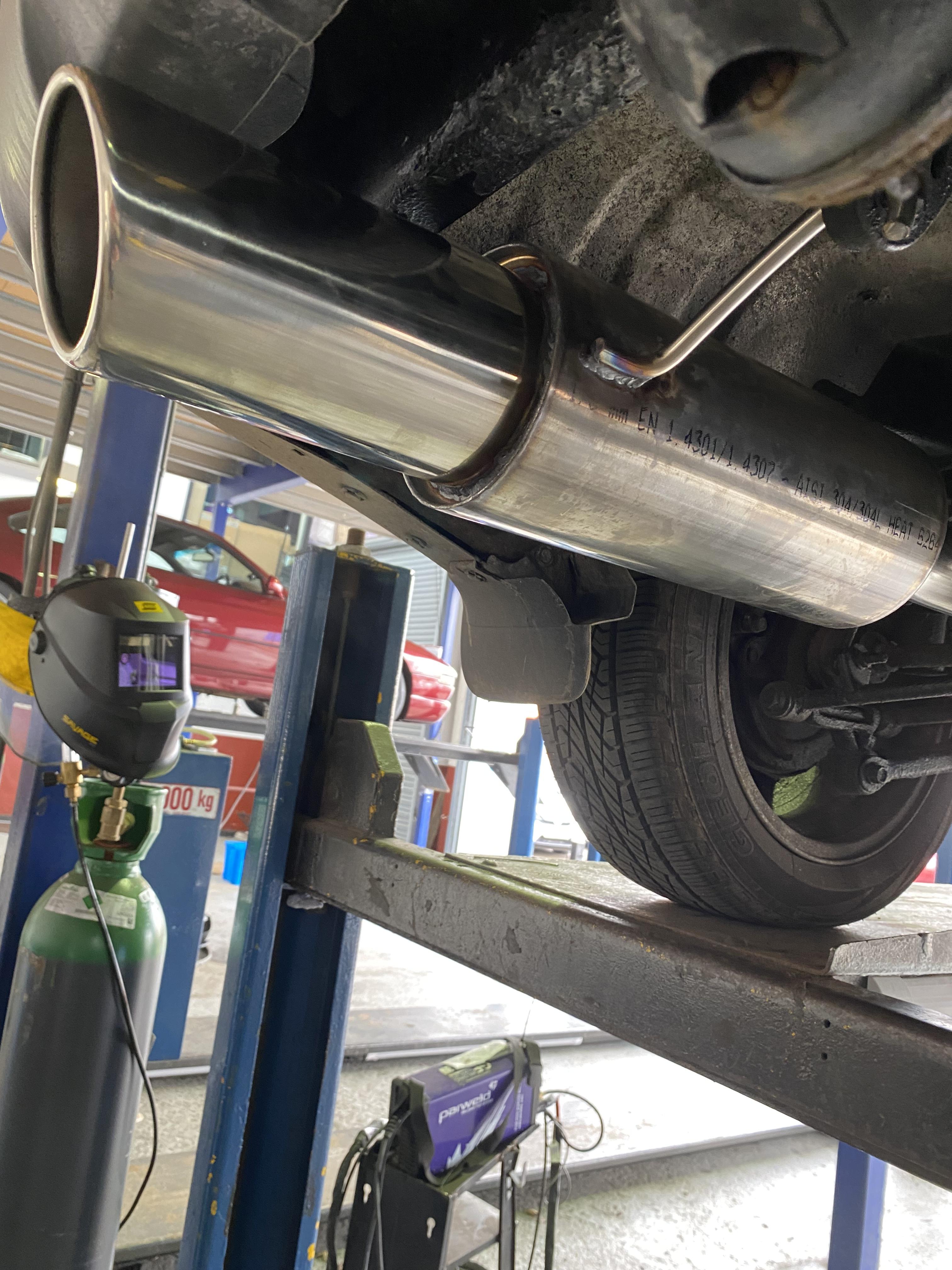

Be aware, if and when the exhaust needs replacing do not think that you can get the right aftermarket jobbie supplied anywhere, you can't, and i nearly dropped a clanger over this, but thanks to Mr B a regular poster here who warned me at the last moment and i avoided that mistake.  The standard system on our cars is 2.5", the aftermarket replacements they try and sell you wrongly are the 2" system meant for the 2.0 litre NA model, instead i had a stainless system made and fitted at MIJ Walsall while i waited for just under £300 (plus a drink for the lads) which was £50 cheaper than the mild steel wrong system was going to cost anyway.  If you have a poke nose on this forum you'll find a thread from me and some pics of the fitted system.
