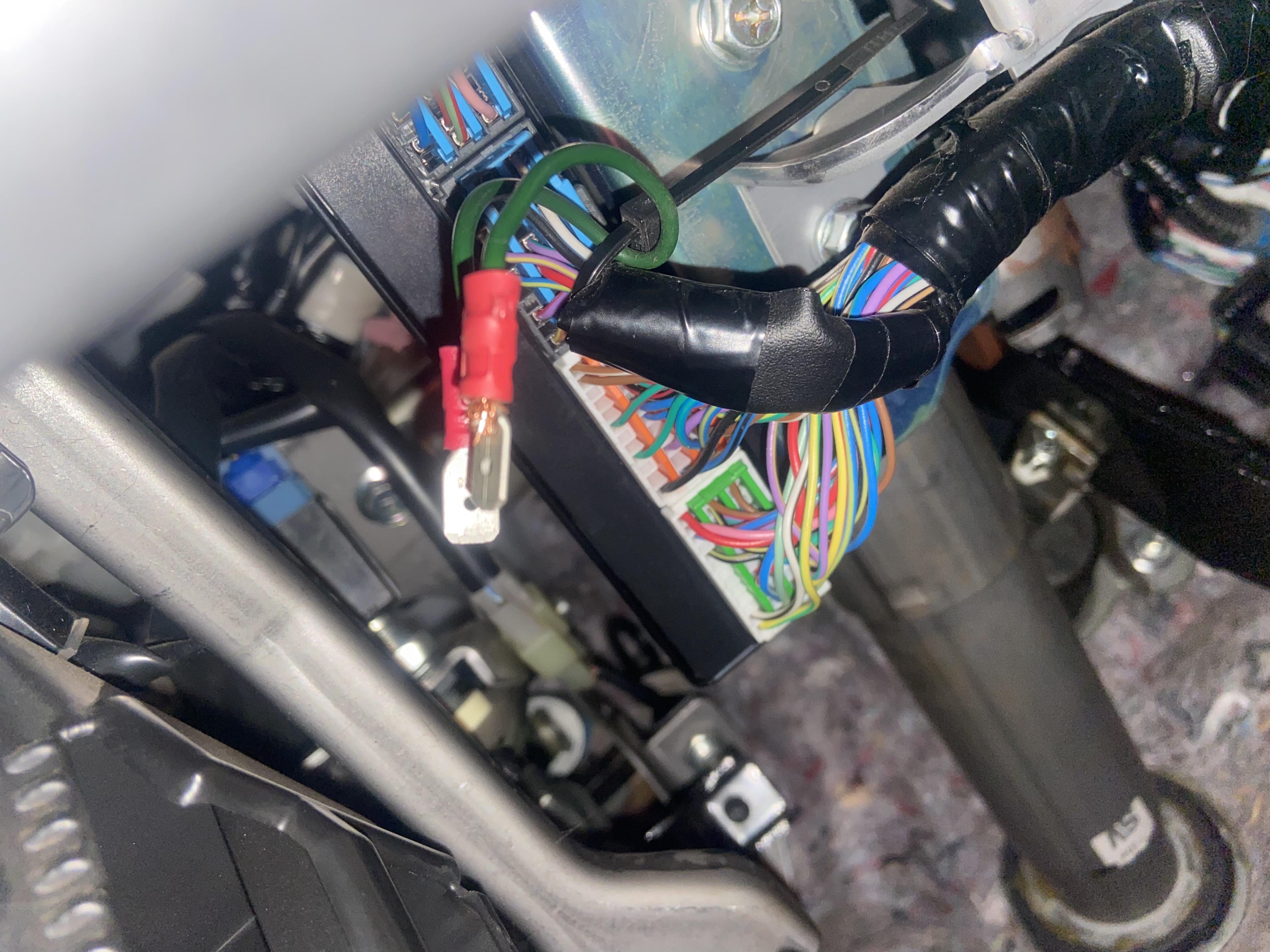

bought it as a non runner
turns out when it had a new clutch they didn’t plug the clutch switch back in to the oem plug… they made a double ended wire with a terminal at each end and stuck that inside one end of the plug instead… disconnected that bodged wire and plugged each end of the clutch switch plug back into each other and boom everything works as it should runs spot on…
