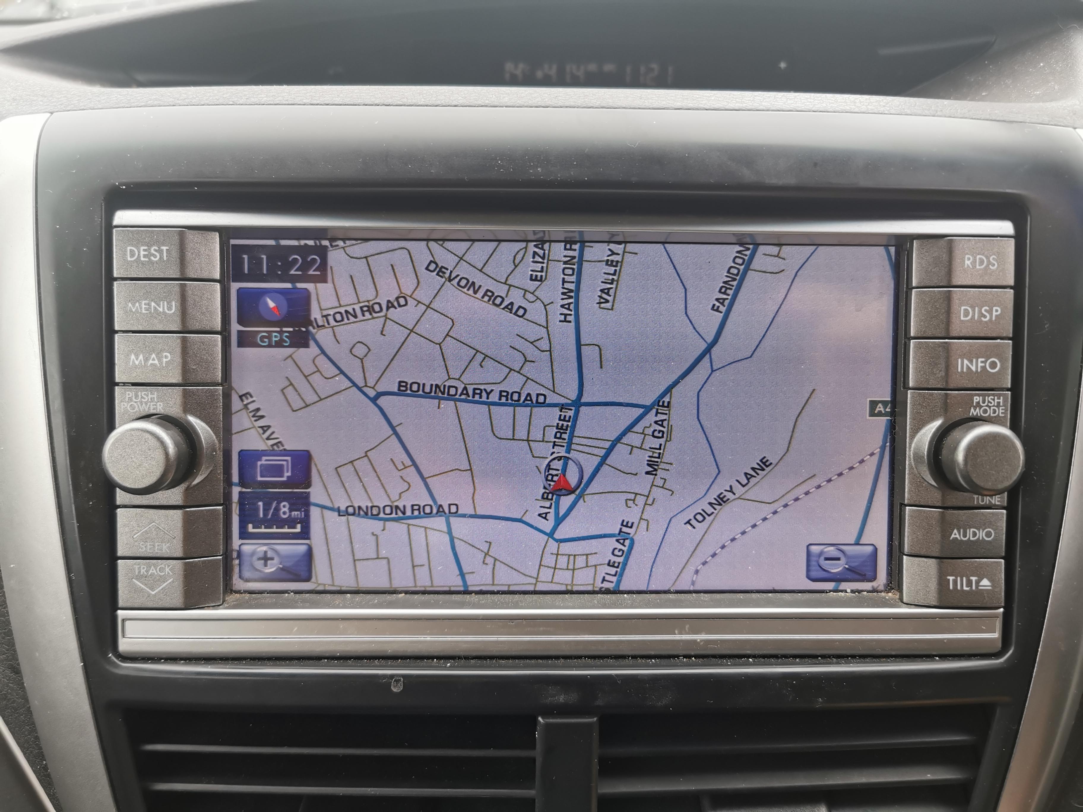

The sat nav will not recognise uk postcodes so I assume the dvd needs updating, only problem is that the screen will not tilt to give access to the discs! 🤦🏻‍♂️

What head unit do you have - can you post a photo as I may be able to help with that

Ok apologies for the delayed reponse,
Here are some instructions which may work
Try pressing the top right hand corner of the screen for 5 plus seconds, that should kick in the eject process for the dvd and tilt the screen in the process.
Also this may be useful
Hidden menu:
1. Turn key to on position
2. Press "Agree"
3. Press the "Audio" button
4. Press the volume knob (right side - Audio off)
5. The screen should be blank apart from "Audio off" at the top
6. Tap the left side of the screen, then tap the right. Repeat 6 times
The hidden menu should now show up
