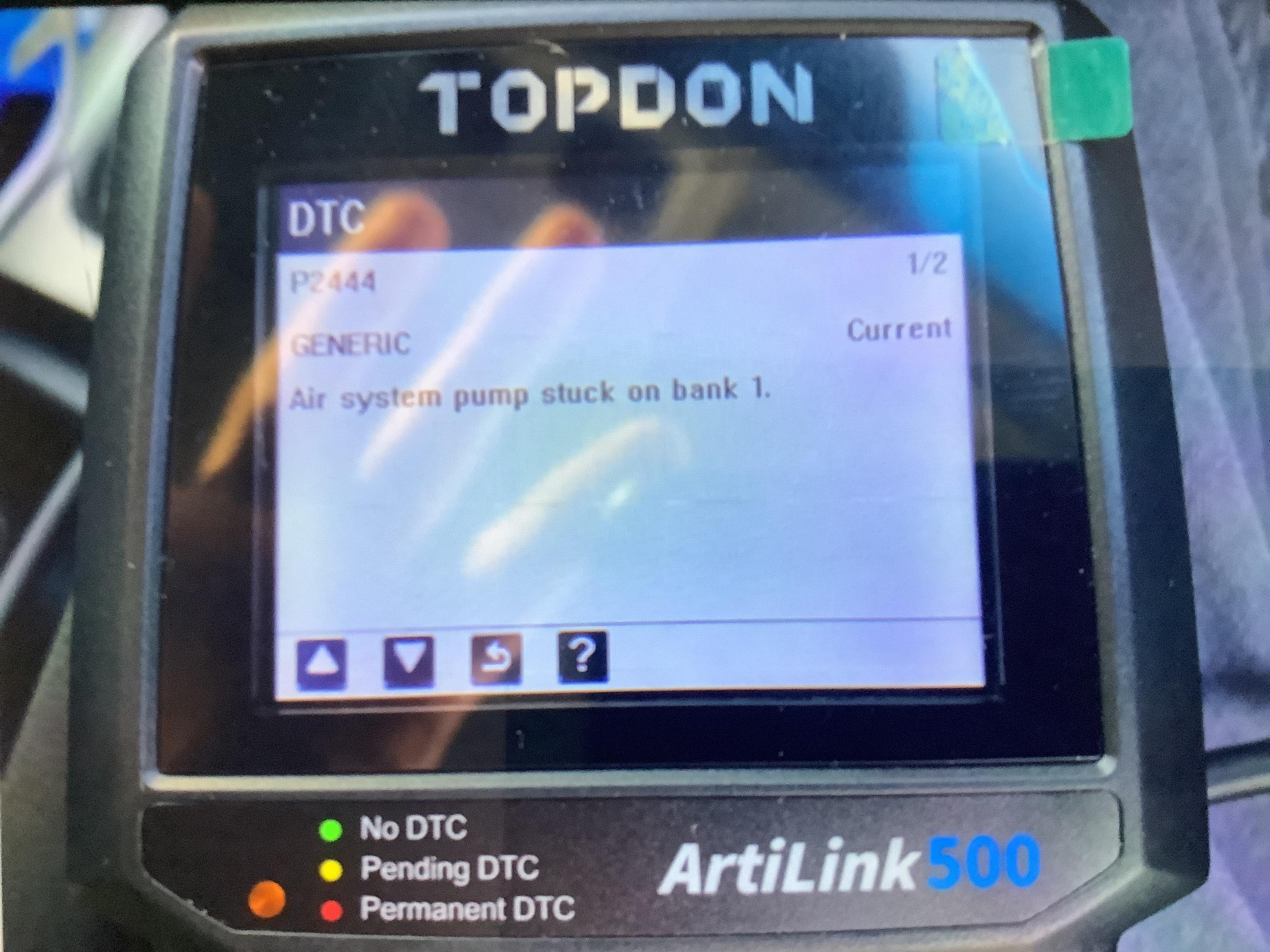

I have an Engine warning light on my 2011 Forester (2.0 Petrol 150kW). The OBD2 is states: P2444 “Air System Pump Stuck on Bank 1”
Some research suggests that the fault is with a “Secondary air system pump”
