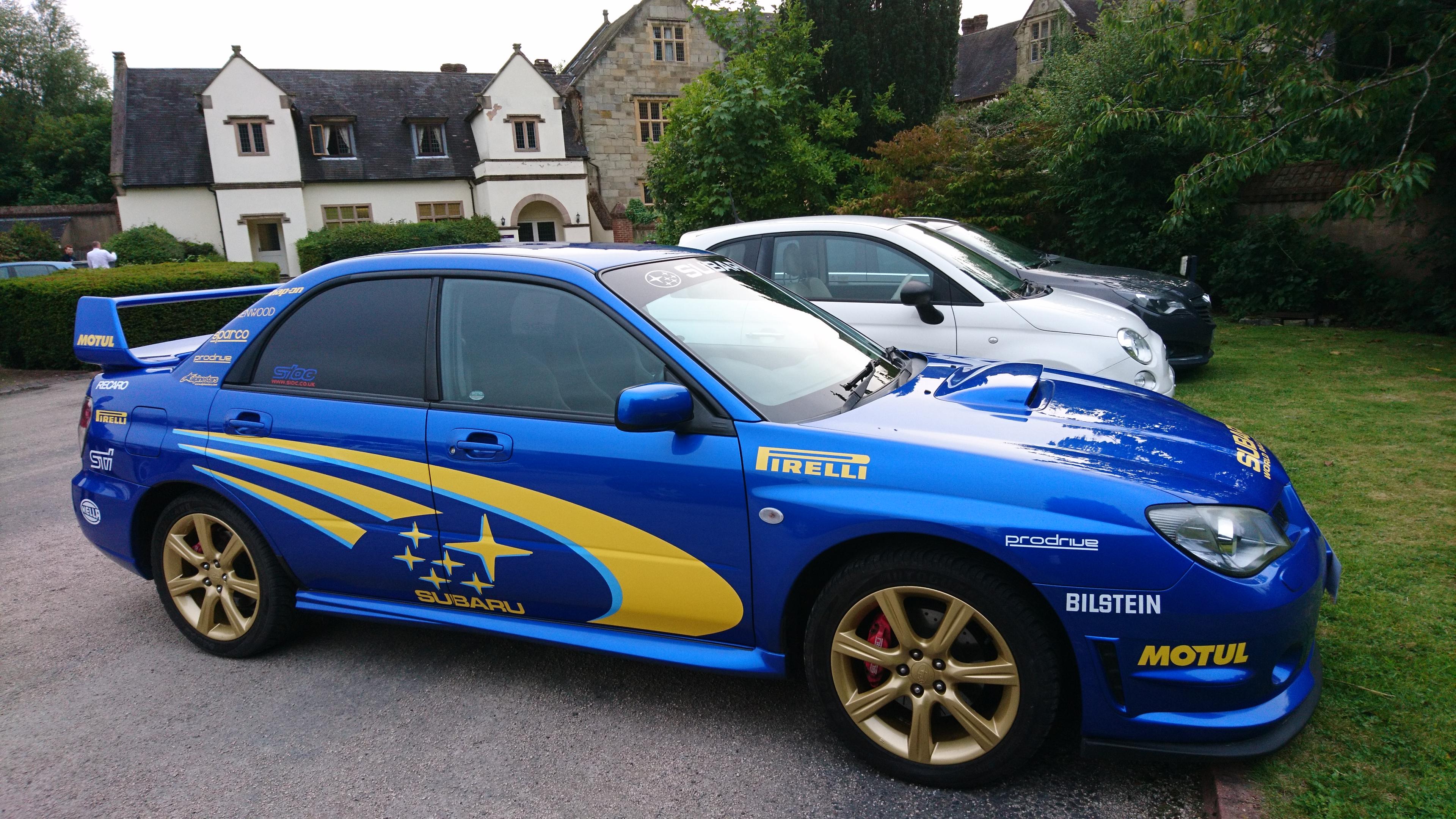

I have a Impreza 2.5 WRX 2006 model which I need help / advice with. I’m afraid this might be a long post but wanted to provide ALL details. The car was driving absolutely fine but a “whistle” had started from the turbo when the car was cold. It sounded a little bit like a siren (not mega loud though) but it would stop when the car was warm. I took the car to the garage for the turbo to be checked & this is where it all goes horribly wrong!! The turbo was sent off to a specialist to be refurbished but when they investigated why it had failed, they diagnosed oil starvation. This led to my mechanic having a second look & he confirmed there was a blockage “somewhere” so the oil wasn’t getting to the turbo but it was also low in oil so suggested that it could have been burning oil. The oil was drained & evidence of copper filings were found.
My mechanic (who has rebuilt Subaru engines multiple times) has said that he thinks the ringlands are failing therefore it needs a full engine rebuild. This may include boring of the head & having bigger pistons fitted depending on what damage is found. The price quoted is unfortunately pretty high & not sure if it’s worth completing on an 18-year-old car! Now I don’t claim to be a mechanic or particularly knowledgeable about the inside of engines but I’m finding it hard to comprehend that the car drove absolutely fine but within a few days it seems all is lost! The car is a dream for me & I’m loathed to sell but also struggling to justify the bill quoted.

Short version, yep, will need a full rebuild.
Copper fillings in the oil very highly likley means the crank bearings are damaged (could have ring land issues, but untill its stripped you wont know. although ring land failure is common so would be no surprise)
As far as what you do its up to you really, a proper reabuild wont be cheap if done properly, If the shell is solid and you plan on keeping the car long term may be worth the cost. Rolling shell of a wrx isnt worth much, maybe 1-2k at best, it's doubtful the cost of a rebuild will increase the value of the car to make it cost effective to rebuild then sell.
